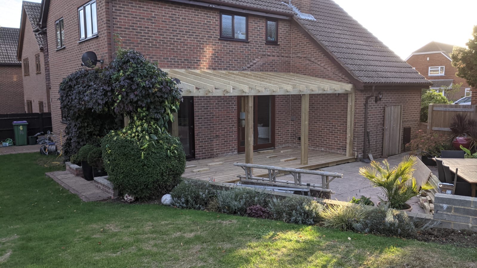

I'm installing 27x144mm Canterbury Softwood decking on Monday, I might be overthinking this so please here me out.
The spacing recommended is 5mm, but the decking is stored outside at the timber merchants and as such has expanded to 147mm due the inclement weather.
Yesterday I cut and laid all of the boards ready for fitting, some were drier than others so I'm trying to get the moisture content more even.
Being that the decking has expanded by 3mm per board should I reduce the gapping to say 3 or 4mm, my concern is that when the boards dry out I could end up with large unsightly gapping??
Thank you
I'm not sure where I could dry 200 meters of decking, in the Autumn in the UK, mattylad?
Think I'll go with 3mm spacing, Thank you.

If the nominal size is 144 and the gap to be 5mm, then you would lay the boards at 149mm edge to edge regardless of whether the board is wet or dry and they will then acclimatise to regular gaps.

Cheers Woody, yeh that took a while to sink in, or put it another way, 149mm centers regardless?
you could try alternating planks so a well swollen with less swollen at 3mm gaps but be prepared for gaps to settle at perhaps between say 4 and 10mm and iff you can accept that the go ahead if not you have to cover and air dry with sticks to allow air flow
Air drying would be my preferred option, the customer is very exacting and this concerns me with the condition of this product, but I am against the wall, booked solid until beyond Christmas. I am going to lay it leave the screw heads just under the surface and await next year's heatwave and see what happens, hopefully the phone wont ring.

I like a jig makes life simpler but as you say I can't think of one I can make for this scenario. Yesterday was bright sunshine and warm all day here in Kent on arriving at the job this morning the boards on measuring were mostly 145 - 146mm.
I have decided to work off of 294 overall, 2x144 + 5, yes it's 293 but 294 is fine, I'm measuring every board, it's going to ages, but ultimately it's my reputation and I'm also anal. Thank you for your help squire.
