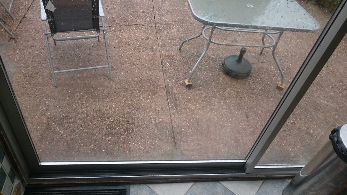

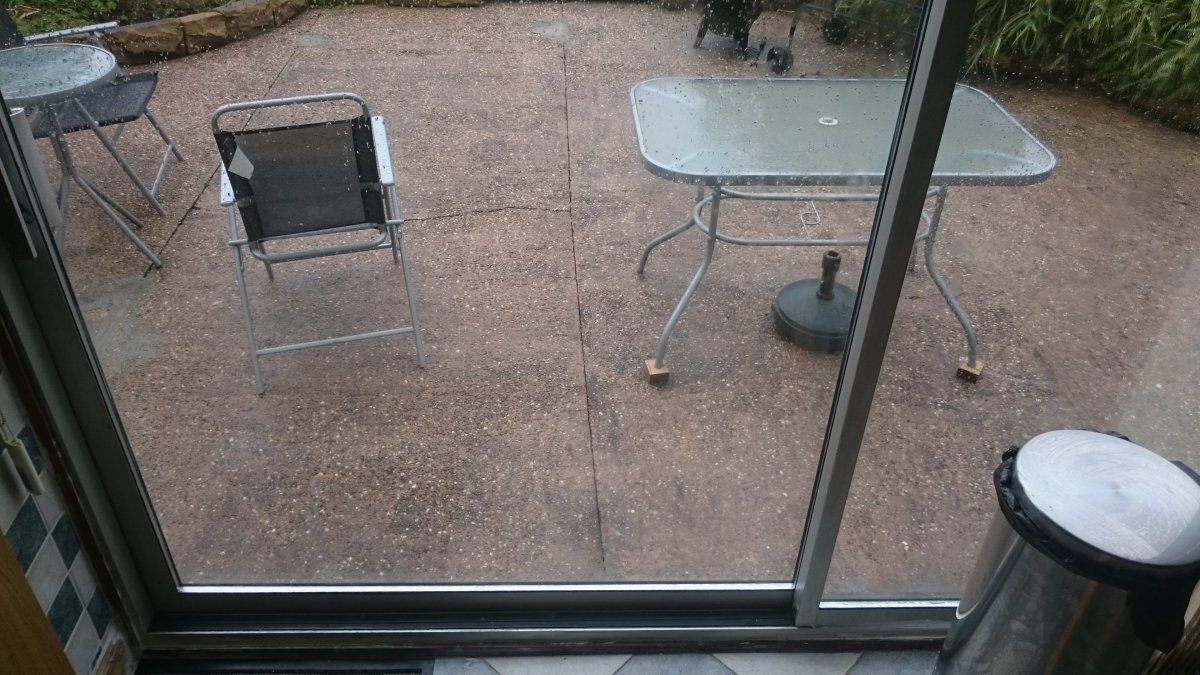

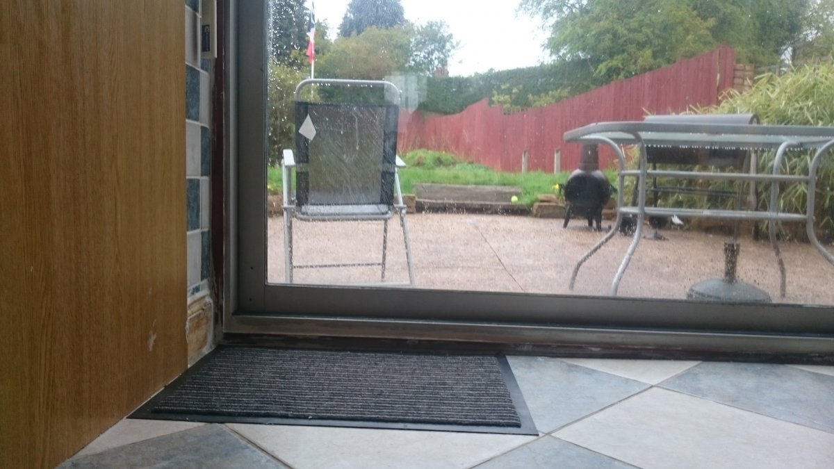

hey there.
ive decided i want a little bit of decking outside from the kitchen
at the moment, from the kitchen to the garden thers about 8" drop, the concrete is a upwards slope from there so after 4-5 foot away from the kitchen, your at the same level as the kichen floor would be.
i want the decking to be higher up so its almost walking out to the decking same level (of course, i need about a inch from the wall gap)
so im wondering the best way to put a level decking
decking size i want to be is around 3mtr out of the house and 4.5 accross
am i right in thinking the best way would be is to make concrete domes, as posts with wood posts going up, which after set, id cut to level for the deck joists to go on.
3 (mtr apart) going out the house
3 or 4 going side to side
3x3 ish 9-12 posts
level my posts so the top of the wooden posts are the same spirit level
joists on them, frame, deck. finishing touches.
is this the best way?
or are there better ways?
afterwards im going to have gravel around the deck at 180 degree around it, all level to the deck so you can walk from kitchen to decking with only slight dip (not existsing 8") then onto gravel from deck (again slight dip)
be nice wouldnt it :P
thanks alot for any help!
i will try to add some photoes
I think it is preferable to have a slight fall away from the house. This will help rainwater run away.
Additionally, it is very tiresome trying to sweep decking boards across the grooves. Orient them so they grooves run the way you will want to brush or hose it clean.
A few pics if they help
If you look, on the left hand side you can see a crack/join in concrete. This is more or less the edge of the deck will be
Follow that line up there a bit of a cut away in that crack, thats more or less where it would go accross.
Up to where the bbq leg is
Cheers
Cheers for the reply!!
Would it be best then, to build a frame with 3x2 then bruild it up on the one end so itl be more level, yes slightly towards house where the gutter in the concrete runs to the drain.
Atm our sausages roll off our plate. Can you see my hot fix with the 3x2 on the bench. Ahaha!! Genuis no?
See at 4mins 10 ish. Cant i just make the 2 of them near the house longer then the others.
I thinn il have about 3 or 4. Been as my deck would be longer, rectangle not square.
