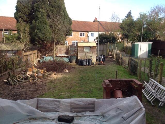

This is my garden, a big mess....where the old shed is there is a concrete base where the deck will be, and on the left will be another shed.
