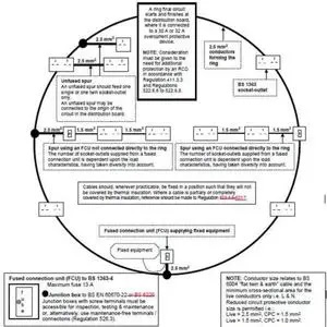

The IET published this, which goes a long way to explaining the ring final.
I must admit I think the idea of not doing some thing because some one in the future may asume and not test seems flawed, the idea of extending a ring final is included in this, however the cheap £50 plug in tester with loop often will not test down to 1.38Ω and testers to measure ohms using 250 mA or loop impedance down to 1.38Ω are expensive. If one is worried about volt drop then even lower.
The figure of 106 meters is quoted for the maximum length of 2.5 mm² ring final, which it seems is calculated considering 20 amp load in centre and 12 amp even spread, however there seems to be nothing in the regulations to say this is how to work it out.
When doing my C&G 2391 we were told to test for figure of eight, but not seen any rule which is broken if we do have a figure of eight, other than
The load current in any part of the circuit should be unlikely to exceed for long periods the current-carrying capacity of the cable (Regulation 433.1.5 refers). This can generally be achieved by:
(i) locating socket-outlets to provide reasonable sharing of the load around the ring
(ii) not supplying immersion heaters, comprehensive electric space heating or loads of a similar profile frog the ring circuit
(iii) connecting cookers, ovens and hobs with a rated power exceeding 2 kW on their own dedicated radial circuit
(iv) taking account of the total floor area being served. (Historically, limit of 100 m² has been adopted.)
