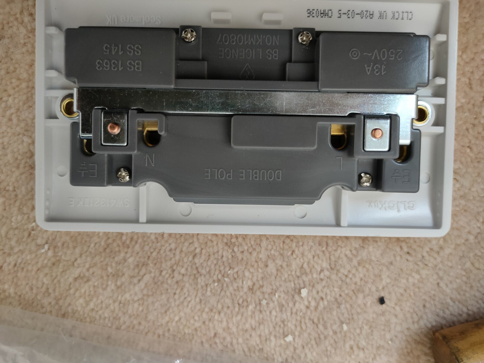

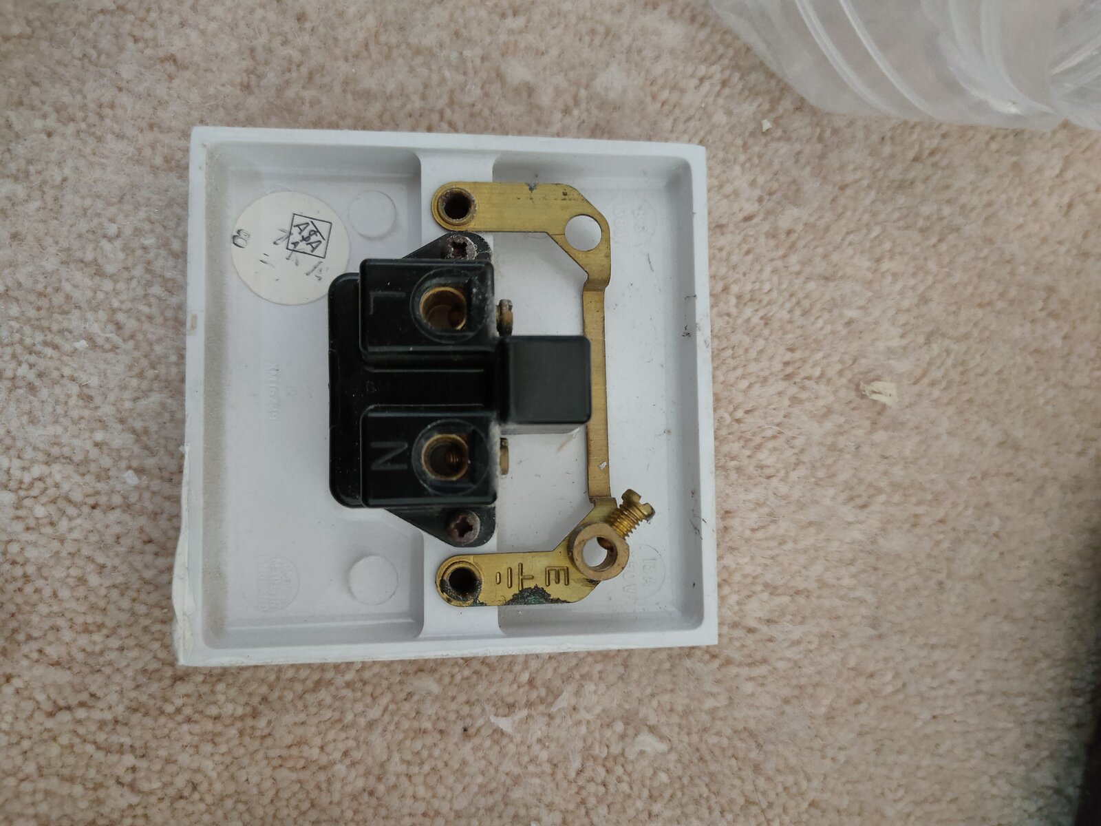

Further to a thread that someone was asking whether to extend the ring or adding a spur on a 70's house and it was mentioned to add a 4mm cable into the back of the sockets.
Today I was converting some single sockets to doubles, one of the switches had a spur done at some point in the past, I believe to the boiler in the garage which is below the bedroom.
Anyway, the old 2.5mm twisted wire was a nightmare to get into the sockets with the spur.
The neutrals for some reason were more difficult on both sockets for some reason.
I couldn't imagine trying to squeeze a 4mm cable in the back aswell.
The old sockets removed were relatively easy to wire in, even with the spur.
I've added a photo of old and new sockets.
If you had enough length you may have found it easier to trim the old bare wire ends off, recut the insulation, and then reconnect both sets.
If the wires (stranded or solid) are actually twisted together, it can help to untwist them, re-strip if necessary, and place in the terminals individually.
All individual, the stranded cable I twisted to make it "thinner" to enable fitment. Was a pain in the bum still though.
New sockets are designed for the solid core and thus the terminals are marginally smaller, but small enough to make a difference.
Point of the post is that when someone suggests putting 4mm cable plus the 2x cables of the ring circuit they just won't fit in a lot of modern sockets.
