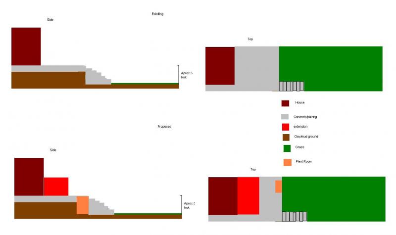

Meanwhile i spoke to my neighbour who as a 2.4m existing extension who mentioned that they had to go down 12 foot (its an old extension) to get solid ground for foundations!
Thinking about it, i can see why it may be required - There is a "solid" patio area directly behind the house - approx 1-1.5m above ground level after the patio. (if you look at this image you get an idea
note that the image was for another thread where i was hoping that the height would be sufficient to put a boiler and tank in the ground!)
This patio, my neighbor informed me was made from back fill as part of the house build... and passing though the back fill, then leaves approx 1.5-2m into the firm ground to hit solid ground for strip foundations...
So digging 3+m for foundations doesn't sound like fun, There are trees - but over 30m away so should not affect this...
Garden wise is effectively from the back of the house 8m of patio at house level, followed by about 8m of grass at approx 1-1.5m lower.
So what are my options? was thinking mini piling but £££, would a slab possibly be suitable?
I was hoping to get the shell (foundations, walls, roof and windows/doors) done in about £30k in harrow but seems this budget is well blown out of the water if foundations are going to cause problems.
