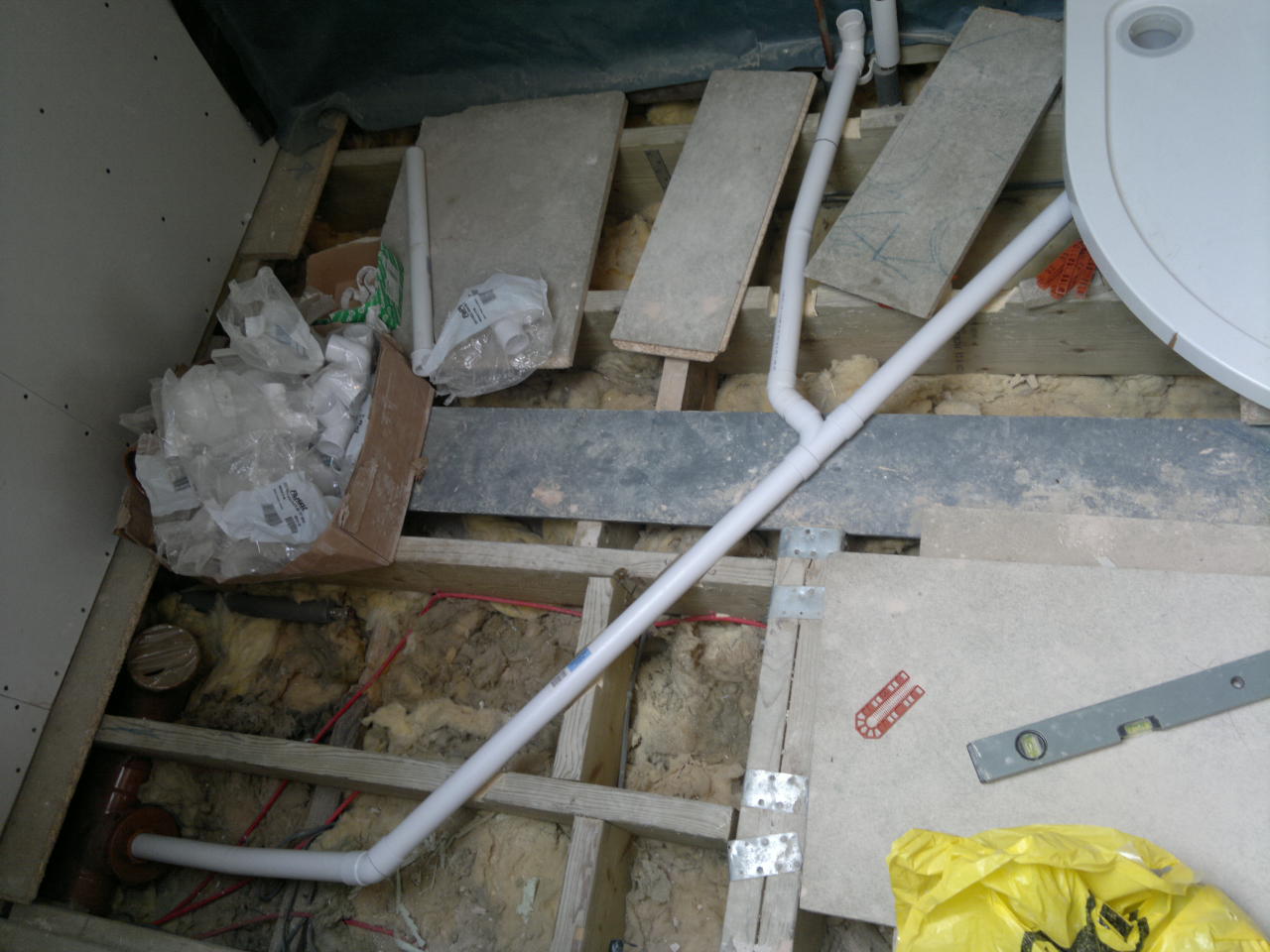

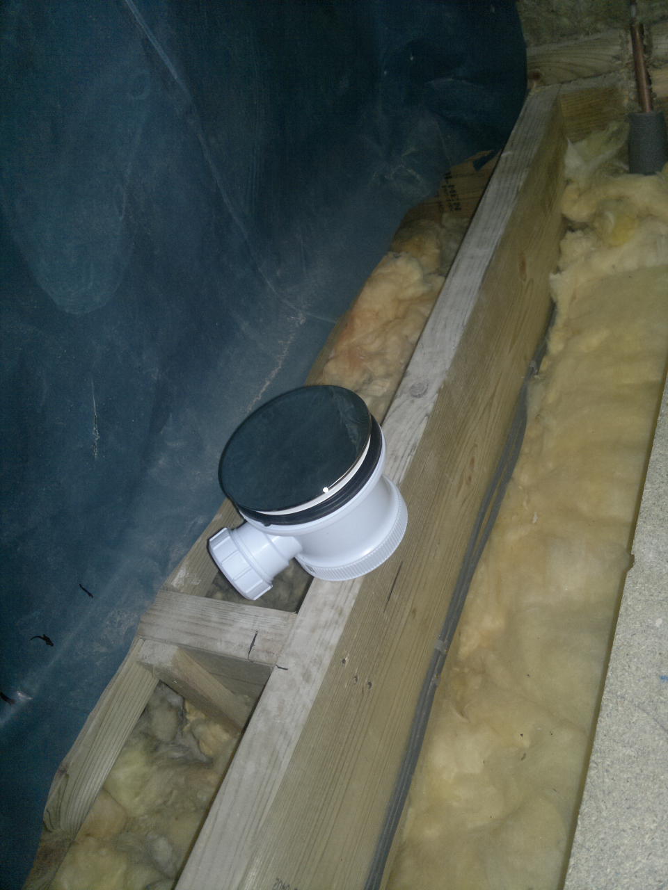

I wish to put in a shower tray in a loft extension - the trap fouls a 3.3mt 220mm beam directly below it.
Going by Reg's, I can put a 27.5mm notch on the beam, at max 850mm from beam end.
I need to make an approx 60mm notch at 1mt, even then the 60mm does not allow me to unscrew the base of the trap.
Bit foxed about how to resolve this, bathroom stud walls are all in - plastered other side.
Could you double a rafter with such a notch, or trim out the section.
A riser kit makes the shower panel a very tight fit against the pitched roof, but guess thats an option, if it will fit.
I assume not, but can you turn the tray 180 degrees?
I put our outlet at the door end of the tray, and used a flush grid drain to help with clearance issues so it may work for you too.
Also no need to use the standard riser kit, we only needed about 60mm as well so I just put 2 inch battens and a sheet of 18mm ply to get the height I needed. I think the riser kit would have added double that.
Could do with more pictures really. Initial thoughts are to look at a tray with a linear waste. If not could you build the wall out to step the waste into the cavity beyond the joist?
Thanks for the replies, I can make a 50mm rise which would help, and if I go notch out 80mm I can then remove the base of the trap if I ever needed to - such as a bad blockage.

A lot of shower traps come apart from above for cleaning(y)
Thanks - that would reduce the notch depth required ... with a 50mm riser - it might even be within Regs, give or take the 150mm span difference.

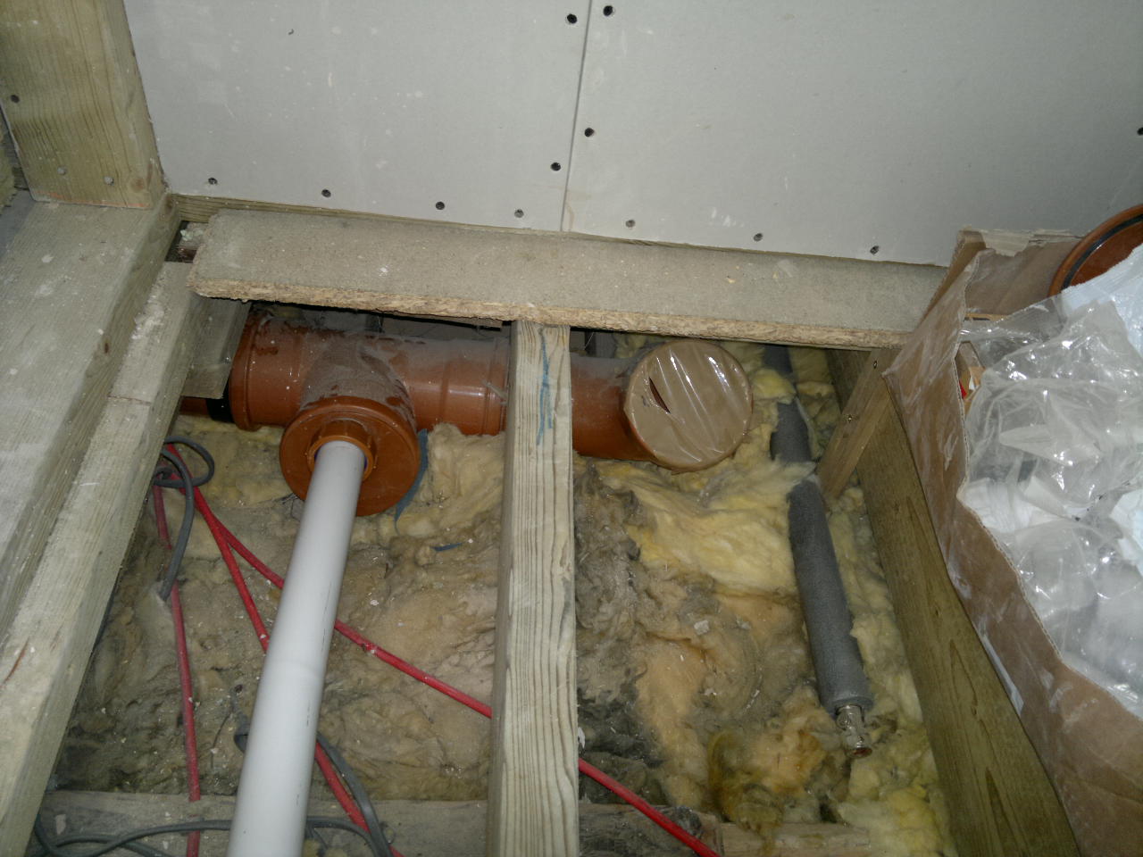

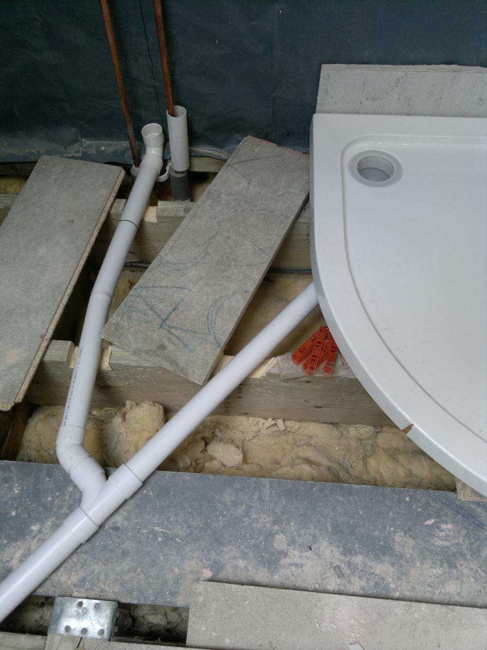

This did my nut in, ended up raising tray up 50mm, and routing waste over steel, has a fall - of sorts. Floor will also be part raised in the bathroom by 22 mm (thickness of T&G flooring).
Next time I plan it better, trapped (excuse the pun) by two large steels, very difficult, not sure how you could plan it better - apart from moving bathroom well away from its current position.
Thought about routing it down through a toilet stud wall below - although beleive a vertical drop would suck anything out of your trap.

Did you bend the basin waste over your knee? Careful when screwing the flooring down ;)

Vertical drop would only do that without an aav. You need an aav or a vent at the top of any significant drop and you would need to do 50mm pipe really. Although a normal shower wouldn't fill the pipe in the same way as emptying a bath or basin would.
We had a similar issue when we moved in, 40mm pipe going uphill, and we managed to fit a 50mm pipe (55 o/d) inside a stud wall with 70mm studs somehow.
The stak terminates at the bottom just under the ground floor into a 110mm pipe combined with a toilet and at the top in the loft with an aav.
Used a hot air gun, gently ! then applied a bit if pressure, too much heat and the pipe turns to mush.
