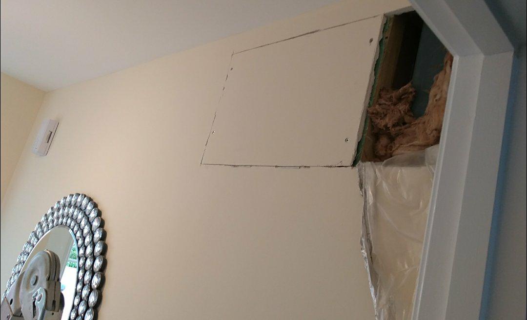

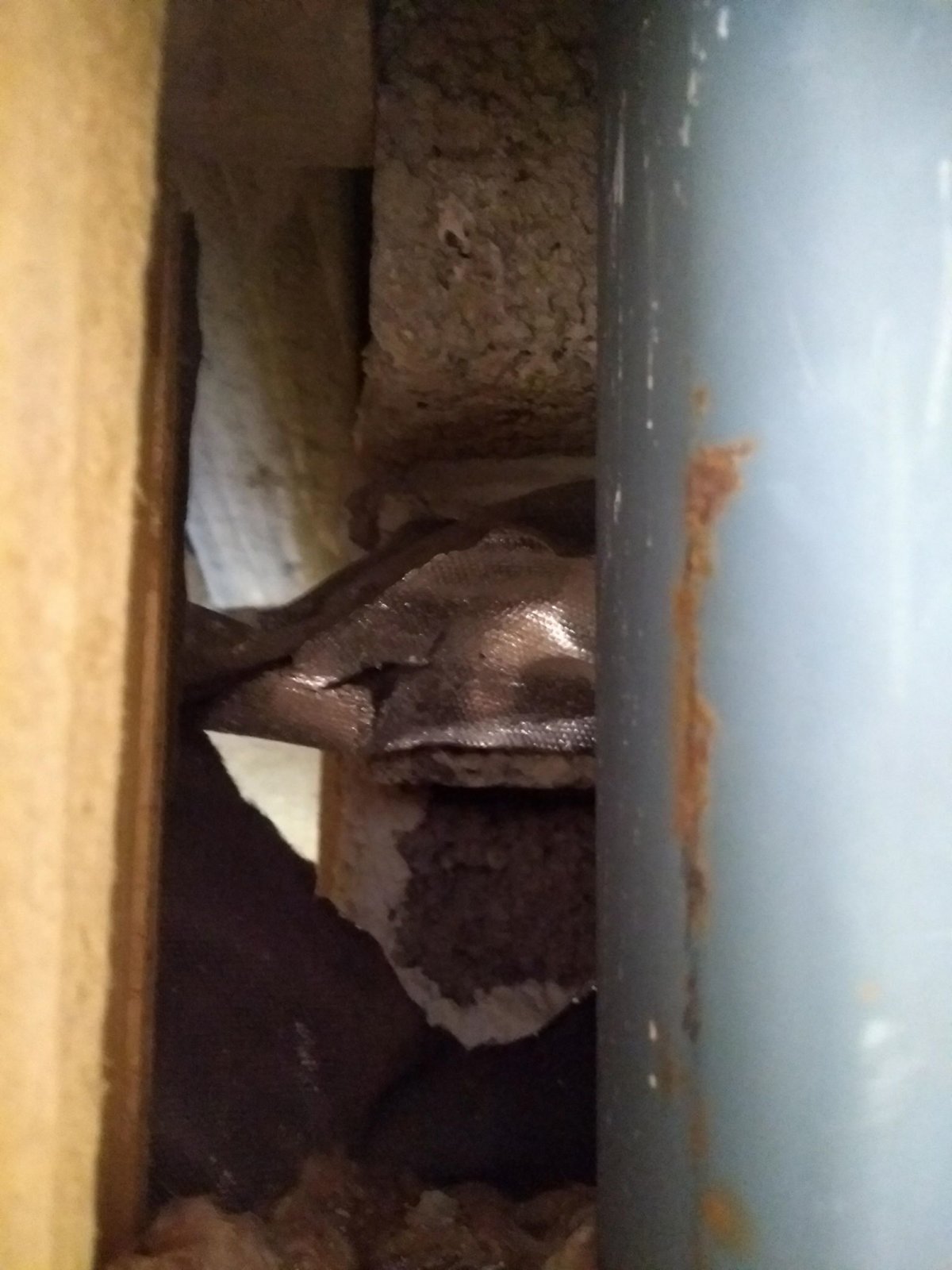

came across this today after some thermal imaging surveys - its in a corner expansion joint between the front of my building and the main box. timber frame property.
any ideas how this should be? seems weird to have a random block so close to a structural pillar and a large gap. no OSB board etc etc.

Is it the boxing in for your soil pipe?
No. its a structural steel beam which seems to have no OSB board behind it and the light you can see is actually coming from the eaves in the porch roof/outside. cold air bellowing into the inner leaf.

Already done. went to NHBC too. NHBC's "fix" is just to patch up the membrane ignoring the fact that the frame (OSB) doesnt seem continuous and the structural column isnt boxed in and no VCL in roof layer either. hence why looking for a builders opinion.
