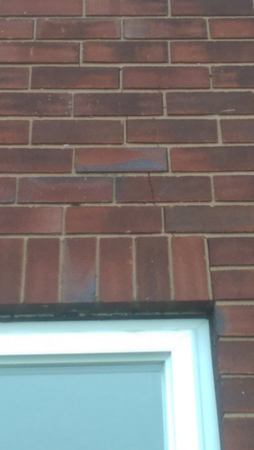

Anyway, we're noticing more and more cracks both internal and external. There's 2-3 fairly large cracks above and below the front downstairs windows. They're diagonal following the mortar but parts do also go vertically through the middle of individual bricks.

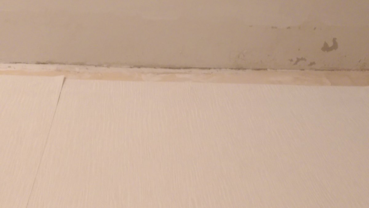

We have just redecorated the dining room which meant taking the old coving down and have noticed large cracks inside, around the edge of the wall where the ceiling and wall meet on the window wall and 2 adjacent walls. There's also a large and quite wide diagonal crack to the top right of the window internally. (Both pictured)

Internal plaster cracks without external brickwork cracks are rarely of structural concern.

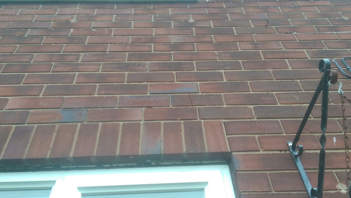

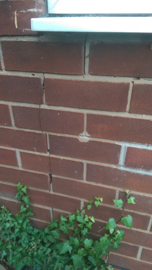

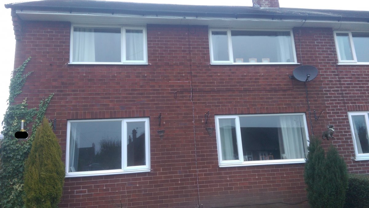

Hi, thanks for all your replies. Sorry it was a bit too late to take external photos last night :) This morning I can't find the crack that was on the gable end and also can't photograph the one above the right downstairs window which looks like it's closed up.

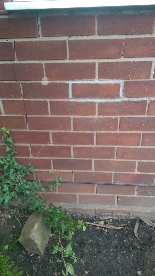

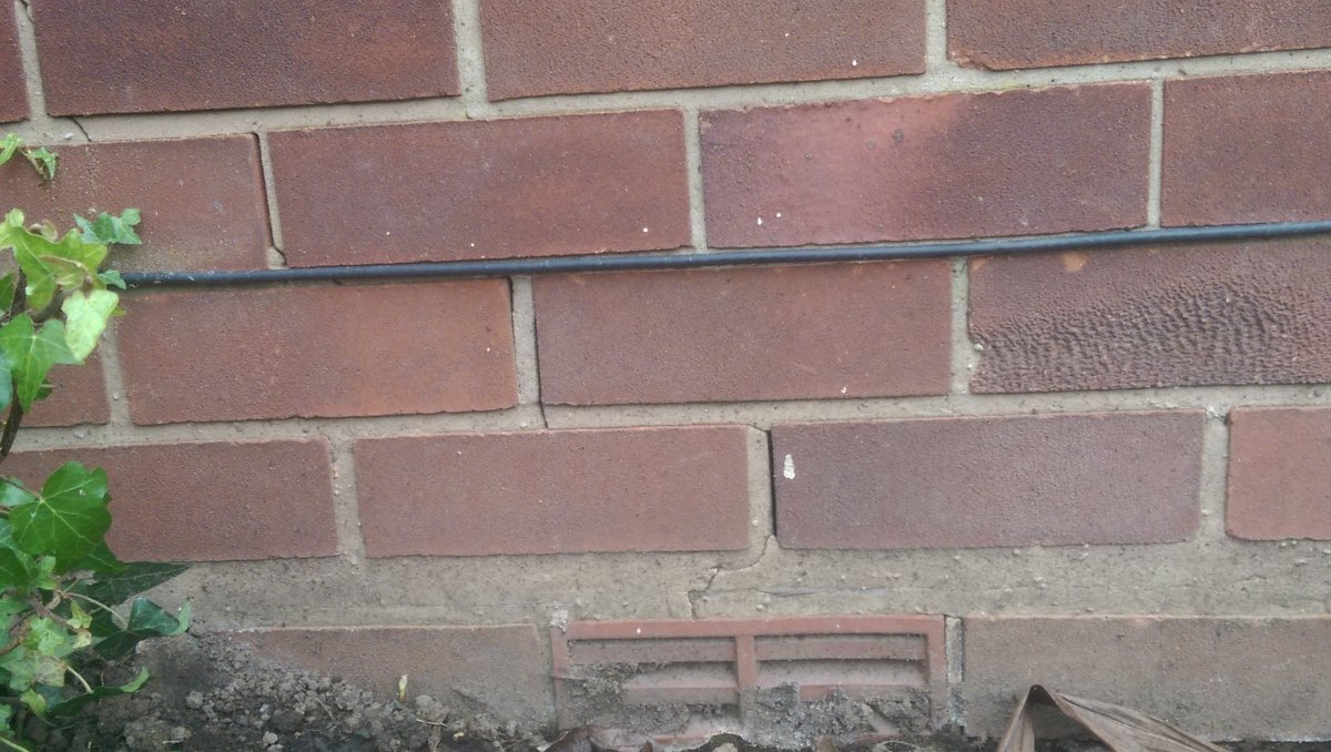

The one under the right window looks like is just reaching the damp proof course which I've read is bad?

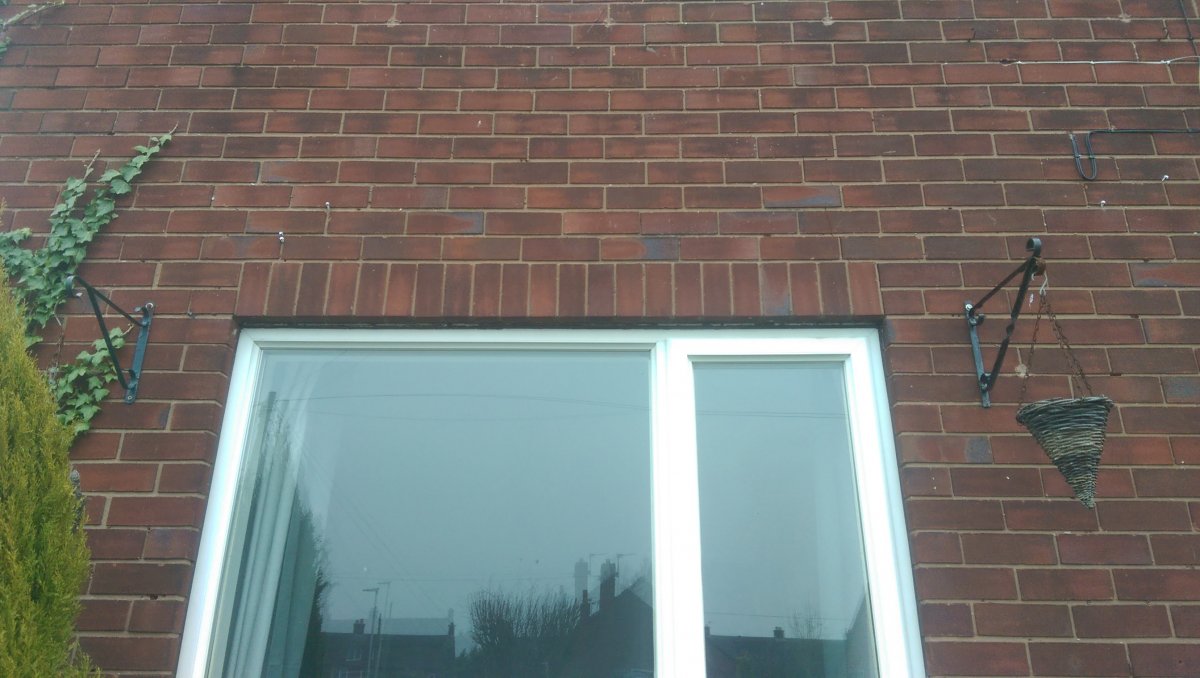

I don't know if it makes a difference but the above photos are of the dining room which is the bottom left window - the one with the cracks pictured.
Found another crack around the back from the drain up to just under the bathroom window where there's a brick that someone's clearly tried to patch up?

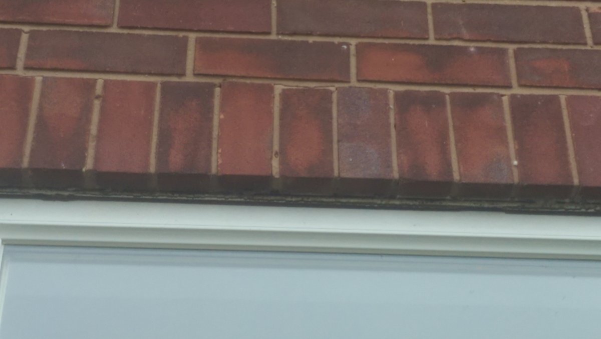

Also, very sorry. I wouldn't know what a lintel was if someone smacked me in the face with one. So I've just had to take photos of the top of the windows :)
Thanks again

Where is the associated internal cracking? In fact where is the external cracking?
Sorry did my best with the photo's.
Do you mean as in, where is the external cracking in relation to the house? Or where is it because the photo's aren't very clear/very big?
The main internal cracks were posted in the original post. they are on the same wall as the bottom left window. Approx where the hanger for the hanging basket is.
The crack that goes down to the damp proof course is under that left bottom window. The one that goes through the middle or a brick is above that window.
When your house was built it was common not to use a lintel on the external brickwork, but rely on the timber frames to support the load.
Concrete lintels would be used on the inner wall.
You can get problems when the frames are replaced with plastic.
What looks like a metal lintel might be a tray.

It won't let me upload many pictures. Would it help it I drew on them following the cracks to make them more obvious or if I just annotated the picture of the front of the house with where they are?
Thanks for your help
Nothing to do with your photos. I asked the biker how he can state that there is subsidence from those limited photos, and how he could state that there is subsidence in the absence of no internal cracking in the same place as any external cracks - which is indicative of foundation movement (aka subsidence).

If you had a metal lintel it should support the bottom of the bricks. It looks more like a softer DPC material which was put over the inner concrete lintel and under the brickwork to stop any water running down the cavity and inside the house.
Replacing the timber with plastic can cause cracking above.
