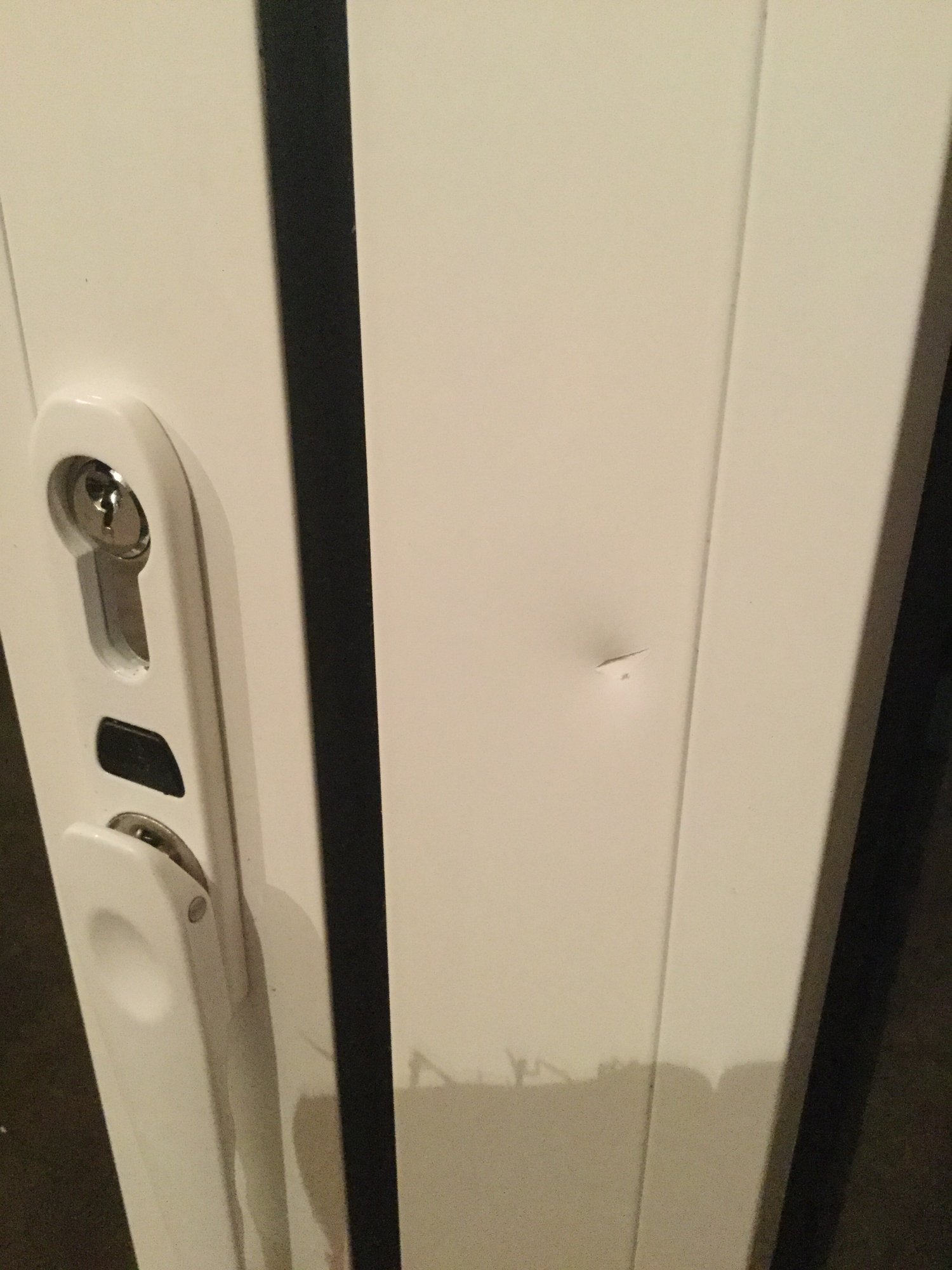

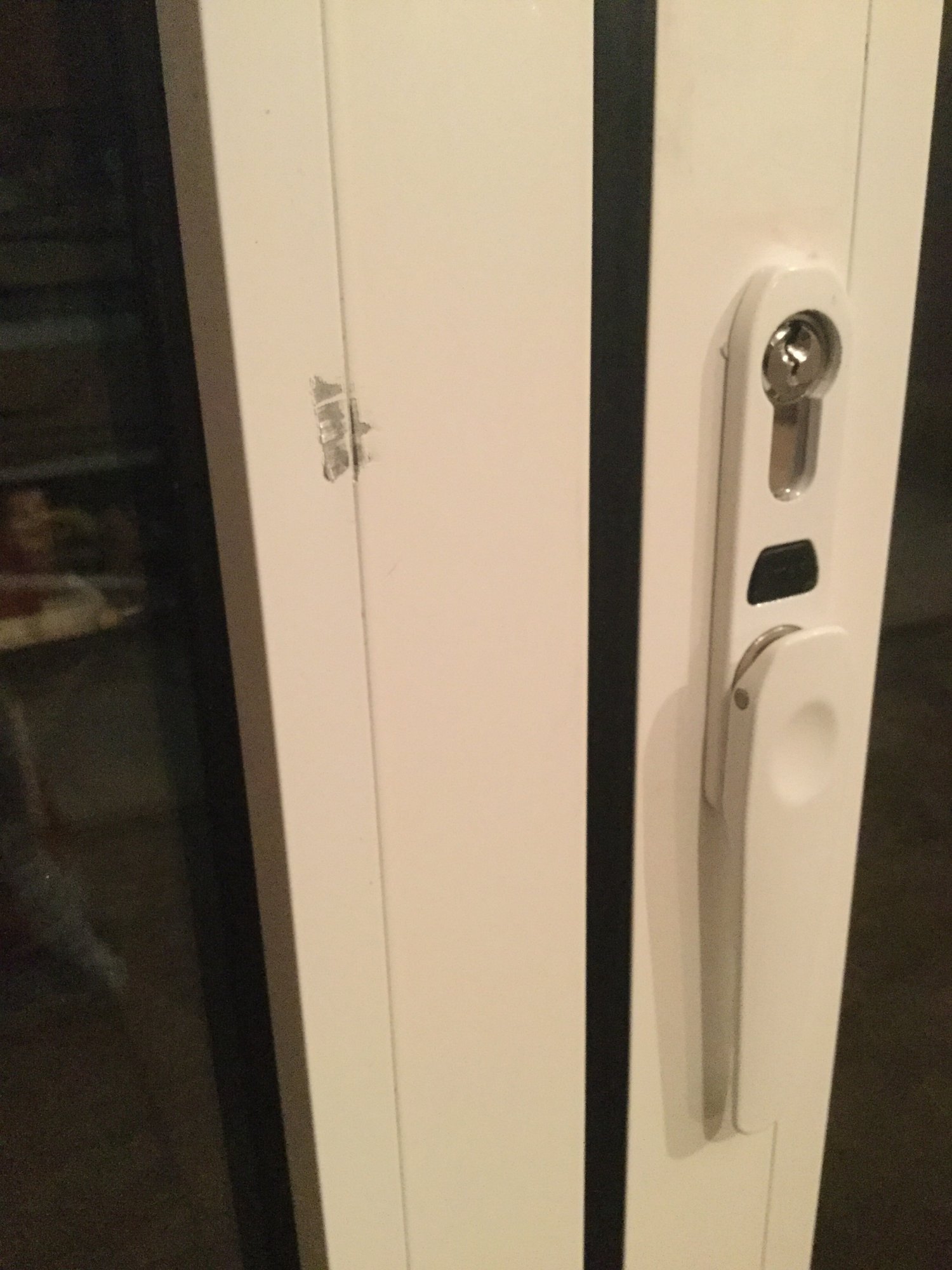

We have just had an extension built with white aluminium bifold doors out on to the patio/garden. I have been a complete muppet and upon getting home and seeing them for the first time I have opened them up without removing the keys, causing the below damage when the doors have concertina'd together. Does anyone have any advice on anything I can use to touch up the scratch or anything that can be done about the dent? I really am in my wife's bad books so any help would be much appreciated.

I was thinking maybe putting some white epoxy over each of them and then when it's set, rubbing it back with some very fine grit wet/dry paper.
You can probably use the same technique as for car body repairs. Since it's not at eyre level you shouldn't need a prefect finish.
It might even be worth getting chips away or dent devils in for a quote!
In your first pic the damage is mostly confined to what I think is the corner fillet that would be removable for fitting a new DG unit, so it might not be too costly to replace that.
In the second the dent is clean and even and the suggestion to ask Dents Away isn't a bad one.
I doubt that you would be able to sand polyester filler without scuffing the surrounding area though. That said, you could just respray the whole stile bit colour matching the shade of white might be difficult.
