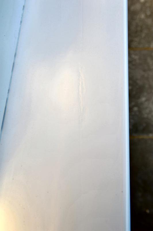

Hi,
A quick update on this one. Here is the second attempt to fix the deep scratch in a sill. I'm still not happy with it but the contractor has run out of ideas. Am I being too critical? I think I could do a better job myself.
The repairs to the aluminium bi-fold doors (white powder coated) are still outstanding because the guy they sent over didn't know how to use the resin touch-up he was given. Unbelievable!

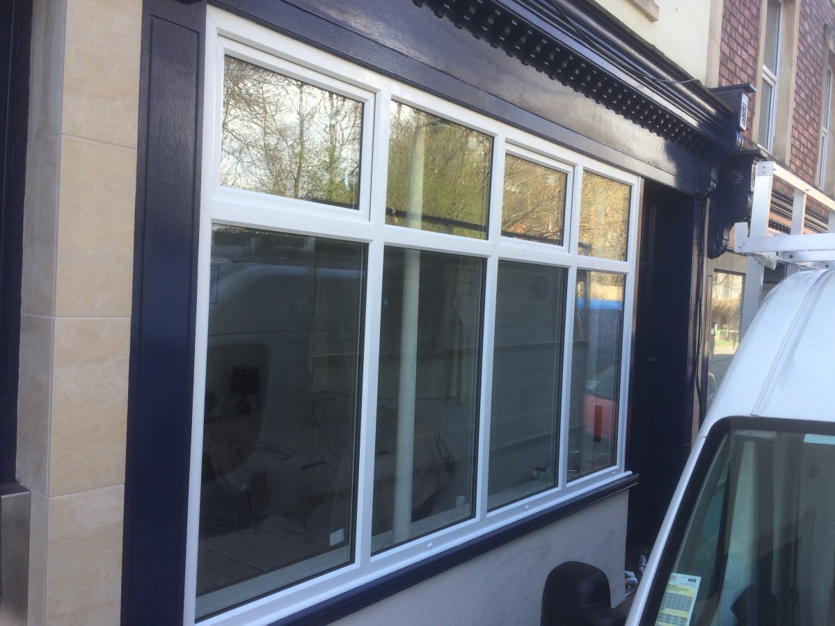

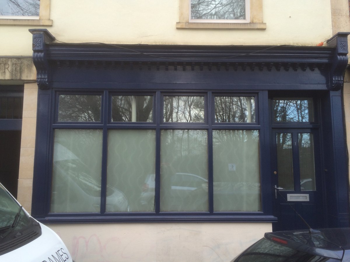

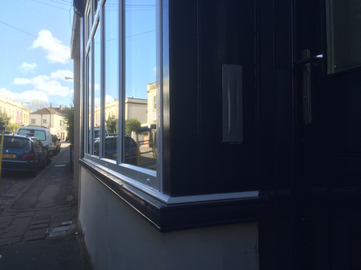

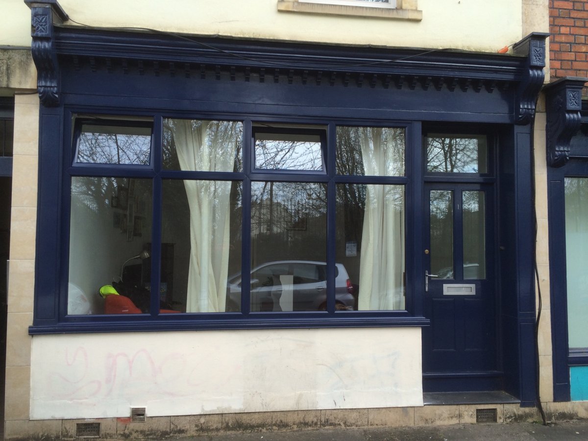

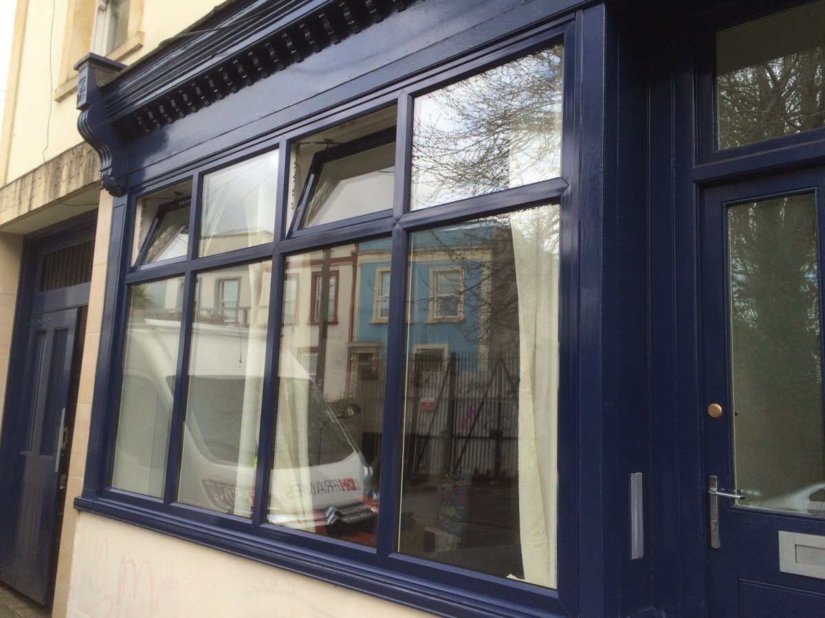

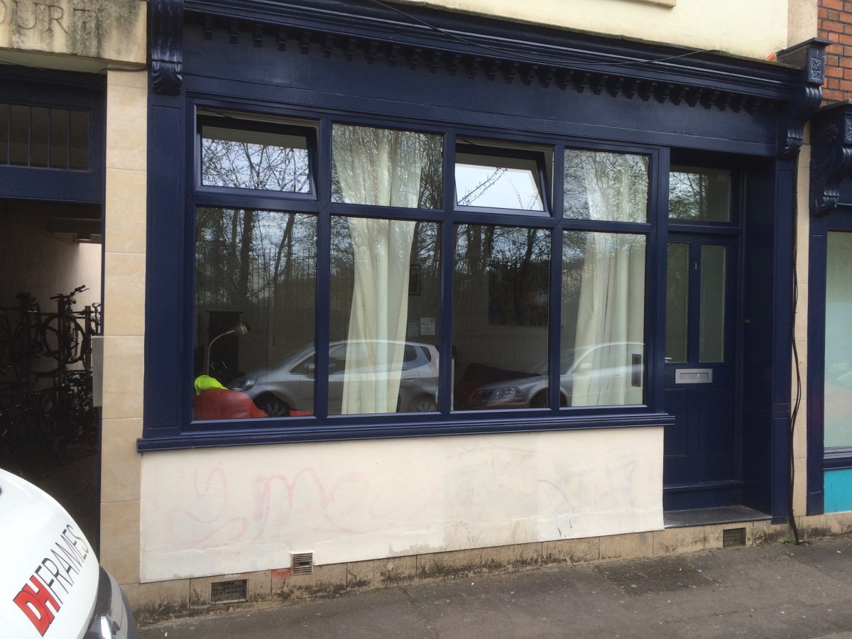

We used the Plastic Surgeons a few weeks back to colour match our window to the existing building.
Some of their repair work is unbelievable. Only used them once, they came highly recommended
Will be certainly cheaper than replacing
Couldn't fault them

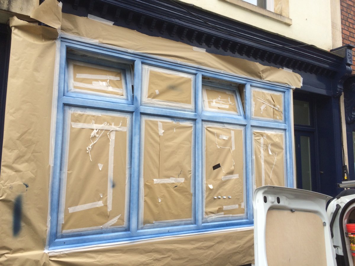

Where they newly fitted windows painted or old windows? Just thinking surely it would have been cheaper to spray them in the factory instead of once fitted?
Same price Gaz to have it sprayed in the factory or on site.
No risk of damage if sprayed after installation. We've had windows sprayed before in the factory, this is the way forward for us now.
Existing timber window replaced with our UPVC window
