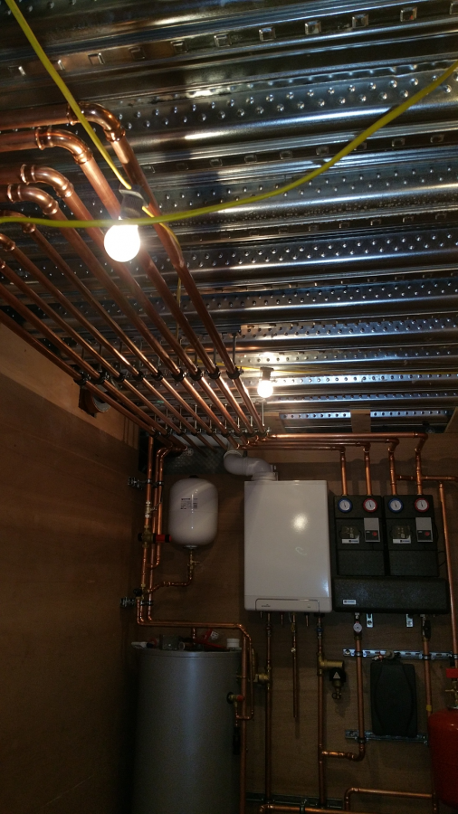

How about this system:
Picture taken while in progress, 236 square metres of UFH with a couple of rads.
All working perfectly.... Customer is a regular whom we install several complete system a year for - nearly all UFH - in fact the job I am starting next week for him is 50/50 UFH and rads. All to be run from those pump stations with no local temperature control at the manifolds, btu each room zoned accordingly.
Last year we signed off another for this customer 8Km of UFH in one house. All happy as Larry.

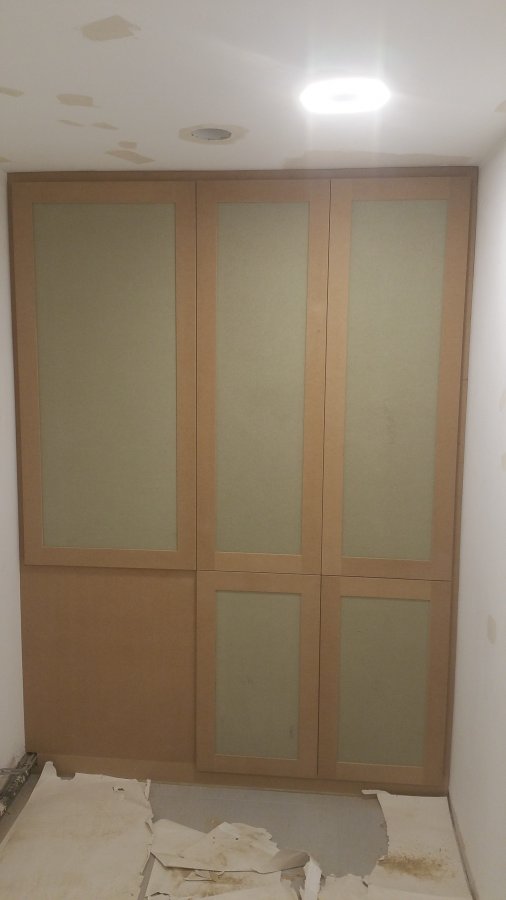

Can you believe Dicky - it looks like this now.... A travesty. :(
Well, I say it looks like this... the timber is painted and their is a Utility room across the left wall now.

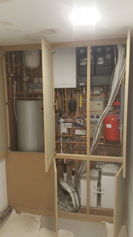

Atleast I can still service everything easily:
Hopefully the Sparks will have tidied up the cables by then :D.
So your customer for that installation is probably not the person who will be living in the property but an individual or company that develops properties for sale or rent. Developers tend to specifiy systems that provide the best financial return for them and the people who will be living in the property often have little or no input to the choice of heating system.
Yet again you make a daft assumption. The pictured system is his own house. He is a builder who renovates private houses worth between 4 and 10 million. He trusts my judgement and has never had a dissatisfied customer in the 14 years or so we have been designing and specifying the systems that we fit for him.
Although to be fair, he isn't stupid, and has a good idea of what is required anyway.
The job starting this week is a carbon copy of his system apart from the extra rads. Necessitating some extra consideration of the target flow temperatures.
