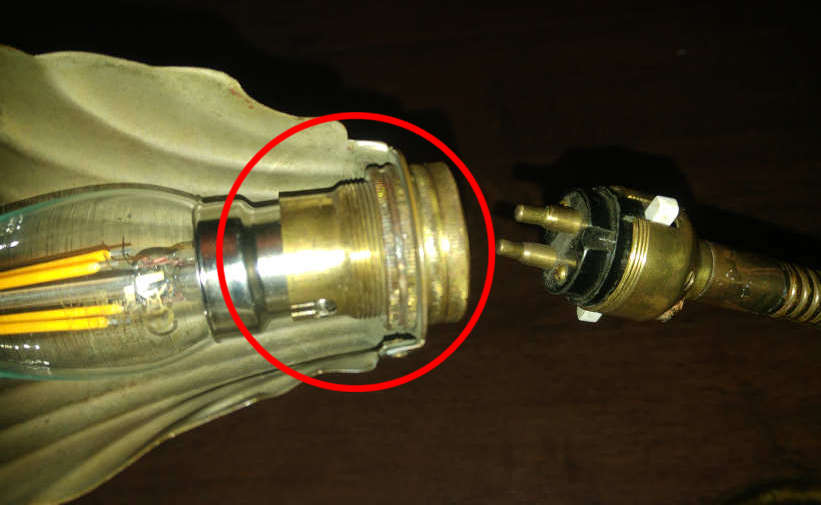

Recently bought a secondhand vintage desk lamp. Very attractive, and bonus was that it had supposedly been PAT tested. Got back from the antique shop to find the thread of the lampholder had stripped leaving the lamp (with bare live prong) sticking up in one hand and the lampshade and lampholder in the other hand! Thankfully I hadn't plugged it in yet.
I'm guessing that it's the inside thread of the lampholder (right edge of red circle) that's stripped but I'm struggling to find anything resembling that design in lamp spare suppliers. Can anyone shed light (sorry!) on what I'd need to get to replace it?
Also, the brass shell like lampshade spins on the lampholder but there's no obvious way of unscrewing the top and bottom parts out to get the lampshade off either - is it just brute force that's needed to unscrew it apart?

could be that the bulbholder part wasnt aligned properly with the bottom part as it was screwed back together. i seem to recall that some holders had lugs that fitted into the gap just above the switch bar which held the top and bottom in correct position so that the bulb contacts mated correctly with the pins. should be two "dimples" in the threaded top half. take the bulb out then the shade ring off and shade and then see if it will go back together properly

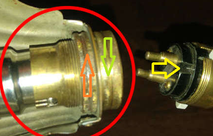

Remove the bulb.
There are 2 rings involved.
The orange ring is the one which holds the shade in place and needs to be turned in the direction shown, remove it completely then the shade will slip off.
The green ring will then also slip off. At that point I'd try screwing the green ring in the direction shown onto the fitting [by the switch] to check to feel what condition the threads are in. If ok remove the green ring.
Inspect the main part [with the bayonet slots] and there are 2 dimples [as 'Sureitsoff' mentioned & currently hidden by the rings] which will slide onto the black fitting in only 2 positions where they engage with the indents shown yellow. Either way is fine.
The green ring can then be fitted to hold the 2 brass parts together.
Sounds simple :D
In practice the rings can be very hard to move and may need a fair bit of force to release them. be careful as these fittings are easily squashed and then very hard to reshape. I see some damage to the knurling already so this fitting may have problems.
The threads are very fine and easily cross threaded, make sure you spot that quickly before causing any further wear.
Good luck and let us know the outcome

You need to get the ring undone and remove the shade because otherwise it can restrict the screwing of the other part onto the base.
Check that the bit with the 2 prongs is fully pressed into the base, and not sitting on a bundle of wires.
Fit the upper part into the two notches correctly, and hold it firmly in position while carefully starting the green ring. Tighten the green ring fully, being careful to stop the brass sleeve from turning and jamming in the notches. It can often turn a litle leaving it apparently tight but it then loosens and comes apart.
Then fit the shade and clamp with the orange ring.
As a precaution against shocks in case it ever comes apart again you can check that the switch is operating on the live prong, so neither prong will be live when the switch is off.

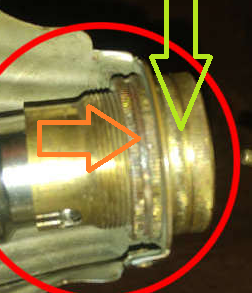

Sunray - the "top" and "bottom" rings in between which the shade is clamped that you kindly marked with red and green arrows are simply spinning past each other. No matter how many turns I make, they won't unscrew from one another or give any indication that they are getting any further apart. Nor will they pull apart, at least not without squashing them. Unless I can separate them I won't be able to get the brass lampshade off, in which case unless the lowest (external) thread is the one that's stripped, getting a new lampholder won't help me.

try holding the shade and turning the "red" ring. the "green ring is meant to spin as it it that that screws on to the bottom part
That's not actually bad news, as another has said the green ring should not be locked at this point.
You need to hold the item with the bayonet slots still [this can often be done by a long thin screwdriver through the bayonet slots Be careful not to bend anything.] and turn the orange ring, possibly with long nose pliers or pump pliers.

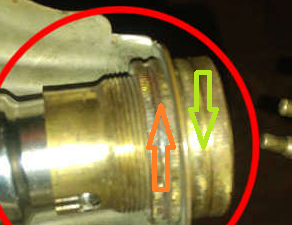

Many thanks for everyone's advice - I tried Sunray's approach and eventually the inner ring started to move. Must have taken me an hour to get the ring off as it was almost toally seized throughout the length of thread but now it's off I can see it's going to be a simple matter to fit a new switched lampholder and I've found a shop nearby that supplies the old brass style. Fortunately the gooseneck stem's thread is sound so only the lampholder and flex need replacing.
