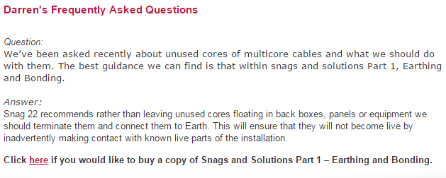

I have just received an email containing this from NICEIC.
They didn't used to speak to me until Elecsa sold out.
Is it just a ploy to sell their publication? I hope so.
Are there really "electricians" so unable to think for themselves?
Does NICEIC really need to look up "snag 22 of a guidance document" to answer such a question?
If that was "the best guidance we can find", what were the lesser suggestions?
Is it necessary to employ people to write such documents (and emails)?
What else is in this publication? Do not poke your eye with the wires.

In the case of snag 22, the book referred to 130-02-01 (as it was then) and pointed out that induced voltages could appear in unearthed conductors.
What else is in the publication? I'd need some time, but I can list all the snags if you wish!
