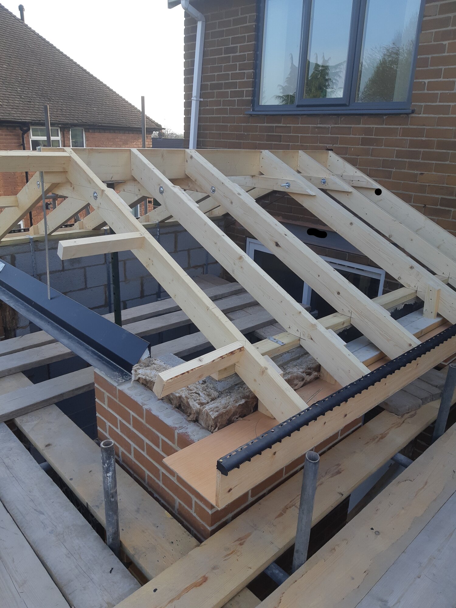

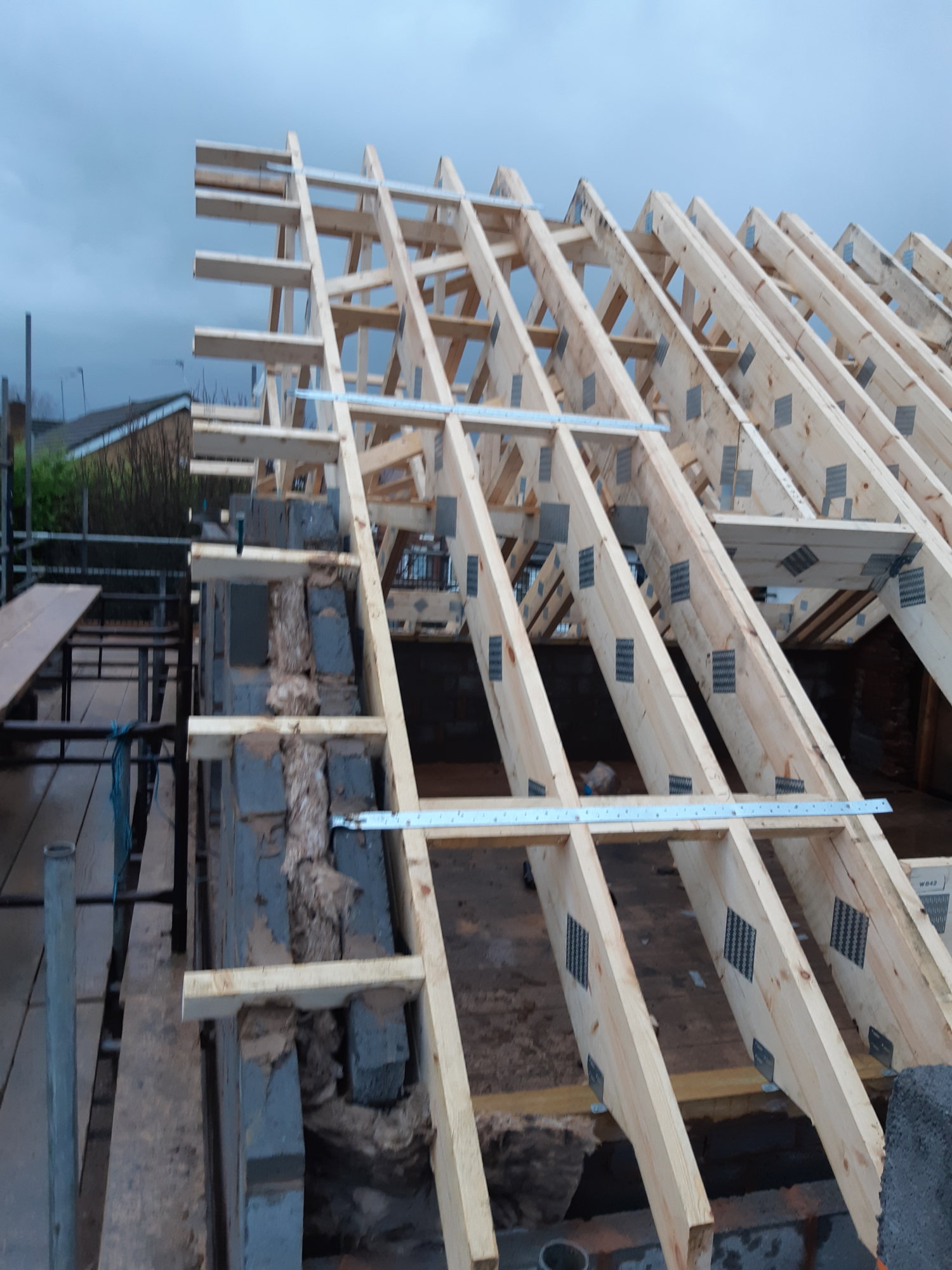

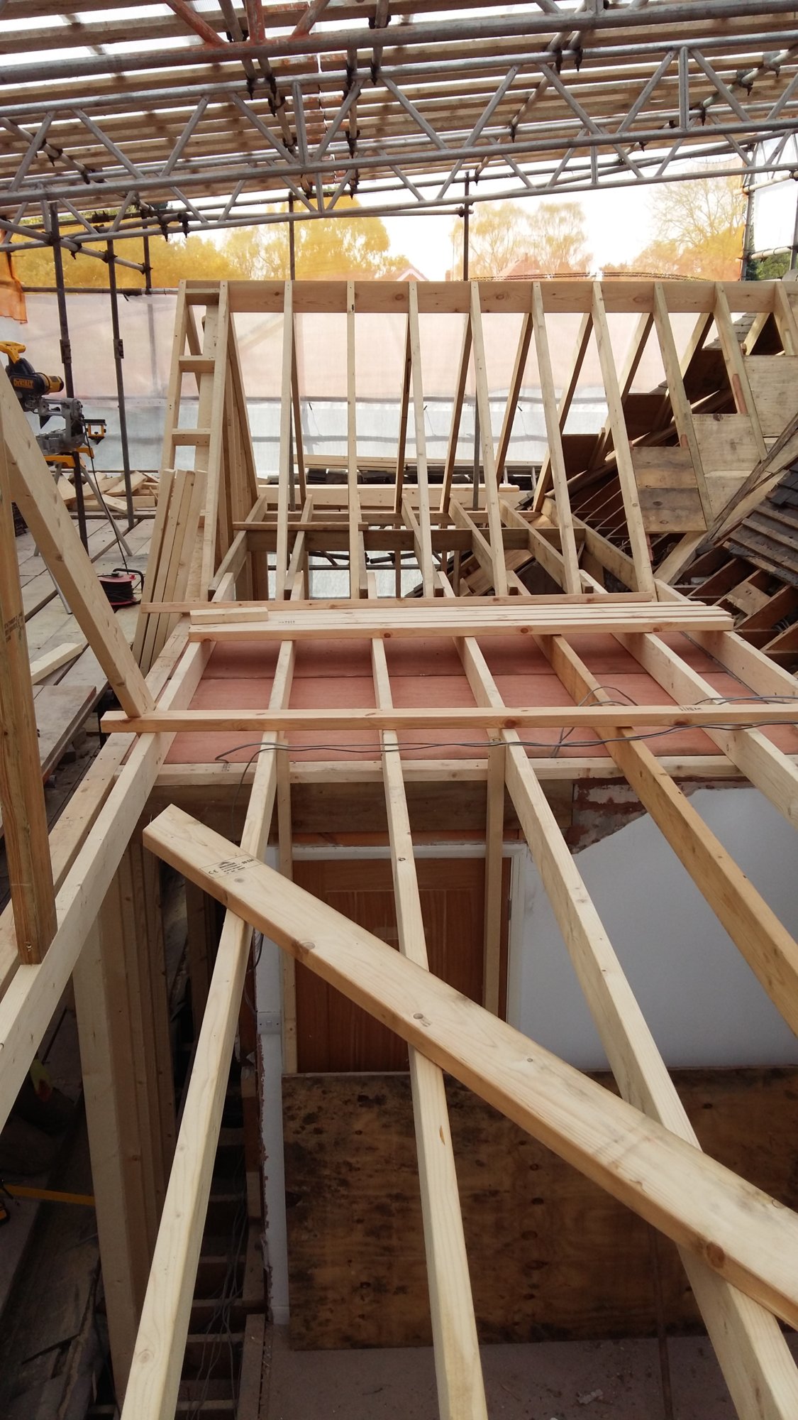

I'm guessing you are talking about barge overhang, i.e. gable end?
1. I could cantilever the wall plates out at each end
No.
2. I could end the wall plates in line with the walls
Yes. Then just add noggings with length to suit and an extra (non b/mth'd) rafter to the nogg ends.
