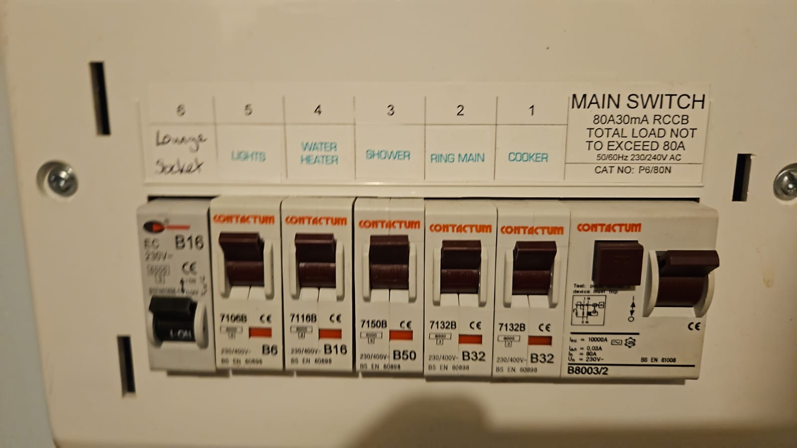

My son has just got his first flat and already has issues with a shower. Existing is 8.5kw and I'm wondering if the cable already there would be big enough for 9.5kw, cable is approximately 25mm across, and also, would the installed RCD (B50) be ok, or would an MCB be better? Can you mix and match RCD's and MCB's?
Is the existing shower circuit protected by the 50 amp MCB in your pic ? If so ,a 9.5kw shower can be connected. The circuit should also be protected by an RCD ,but there isn't one in your pic. Show full pic of consumer unit and any other electrical installations around / near it.
What's that on the far right, with a trip rating of 0.03A?
Please can we have an in focus photo showing the whole of the CU so that all devices are fully visible?

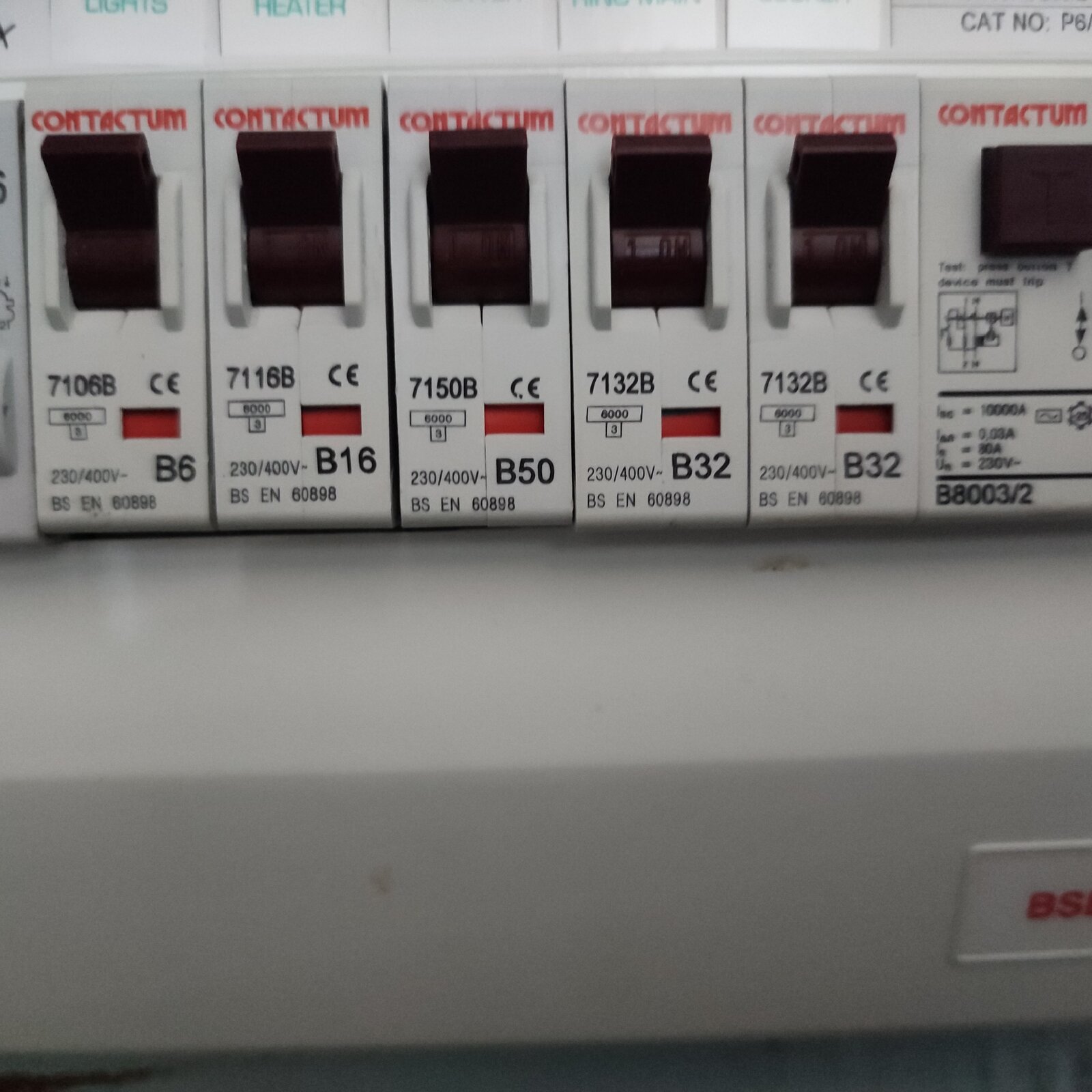

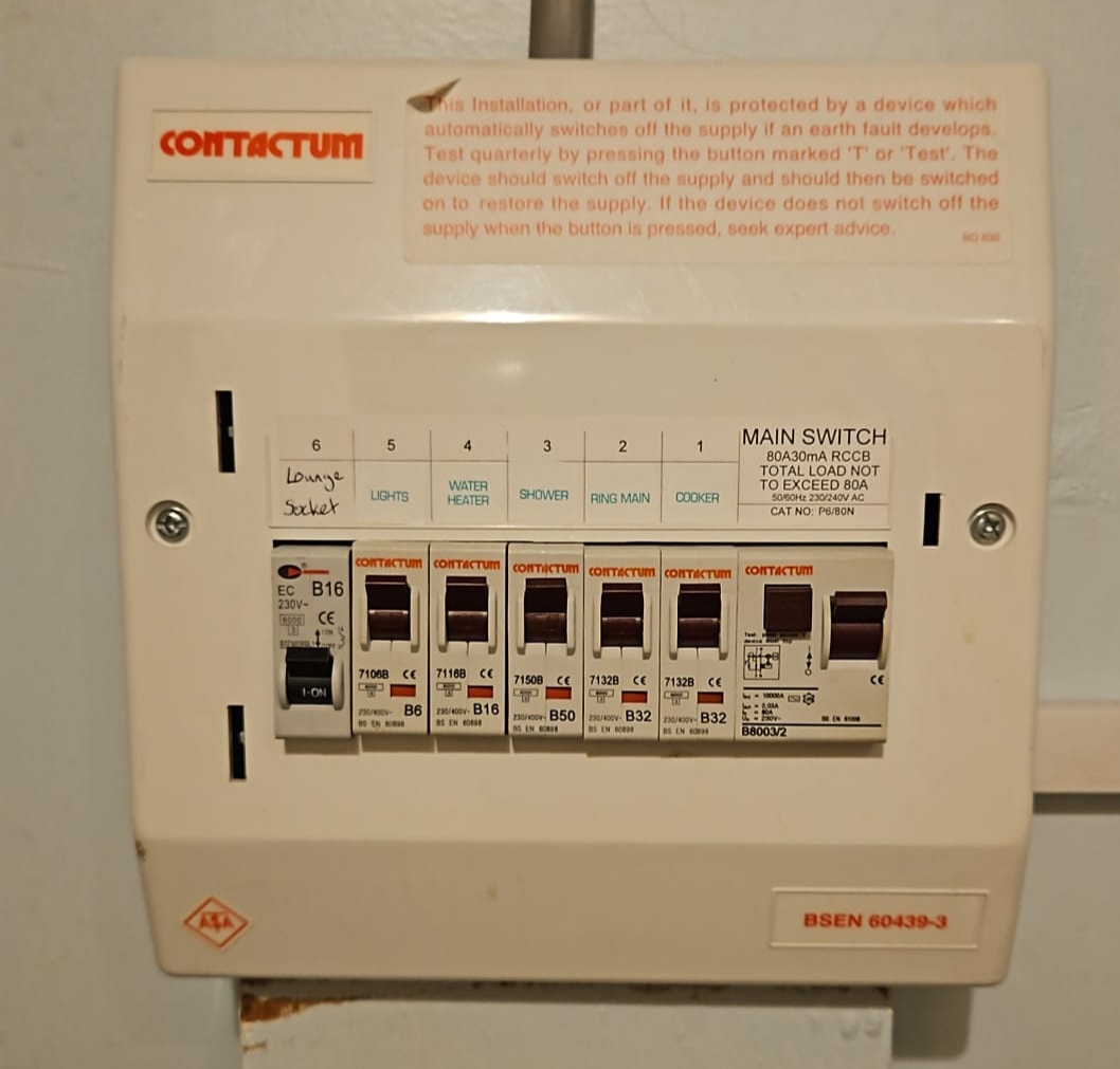

I'll try and get a better picture
The shower is on the 50 amp mcb, can I just replace it with the correct size rcd? also, any idea of the cable size, 6mm or 10mm?
There appears to already be an RCD in your CU - the module on the far right of the photo. Iooks to me as if it has an IΔn value of 0.03a marked on it - that makes it a 30mA RCD.
That's why we need a better photo - we need to be sure what is in the CU, and if that module is an RCD, to help you confirm whether it protects the shower circuit (very likely)
If that is the case then you just need an MCB appropriately rated for the cable size and cable installation method.. If not, then it's not an RCD you need for the shower, it's an RCBO (combined MCB and RCD)
