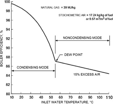

This, also, might be of some assistance, its important to remember that condensing (dew point) only begins at ~ 55C so the boiler return temp needs to be 35C/40C to get really meaningful condensing effect.
If you mean the dewpoint of the flue gases after burning NG it will vary dependent on the amount of excess oxygen supplied to the burner.
