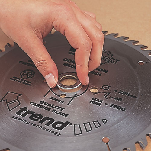

You can get bore reduction bushes to suite.
I've had DeWalt and Makita blades in the past that had these included.
Thank you for your reply SammyInnit and for your reply bobsuerita regarding the bore reducing bushes mentioned am I to understand that if I purchase a saw blade which has a bore of 20mm I can insert one of the bushes into the hole of the saw blade and it will then fit the 16mm fitting on the circular saw. Hope this makes sense.
Yes.
