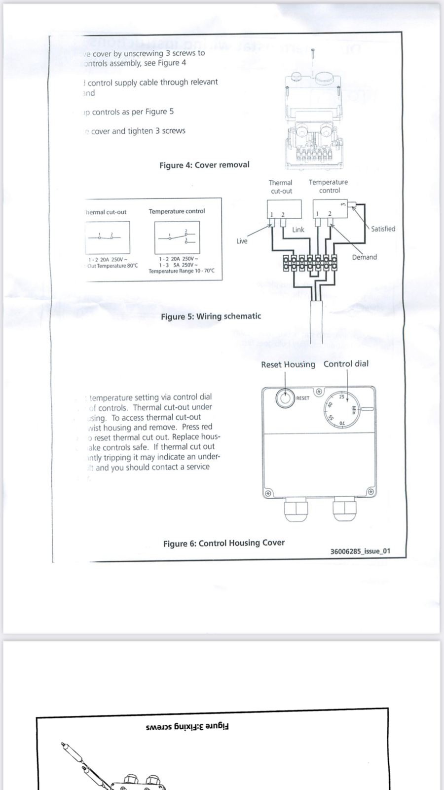

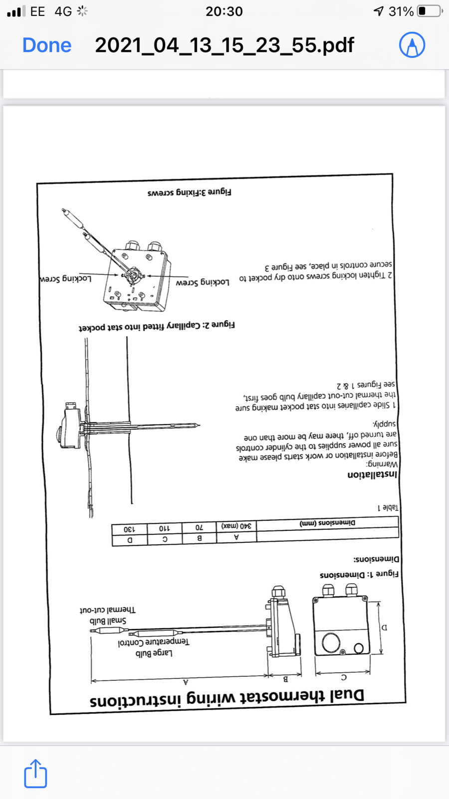

I have been given this dual stat to replace one on an unvented cylinder. The original type( with an earth connection,) is no longer available.
This one does not show an earth and nor can I find an earth terminal. Can I assume it’s double insulated and ok to install ?
I have been given this dual stat to replace one on an unvented cylinder. The original type( with an earth connection,) is no longer available. This one does not show an earth and nor can I find an earth terminal. Can I assume it’s double insulated and ok to install ?
Does it have any exposed (i.e. touchable) metal parts? If not, there's nothing you could earth.
Kind Regards, John
Thanks John , what I am uneasy about is the 2 copper bulbs pushed into a metal tube to sense the water temperature
, somehow I can’t believe that they could never become live

Thanks John , what I am uneasy about is the 2 copper bulbs pushed into a metal tube to sense the water temperature, somehow I can’t believe that they could never become live
Firstly, apologies, it did not sink in to my brain that you were talking about a cylinder stat - I was was probably thinking that it was a wall one!
I suppose that whether or not those bulbs could ever become live depends on how the device is designed and constructed (and what is inside the bulbs). Even if they could and did become live, you wouldn't be able to touch them, so the only real risk would presumably be that they could touch the tubes - but they presumably would almost certainly will be earthed (via the cylinder) - so that, in practice, if the bulbs ever did become live AND touch the tube they would trip something. It is, however, perhaps a little odd that there is not provision for earthing the bulbs.
Others may have other thoughts.
Kind Regards, John
Often I come across unvented cylinders without the immersion heater connected and without an earthed cylinder stat one would be relying on the earth bonding presumably (I am not an electrician) The stat ,made by cotherm, has nothing in writing to tell me if it’s ok to do away with the existing earth.
I was hoping a professional electrician may have wired one up perhaps armed with more detailed instructions via a cylinder manufacturers literature

Yes that’s the one. No symbol that I could see
As I said before ...
... I suppose that whether or not those bulbs could ever become live depends on how the device is designed and constructed (and what is inside the bulbs)....
Whilst it still to some extent 'depends' (on the design), that description says that each of the bulbs is fluid-filled and operate a bellows - so, although they are copper, there's really no reason why they should go anywhere near anything electrical, so there is probably no significant risk that they would/could ever become live..
