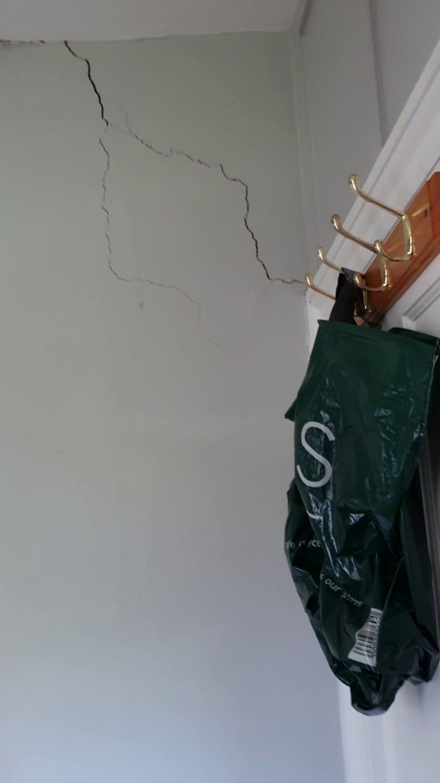

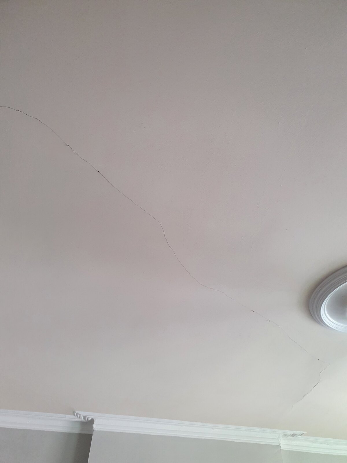

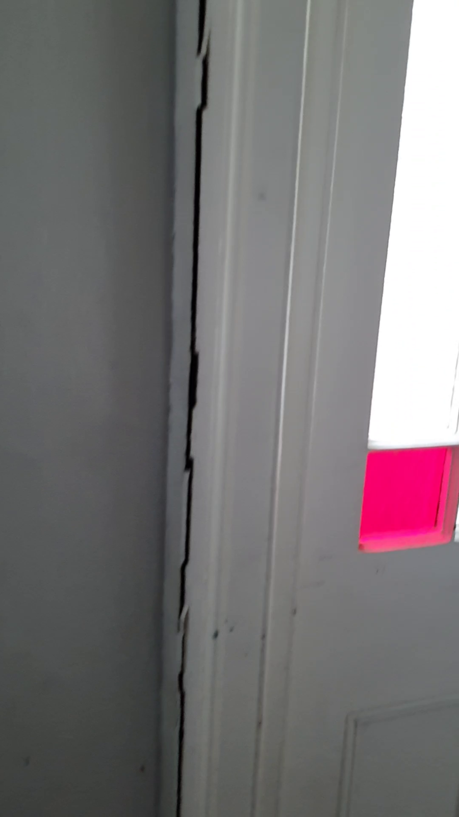

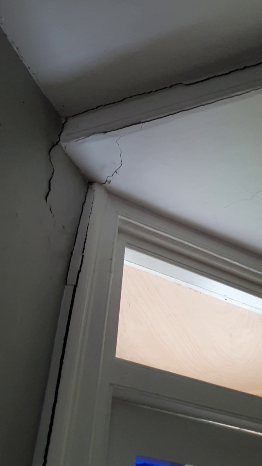

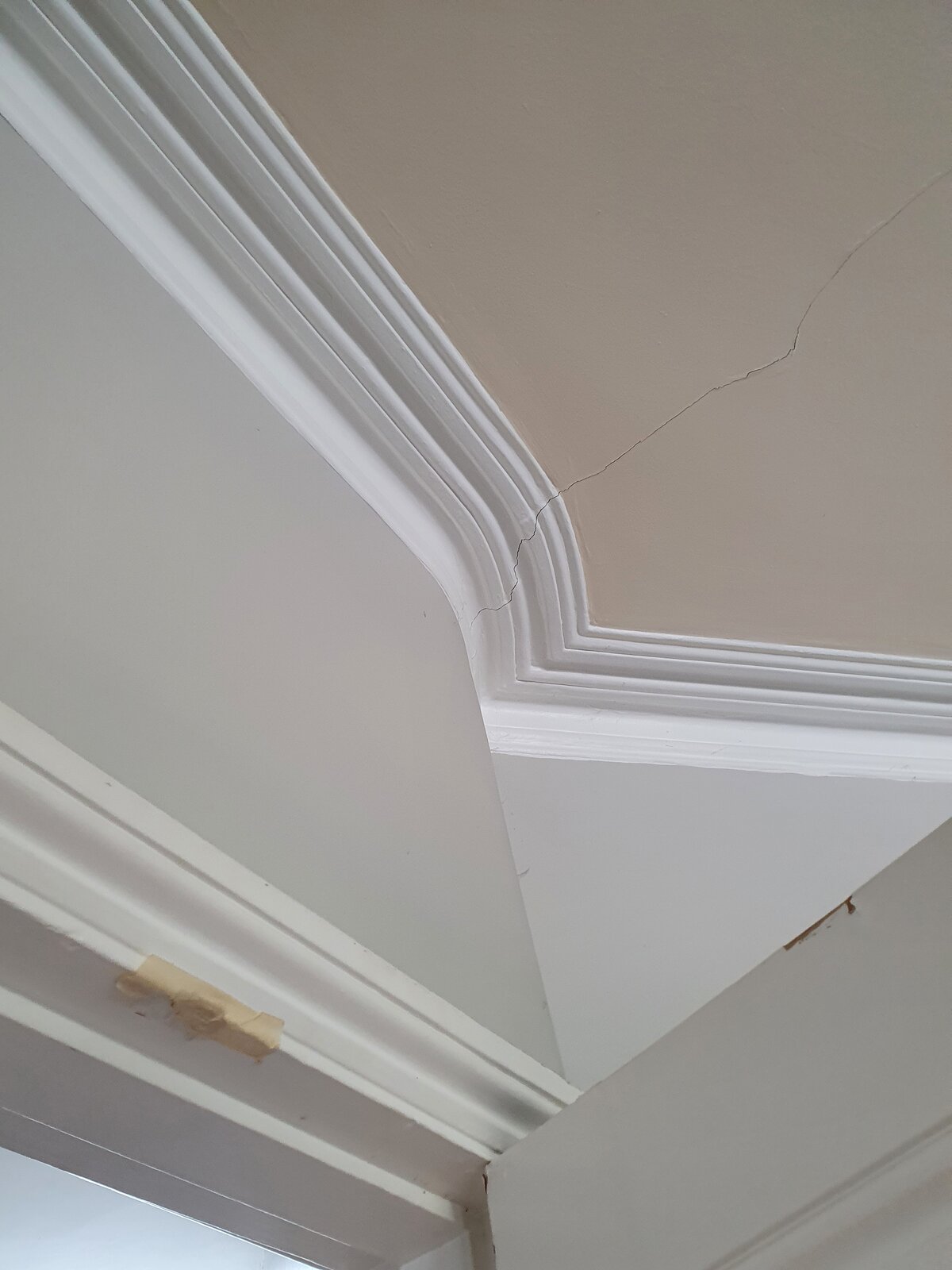

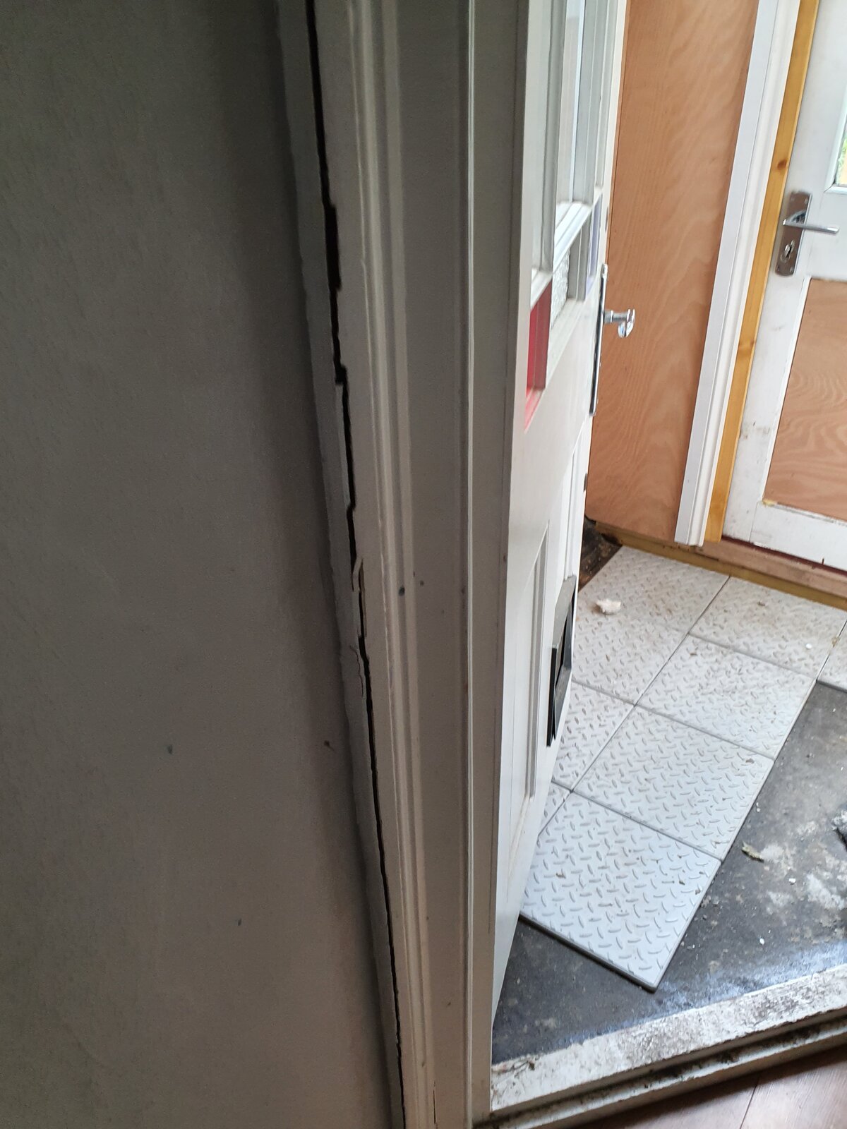

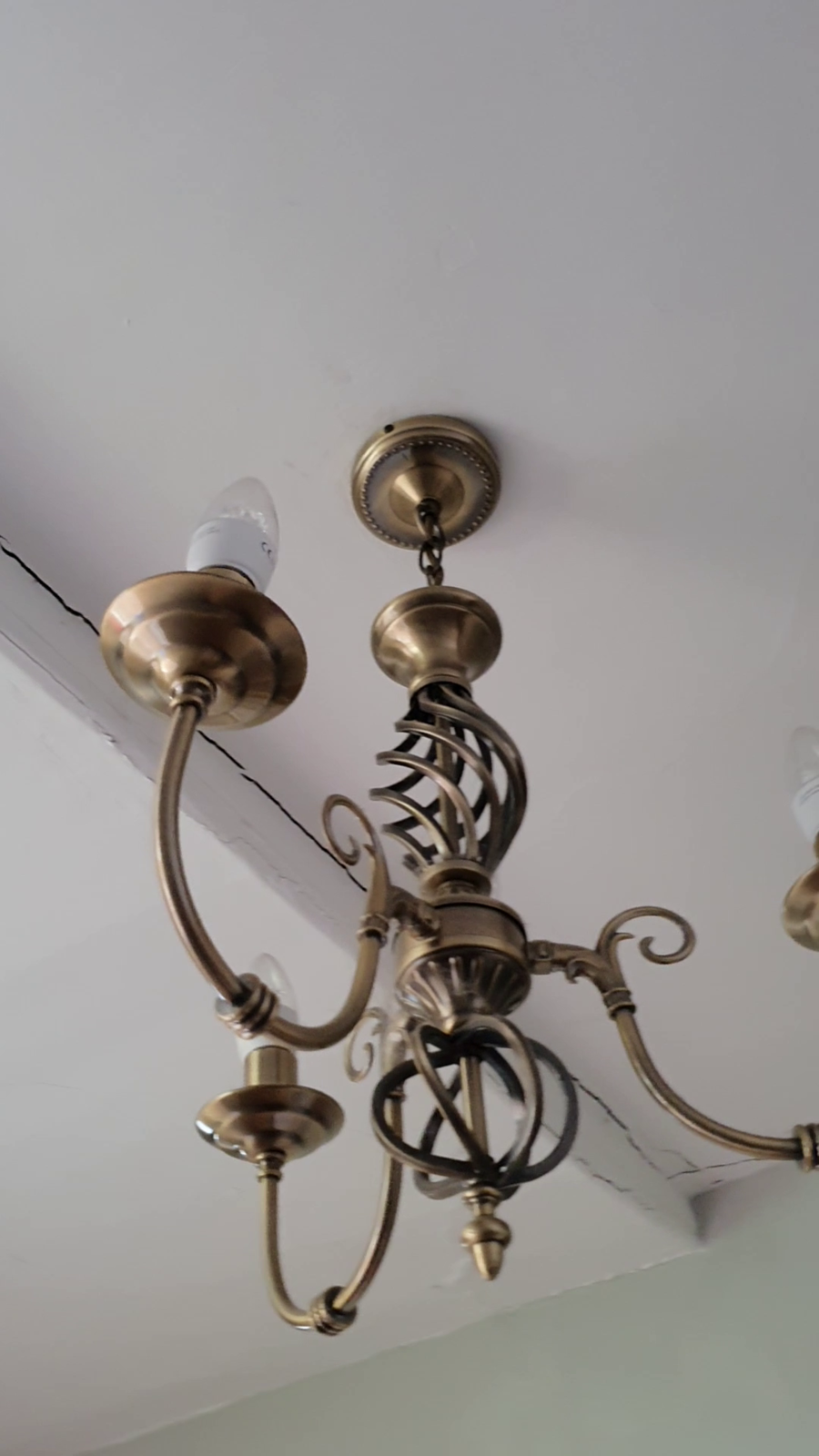

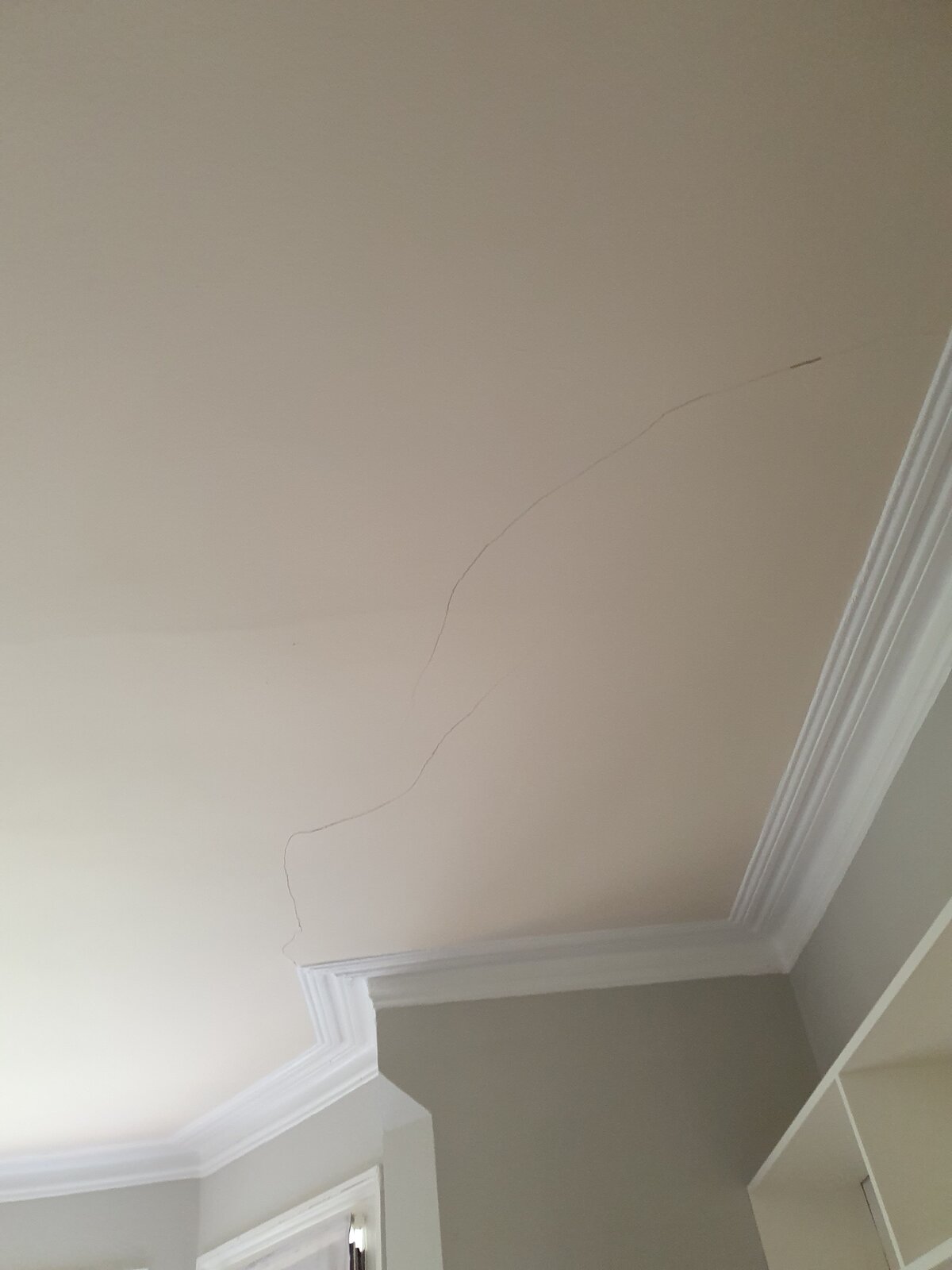

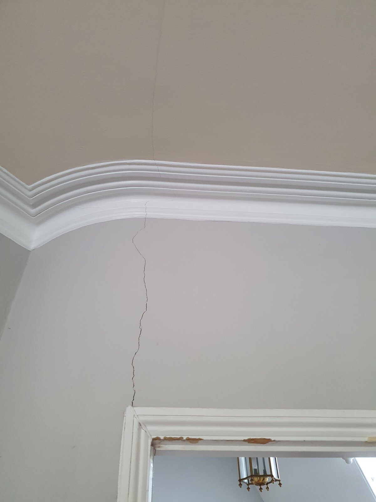

Hello. We are purchasing an Edwardian flat in a share of freehold situation. The other flat (1st) has some long cracks that span the entire doorframe - diagonal across ceiling - corner of door in one area and long dispersed cracks on the ceiling in others. The co-freeholders appear to think it's not a serious problem, but these gaps look sinister. Any advice please?

Are there any cracks externally?
the images could be the result of foundation movement, it’s hard to know.
Given it’s a hundred years old, I’d guess it’s not settlement, but more recent settlement, movement, shrinkage.
Edwardian houses can have just spread footing, sometimes just on clinker. But there is a difference between settlement / movement and subsidence and you probably need a full survey to find out (although they can be awfully vague and these days mostly used as a bargaining tool)
No cracks externally near these cracks, but one side wall has evidence of bracing support and the other side wall has some vertical long cracks and signs of some buckling?
furrykake, good evening.
Difficult to even guess at what is going on? the door vertical crack could be the door slamming
The diagonal wall crack and associated ceiling crack is a possible issue, as far as I can see the remaining images are of cracked old original Lath and Plaster??
From your second post, the [historic] bracing supports? are they circular cast iron?? and your description of the wall " buckling" could indicate Subsidence or, that the wall is bulging, possibly not occasioned by Subsidence?? Bulging of walls, especially solid 9 Inch brickwork, and up here in Scotland masonry tenements, is generally referred to as Lateral Stability.

As for the vertical cracks? do they run towards a chimney? from a fireplace? is so that is a different Issue, that could be Sulphate attack??
