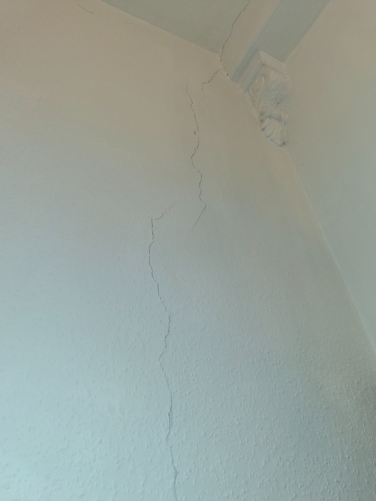

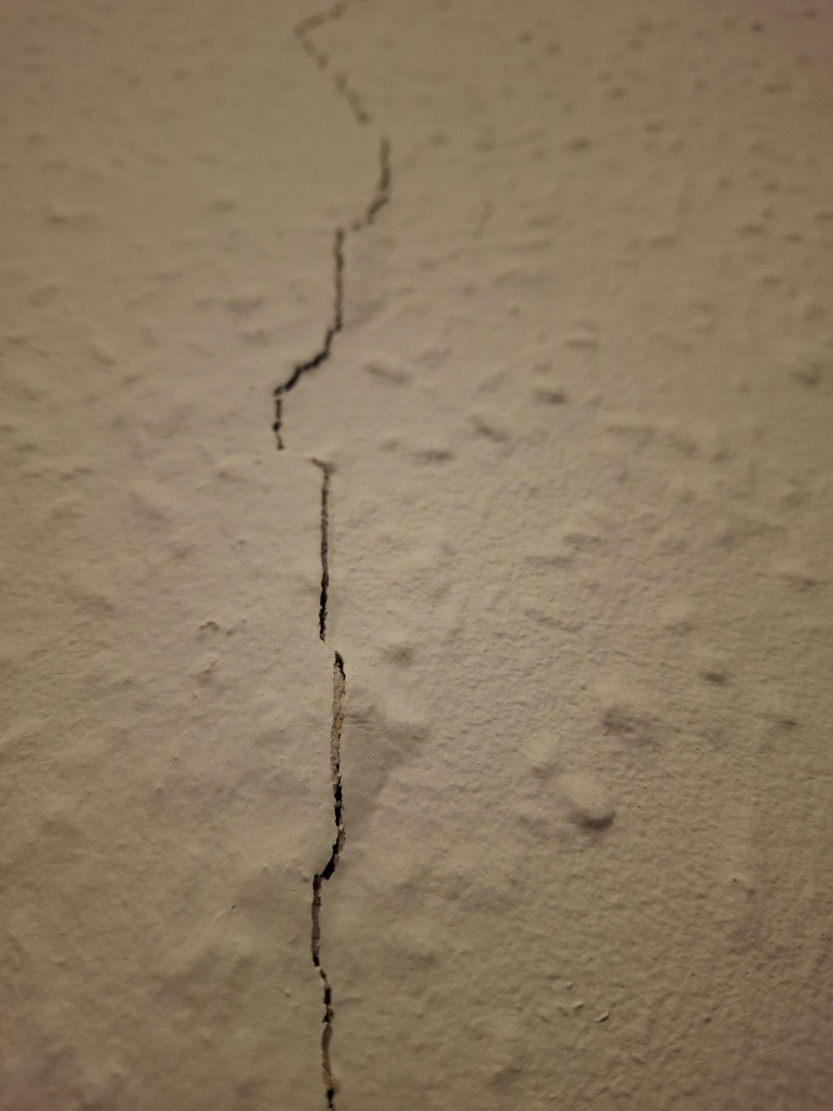

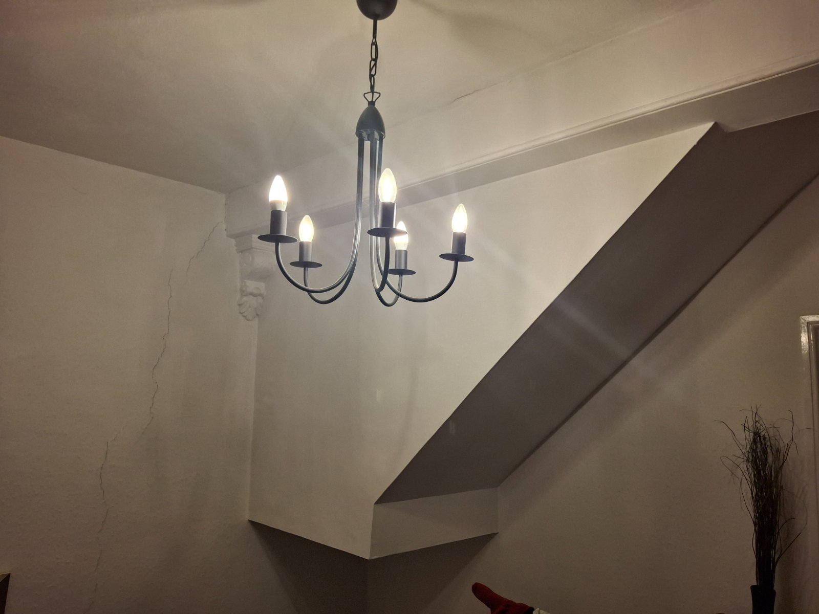

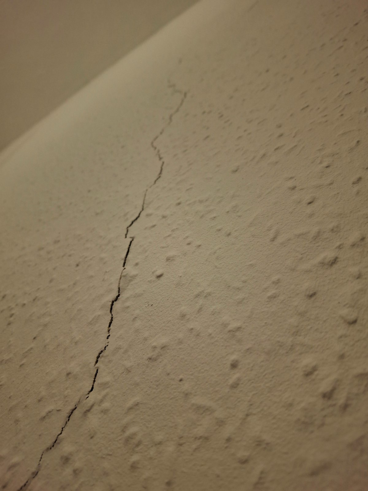

Hello,

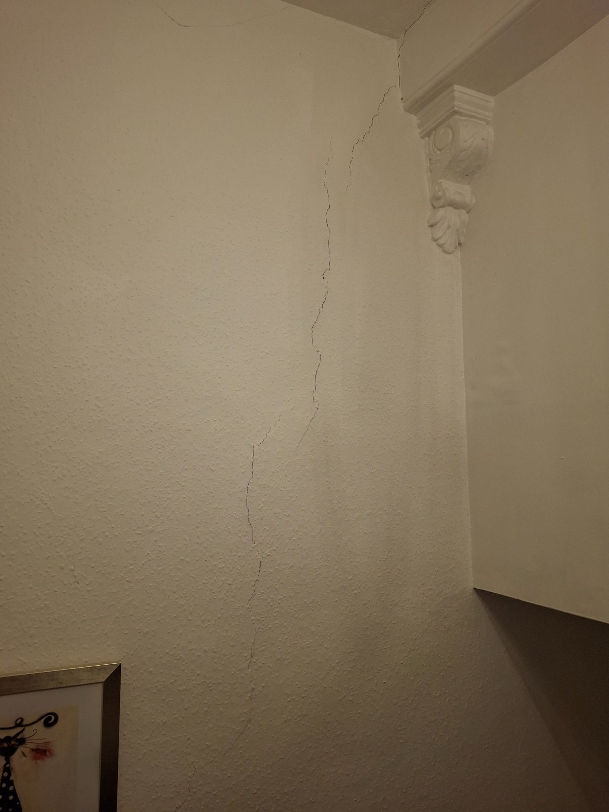

I've got a crack problem.
On my staircase I have a crack which starts at the ceiling from an RSJ and runs diagonally down the wall. It's grown about a meter in the last few years but I've noticed recently that it seems to be getting wider. It's about 1mm wide.
Just wondering what to do about it really. Get a surveyor or a structural engineer to have a look? Or maybe a builder?
I've attach photos but not sure they are clear enough.

OP,
Typically, 1mm-2mm cracks are often not significant.
Is the RSJ supporting a loft conversion floor?
There's shadow near the crack - is it a damp patch?
Is that an external wall? Is it rendered? Any external mirror cracks?
Is it a solid wall or a cavity wall?

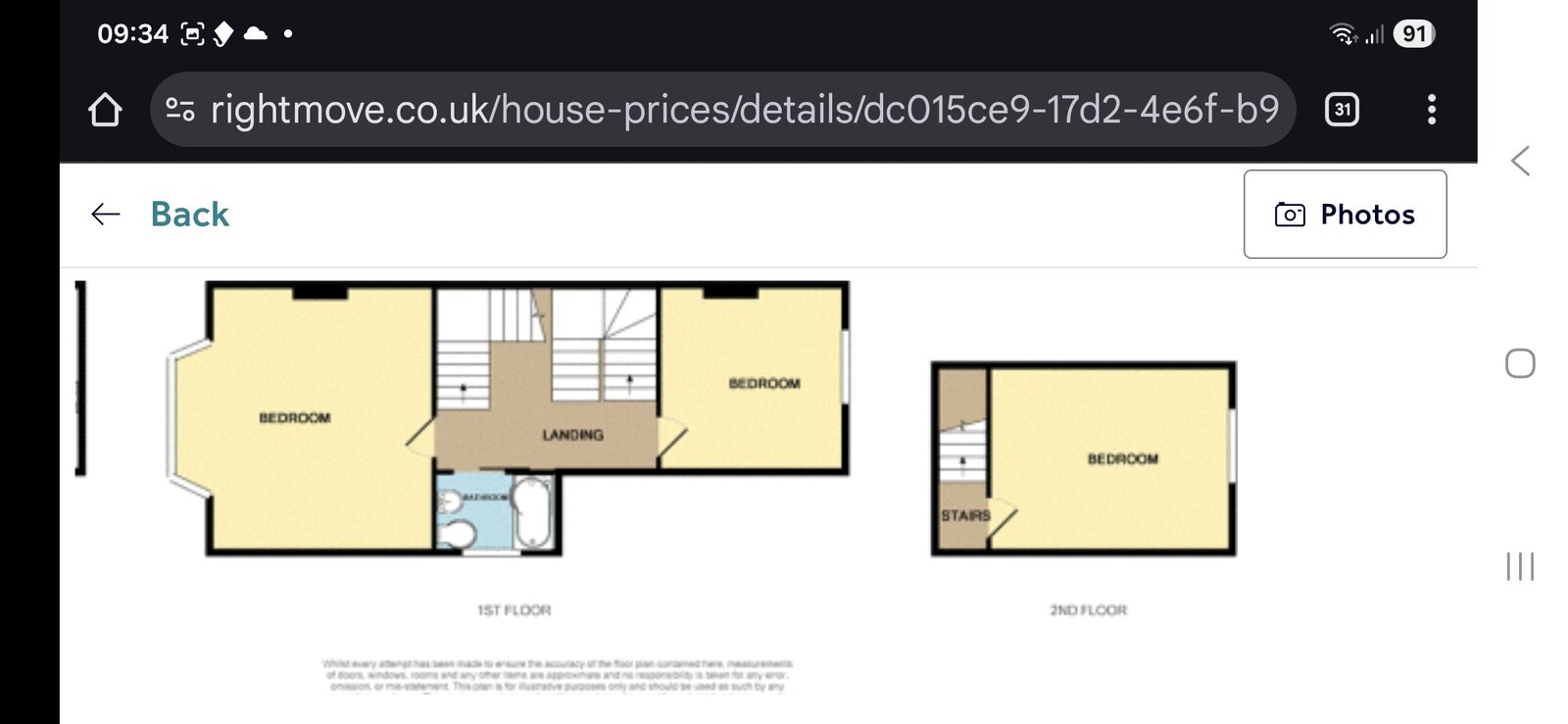

RSJ is supporting a loft convertion which was done in the 70s. Also new staircase was put it, photo attached.
There's no damp, just a rubbish photo and poor lighting.
It's an internal wall between our house and next door.
It's a solid wall, how thick and whether its just bricks I'm not sure.

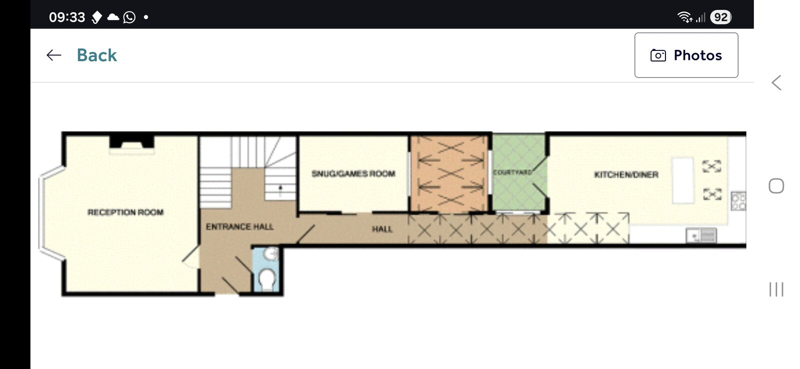

Our house used to be a 6 bed semi, but in the 70s it was split into two, so we are now a 3 bed semi.

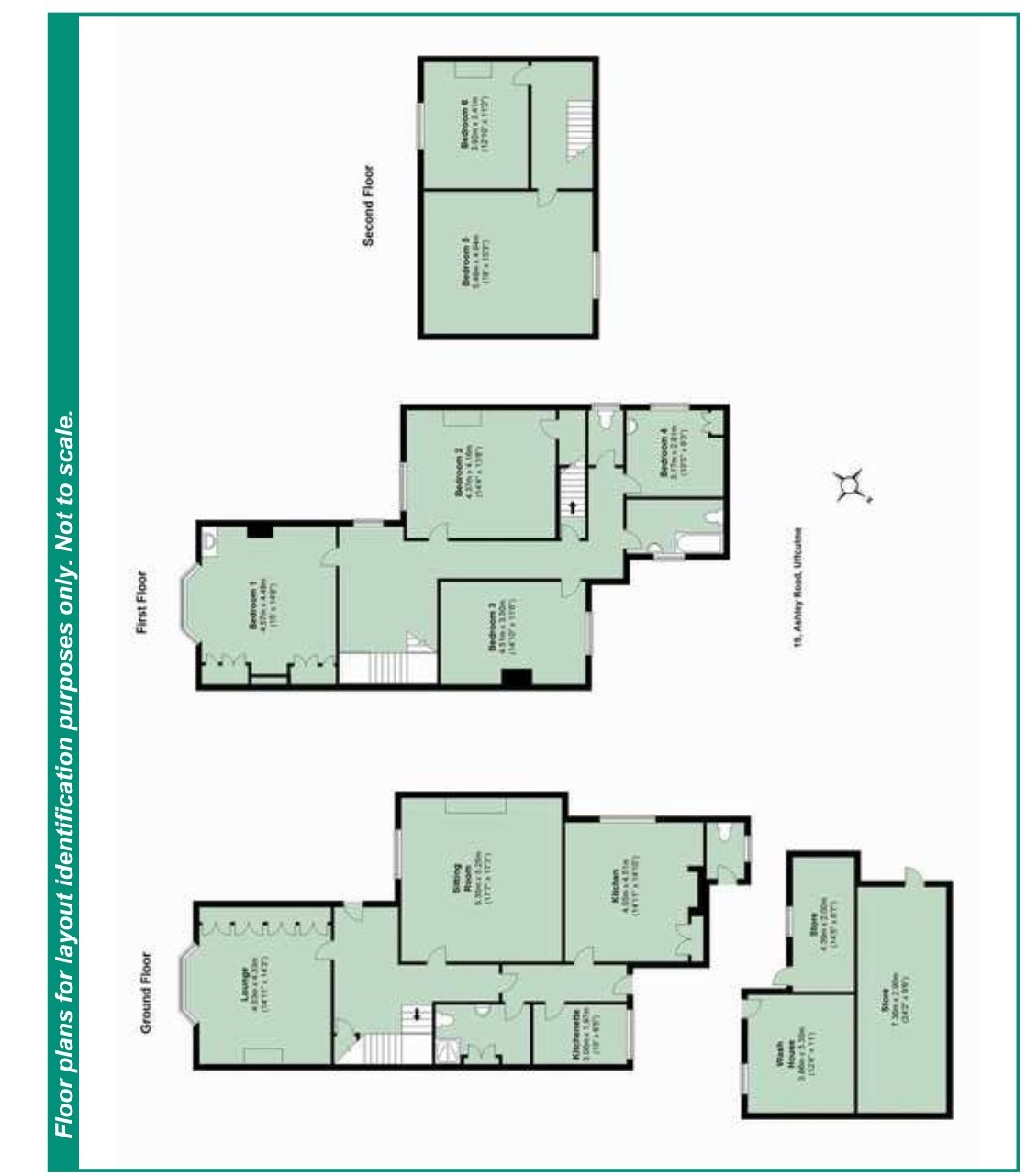

I've got floor plans for next door which hasn't been converted and is still 6 bed, trying to find our floor plan, I'll upload when I find them.

Floor plan of next doors house which is on the left and still a 6 bedroom house.

OP,
Thanks for the last pic & diagrams.
What we do know is that substantial building/structural work has taken place in the original semi - we also know the party wall supporting one end of the RSJ is probably 9" - & hopefully the lintel is supported by a padstone?
We dont know if there are any cracks on the neighbour's side of the party wall?
All the building work took place a long time ago while the crack appeared years later.
So for now why not simply keep an eye on what might be, due to heating & cooling, a typical thermal movement crack with a bit of added lintel/load pressure?

OP,
If you eventually hack out the crack then you could hack a bit further to examine the lintel bearing.
The evenness and verticality of the cracking implies thermal contraction (shrinkage) of the plaster - from heating and humidity patterns. and common.
Chop out some plaster about halfway up the cracking to check the wall behind - 100mm wide x 300mm high section.
Tap the wall in various places around the cracking and elsewhere to check if it sounds hollow and plaster is detached more generally
Check next door
So, just found out there's a similar crack on the opposite side of the wall nextdoor :(
