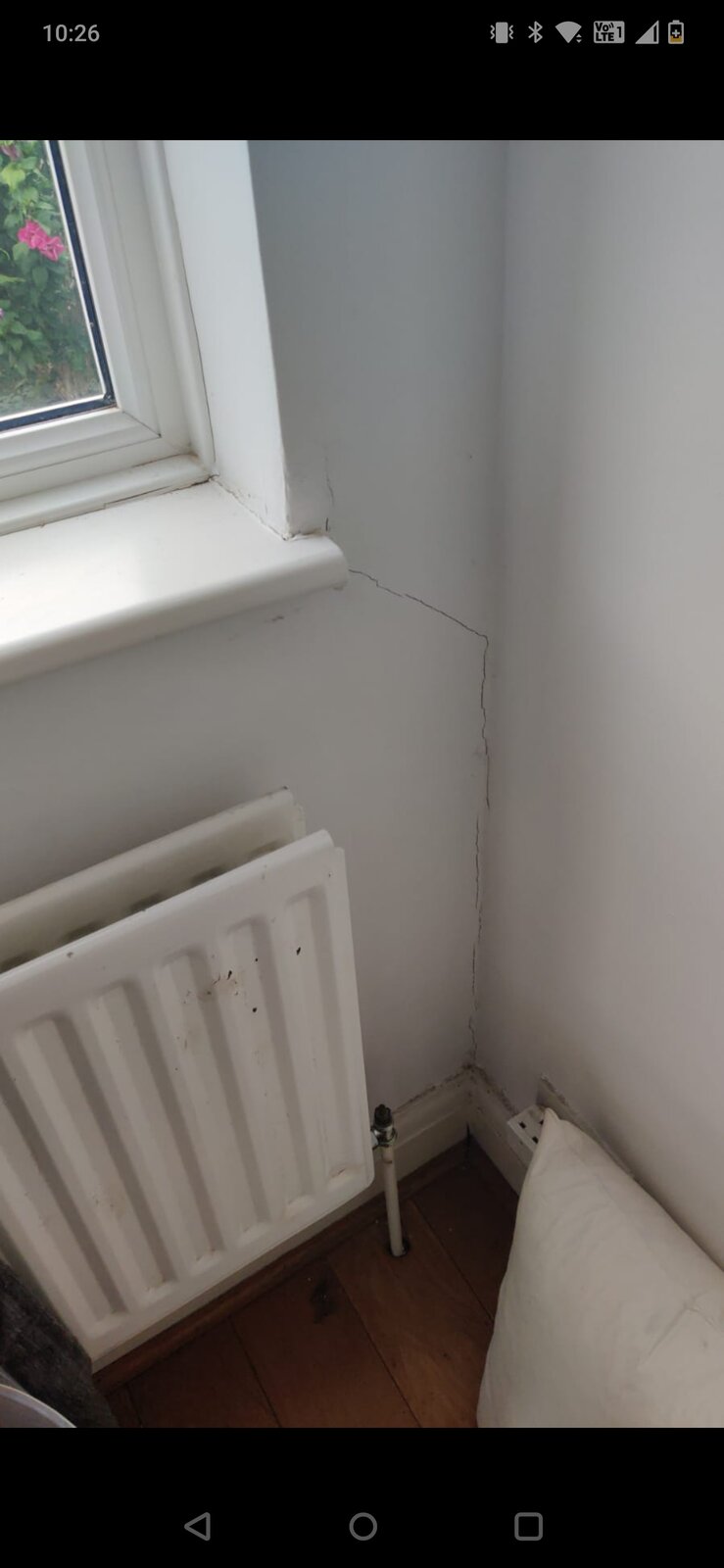

Hi,

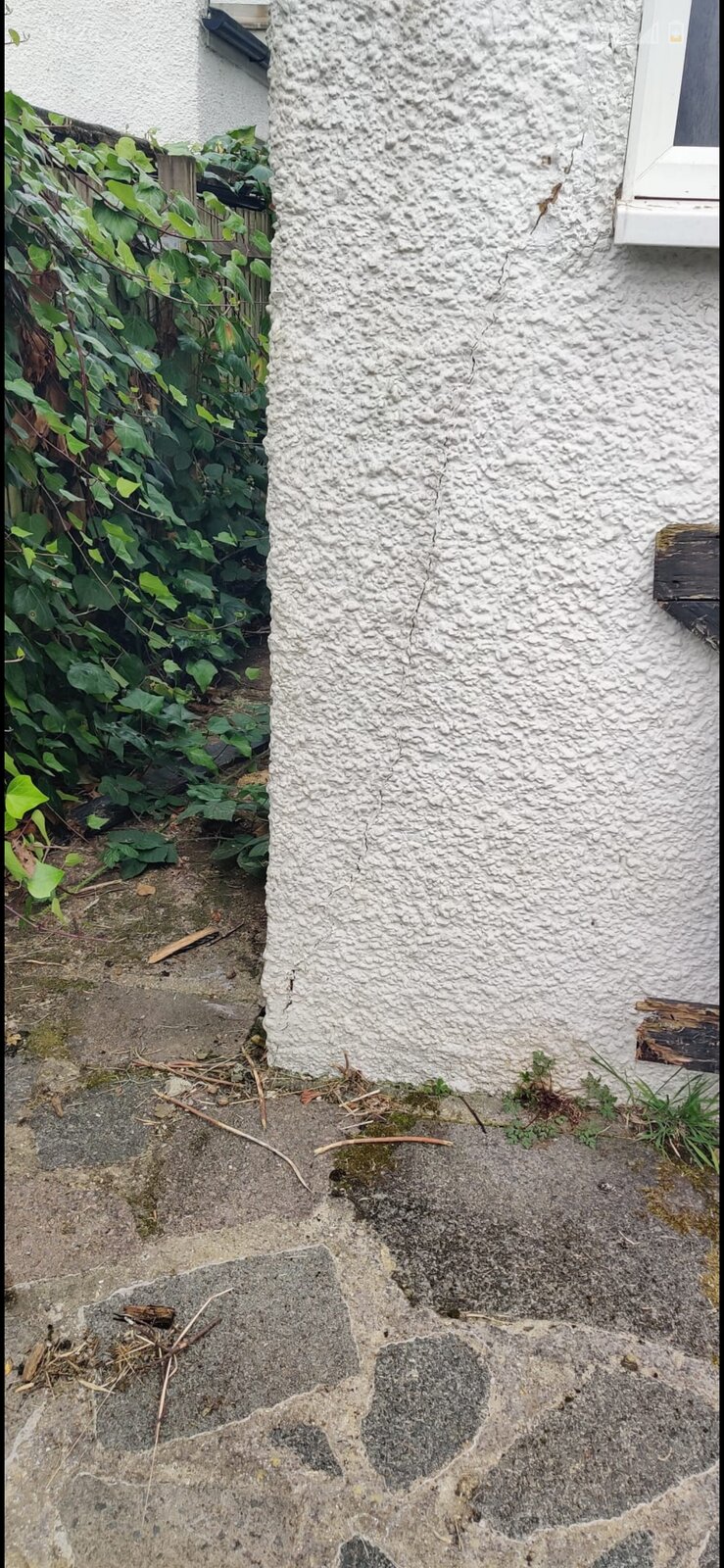

My property has an old extension circa 1985. It's a detached property 1930s and we have a diagonal crack inside with is a couple of mm thick but deep so it is in the brickwork. Outside there is a diagonal crack also in a different location.
I've had a few builders and people say they aren't concerned and to monitor it but I am concerned. I plan to extend this extension to the side also in a year or two and people are saying "address the issue then if it's an issue." I don't have any cracks like this anywhere else in property.
I think I need to get a structural engineer in. Worrying times. What do we think?
Thanks all

Not my area of expertise, but if it were subsidence, I would expect the cracks to be at the top, rather than the bottom.

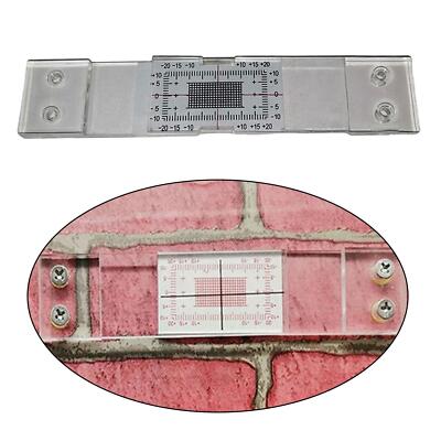

If it really worries you then screw one of these across it on the outside...
I put one on a much bigger crack in my place about 5 years ago, it's not moved a bit so I've stopped worrying about it.
Thanks for the replies. I do have a hairline crack inside at the top but not outside. I think what worried me was the cracks are deep inside and out. The blocks are thermalite inside.

Internal: you’ve got a reasonable panel of blockwork across under the window which joins a narrow full height bit of blockwork…..not surprisingly that’s a stress point from the corner of the window.
Externally it’s cracked on the render, impossible to know without investigating whether it’s just the render or the blockwork / brickwork. If it was the blockwork It’s more common to see cracks tracking along the mortar lines than just diagonally, depending what blocks they are.

Hi, I think outside it is the brickwork too I was able to insert quite deeply a scraper used for filling gaps at the bottom same as I side. The bricks are thermalite bricks. This is what's got me concerned.

There appears to be a sand & cement fillet at the base of the outside skin - why?
Render should stop just above the DPC bed - it should finish with a Bell Cast.
The external crack, as it is, could allow moisture penetration to rust the corner metal angle bead.
Rusting beads swell & blow the render.
