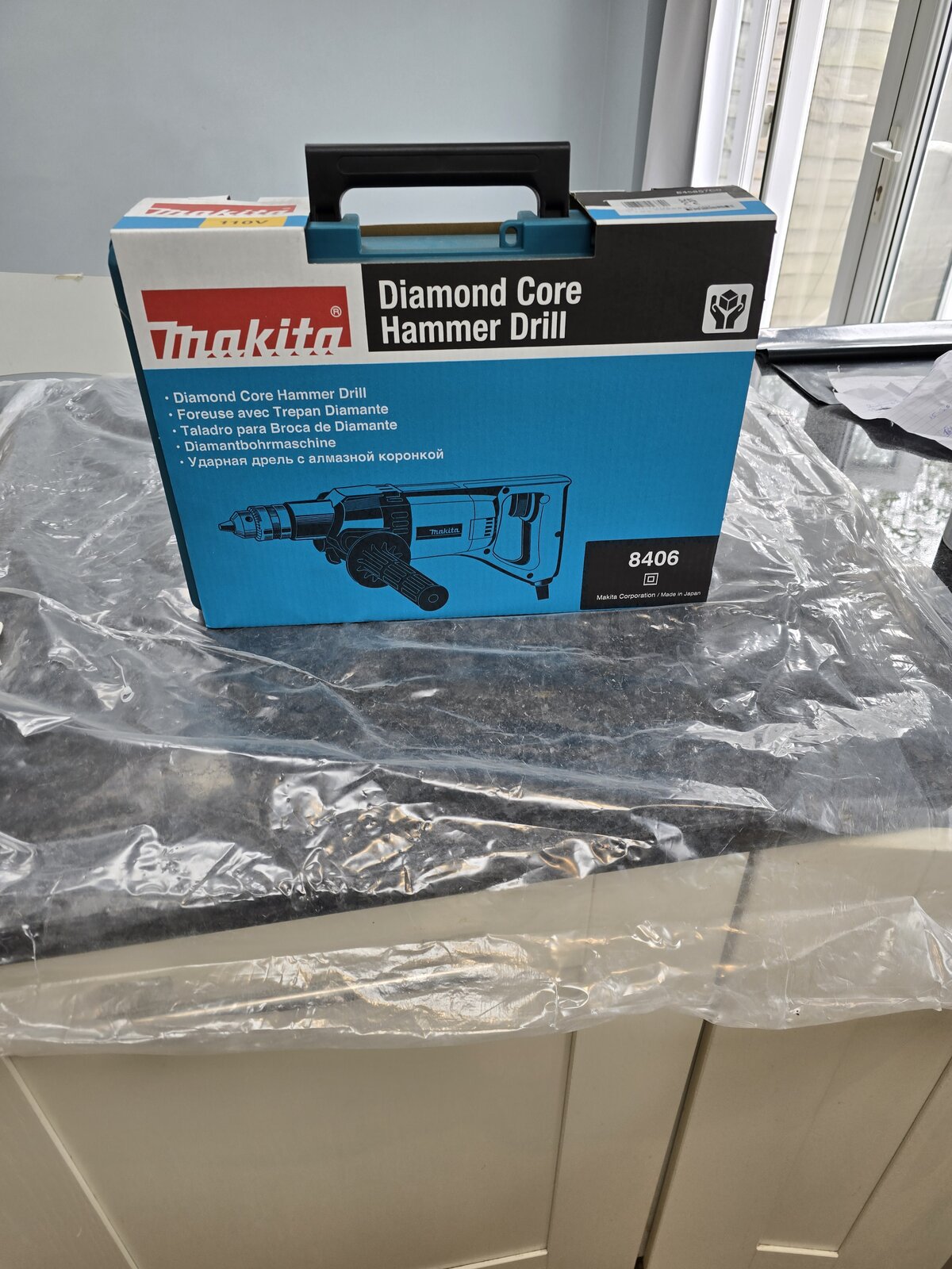

I went to ITS this morning with the view to spending £575.00 on the top most powerful Makita.
However it was alot bigger and heavier.
So I went for the £287.00 lesser model.
It's what I had before.
I only had a 1½ hole through brick but it was smooth and effortless. Far better than the Dewalt that's roughly the same price.
The bigger test will be 127mm. But the 1½ the clutch worked as I could of only hoped.
Watch for more comment but so far I would recommend for price and performance. View attachment 375723
I've got this exact model, I've used it for 6 inch core holes. Often it's a combination of substrate and core bit, cheap core bits are cr&p, if your coring wet brick then it's awful, if your coring flint you need this drill, 2 core bits and a bucket of swear words. I core five inches into engineering brick, I used the hammer function...
