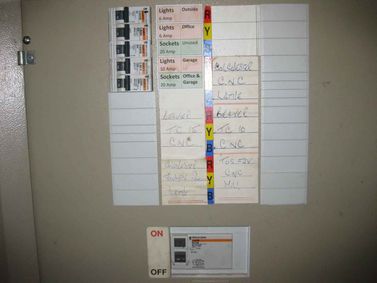

All, I have a Merlin Gerin distribution board in my garage.
Some 12 years ago I believe that the distribution board was set up as three phase as the then owner of my house had a small tool shop in the 5m x 10m garage. And I believe 10 years ago the three phase was reduced to one phase and 6 MCBs put in for the lights and plug sockets for the garage and ‘office’ (actually a section of the garage he set aside with a stud wall).
For details there are following circuits in use (I went into garage roof to check the cables)
A) Outside Lights, 6Amp MCB, C60HB…….Radial Circuit using 1mm2 T&E cable going to PIR and three outside lights (180W).
B) Office Lights, 6Amp MCB, C60H…….Radial Circuit using 1.5mm2 T&E cable going to 2 Florescent lights (140W).
C) Unused/NC, 20Amp MCB, C60HB…….No circuit, no cables
D) Garage Lights, 10Amp MCB, C60H…….Radial Circuit using 1.5mm2 cable T&E going to 13 Florescent lights (1000W).
E) All the Sockets, 20Amp MCB, C60HB…….Two separate Ring Circuits (one to office one to garage) using 2.5mm2 T&E cable, going to 8 Sockets in Garage and 4 sockets in Office.
I only use small power tools and the lights and not had any issues with the garage, but I wanted to know why I have “C60HB” and “C60H”. So my questions are:
1) I know what a “Type B” MCB is and I presume that this is shown by the “C60HB”, but What Type are the MCBs that say “C60H”?
2) Why are there two types of MCB in use “C60H & “C60HB””?
3) Should I get the MCBs that say “C60H” changed to be type B (C60HB) so they are all the same, or the reverse, or simply ignore as all is working?
Thanks, SFK
Back in the past MCBs were denoted "Type 2", Type 3, etc depending on their characteristics.
A new standard for MCBs came into play on 01/07/1994.
The standard changed from BS3871 to BS EN60898.
Manufacturers were allowed to continue production at the old standard untill 30/06/1999.
For those 5 years, the MCBs could be made to either or both standards.
The trip times of the MCBs are different, and they sometimes overlap.
Type B equates to Type1/2.
Type C equates to Type2/3.
Type D equates to Type 4.
You can see this by reading the MCBs in your photo!
Type 2 is the samish characteristic as B. You will only be able to get B curve MCBs today so HB is what you need.

Dear Taylor,
Thank you for that explanation.
Perfect and simple ...... Type 2 sameish as Type B.
Sounds good and makes me happy as gives me confidence that all have about the same response.
The only unanswerable question now is why someone put two Ring Circuits into one MCB when there is a spare/unused MCB.
Thank you again, SFK

As the MCB is 20A, it does not matter whether the circuit is:
One ring (joined in board), two rings, one ring and two radials or four radials.
All are suitably protected.

And my apologies. I hadnt looked at the photo properly. As EFLI says. The socket MCBs are 20A, so everything is properly set up, unless you need to pull more than a total of 20amps on a socket circuit!

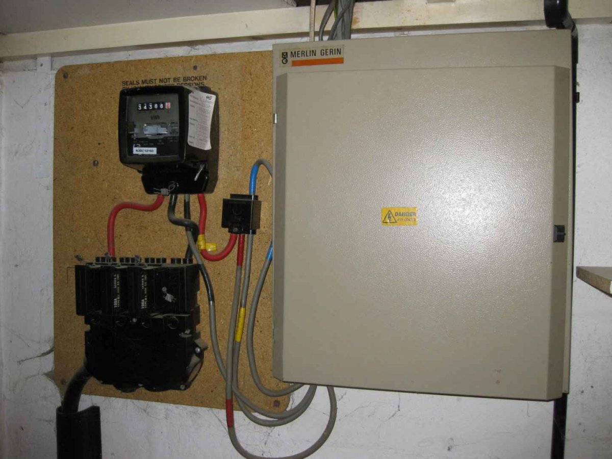

With that loading, you can probably run it from your house, and cancel the dedicated Garage supply, and save one set of standing charges in the process - the charge for a 3 phase supply may be higher than normal single phase feeds.
Is the system earthed? - Notice the lack of earthing cables?
Possibly TT. Can't quite see the mA of that RCCB but chances are it's 100mA
Kai,
With thanks for the suggestion regarding running cable from house. However cheaper not to bother as I am on a cheap standing charge, and unfortunately would be prohibitively expensive and disruptive to run a new cable though house and under patio.
I seem to remember that there is a earth spike (is that right name) in ground on other side of wall with a earth cable leading towards box, but i will add it to list of things to check.
Thx, sfk
