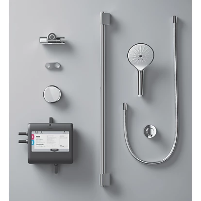

SWMBO grumbles about our thermostatic shower (fed from the combi) and has got wind of digital ones.
Given the heads in our current shower do the job and I have plenty of space to fit/hide the pump part, a) is it possible to just buy the pump/controller and retro fit b) does it work out cheaper buying the entire thing and binning the chrome parts?

If you have a combi, you cannot pump the boiler's output or fit a pumped shower. Only pump you could use would be a mains pump, if the cold mains is really poor.
Her gripe is mainly setting the temp since I like cooler showers than her.
Water pressure is fine, and I spotted Mira do a digital for higher pressure/combi which is why I asked the orginal question.
They do yes, it isn't pumped. They do a Mira Platinum, Mode and Activate. Not cheap though but very good, I have a dual feed Activate.

There is no actual pump. There is the mixing valve and controller. Are you asking whether you can just buy those and fit to your existing shower heads?
