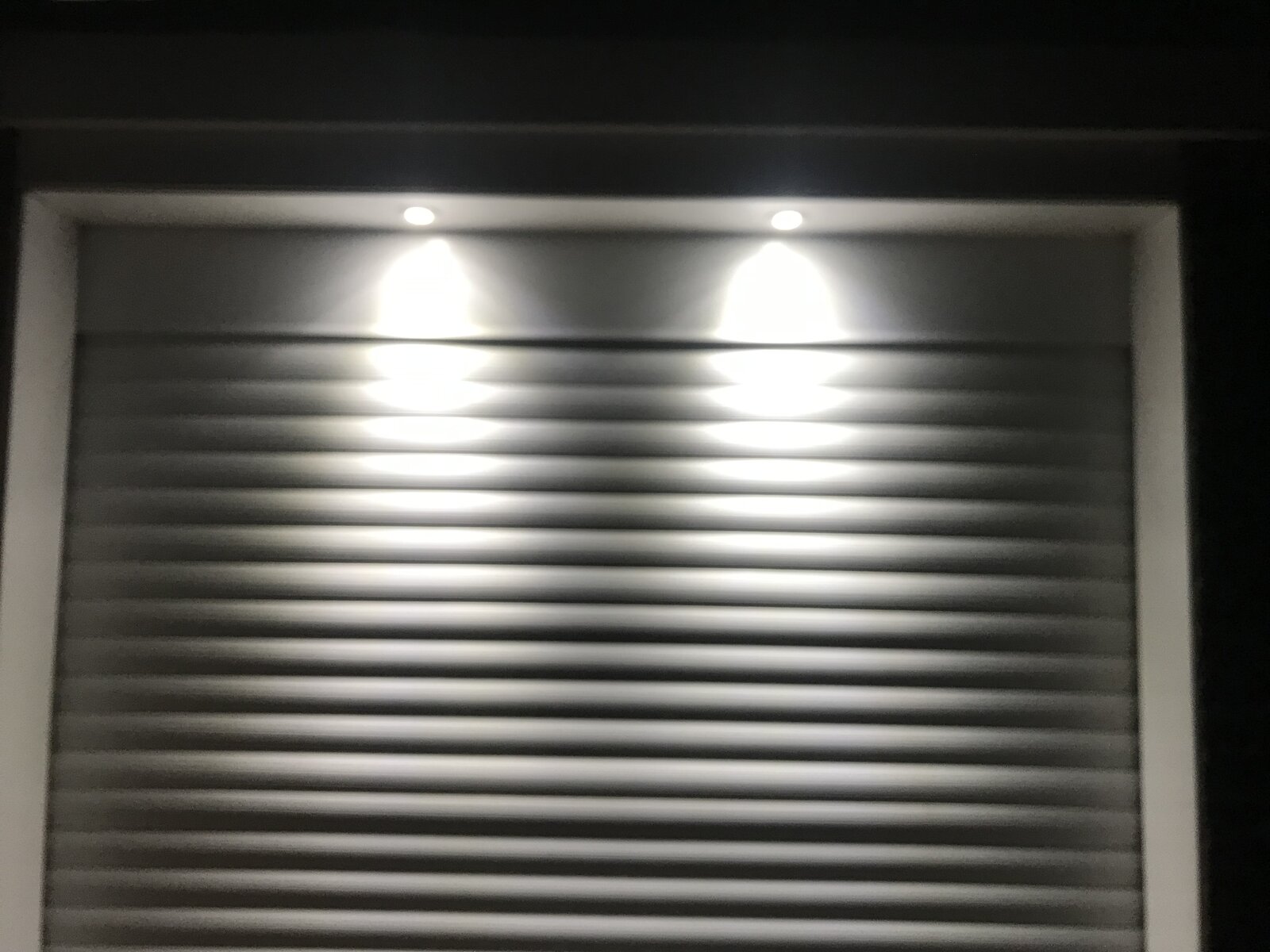

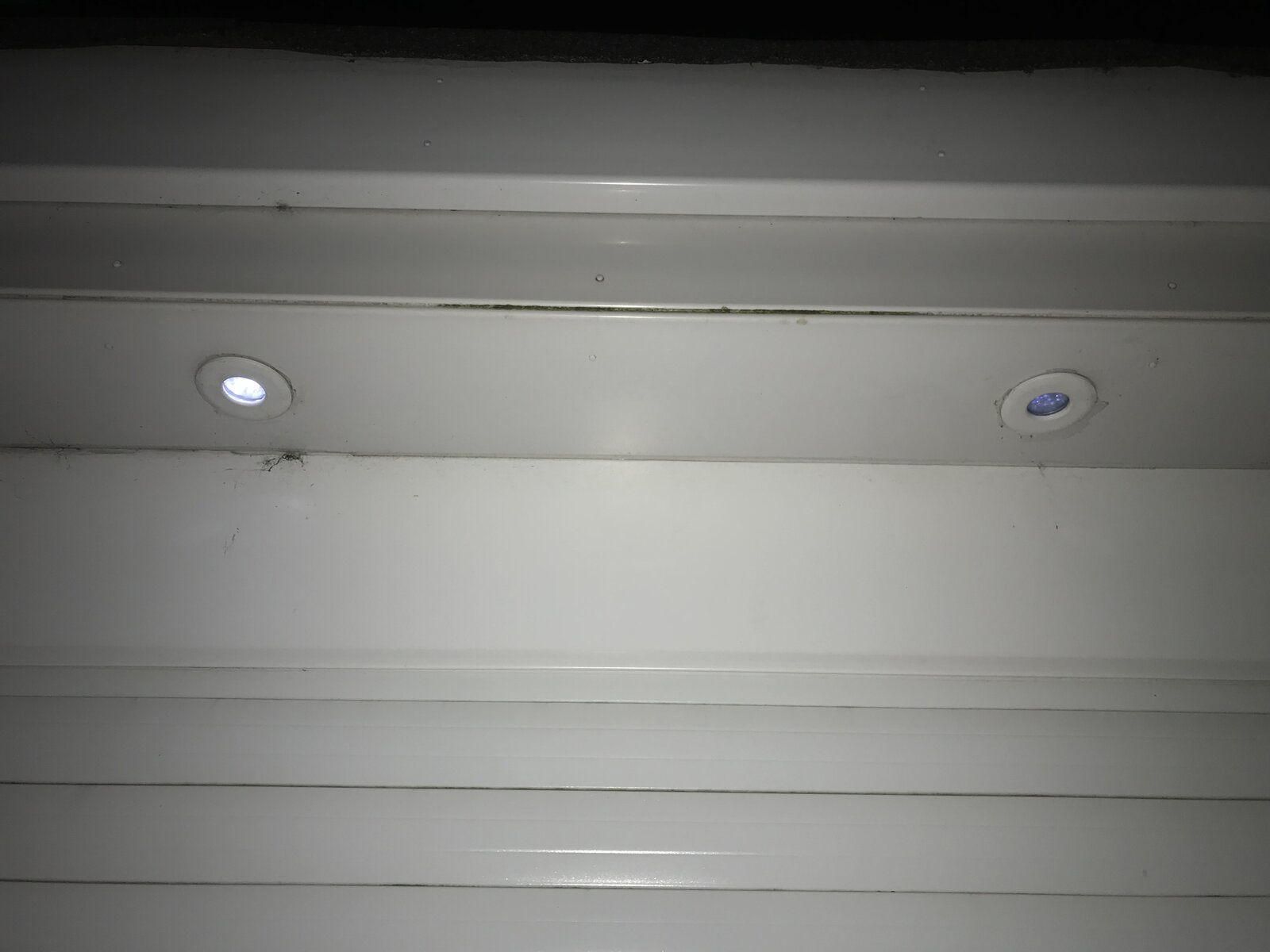

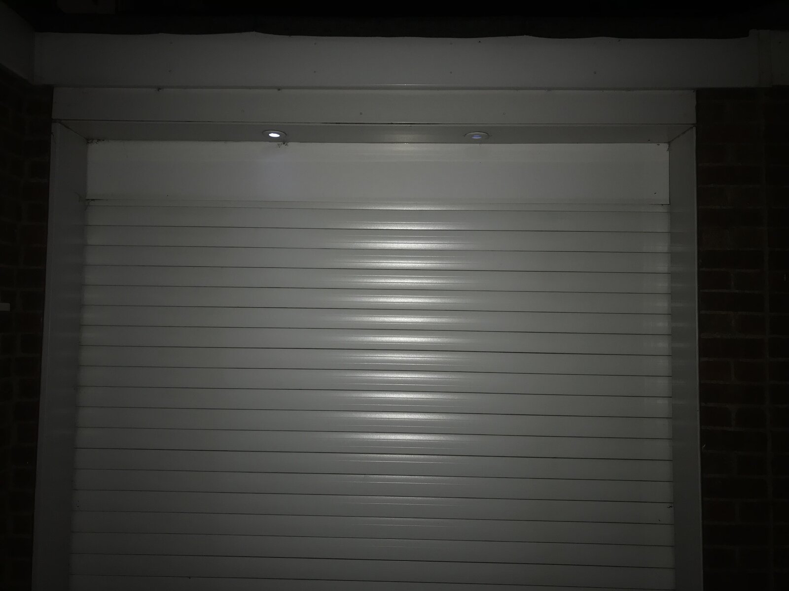

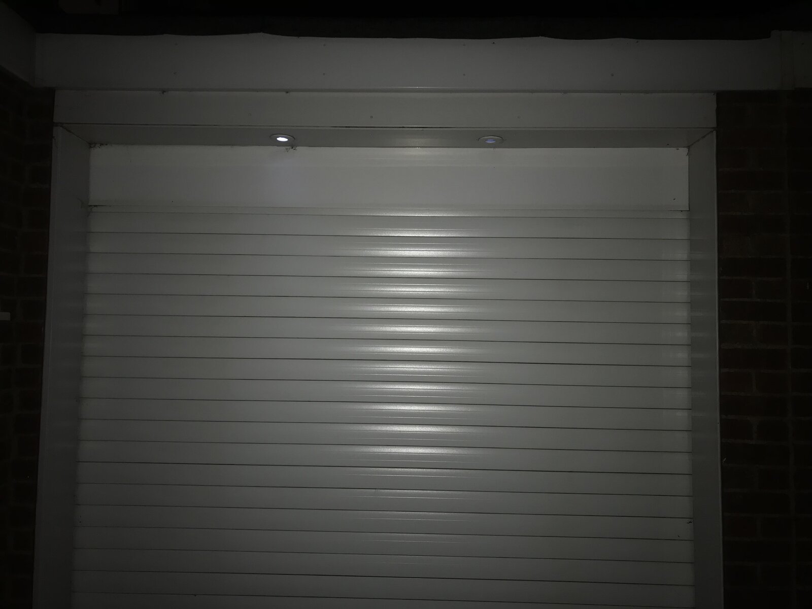

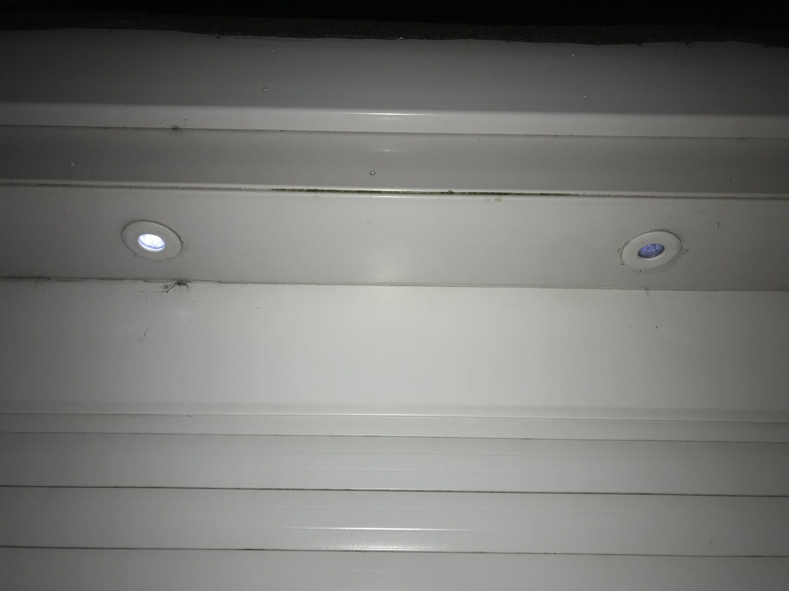

I’ve got two integrated led downlights over my garage door. They’ve been up for 3.5 years. They are fairly low wattage but I’ve noticed that one is dimmer than the other? I’m hoping that this can be seen in the pics.
I’ve given them a good clean.
Do they need replacing or is there anything else I could try?
Thanks in advance.

Often a sign of the Driver failing, you can often swap just the heads with each other, to test, this will show if its the head faulty or the driver.
Dont leave head unplugged with the power on though as may damage good driver.
Drivers you can buy separate, though it may be easier to get the whole unit, or two to match

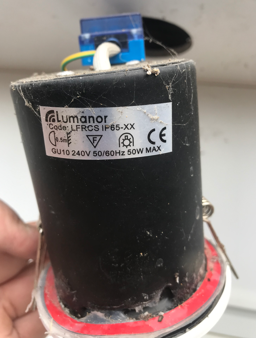

This light is run off the mains and doesn't have a driver.
I was hoping that this code will allow me to check the spec (wattage, lumens cut out size) but can't locate it.
Can someone please advise on a suitable replacement. I will need a pair as I will switch out the working one too to ensure they are consistent. Also, this light is connected to the other light and gets it's connection from that. The loop is at the other light. Hope that makes sense...
Thanks in advance.
What you have in your hand is a weather protected (IP65 rated) enclosure for a GU10 bulb.
You should be able to undo the enclosure and get the GU10 bulb out.
Details of the bulb should help you choose the new ones (best to replace both!).

It would seem the power supply in the can will supply up to a maximum of 50 Watts of power to what ever LED ( or other technology ) lamp is fitted to it.
The lamp determining how much power it uses.
The main cause of LEDs going dim is the slow destruction of the LED element by driving it above it's safe maximum power dissipation.

Think you are worrying too much :), 3.5 years for a Led Gu10 lamp is not bad.
Technology is better now, change both lamps and they will likely match.
The led has such a wide supply voltage not sure an extra few metres of cable from the first light would make any difference.
You could just open both fittings and swop the 2 lamps over and the dim bulb will likely still be the same in the other fitting.

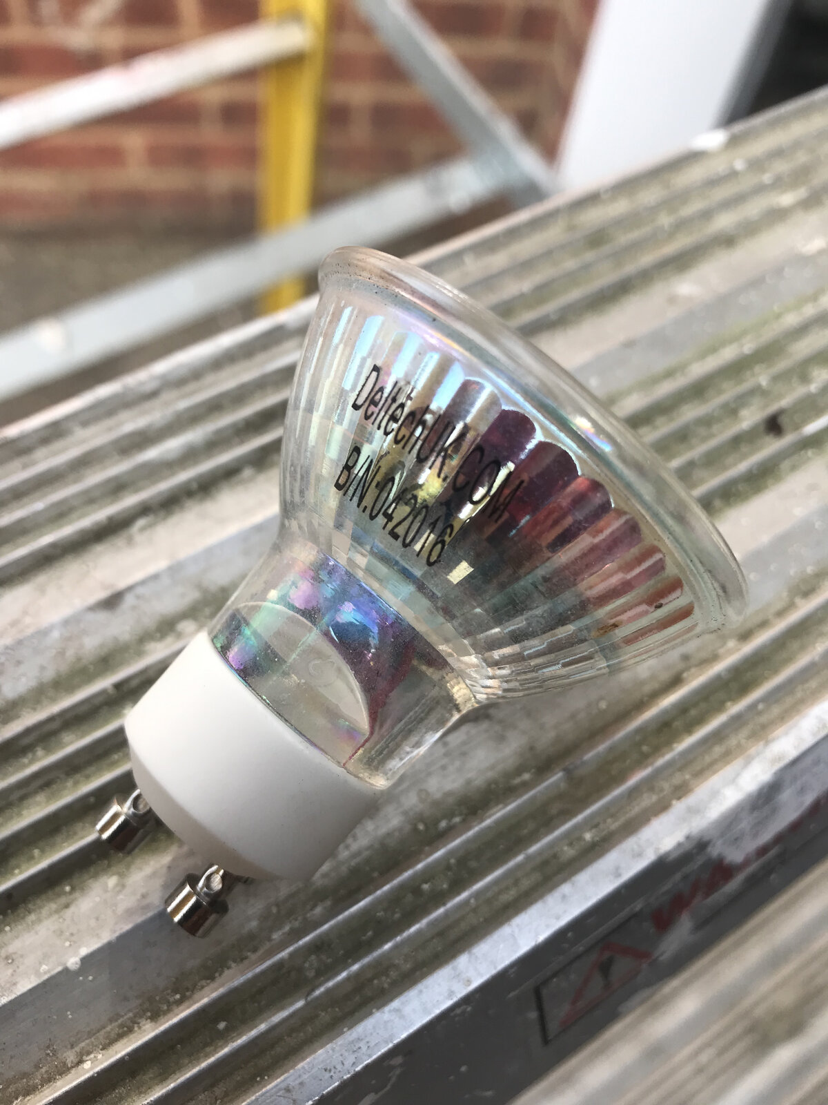

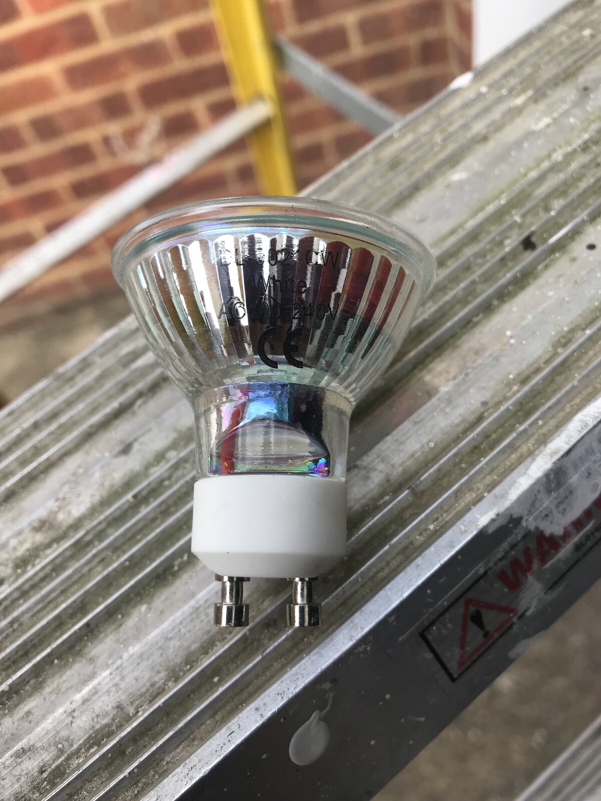

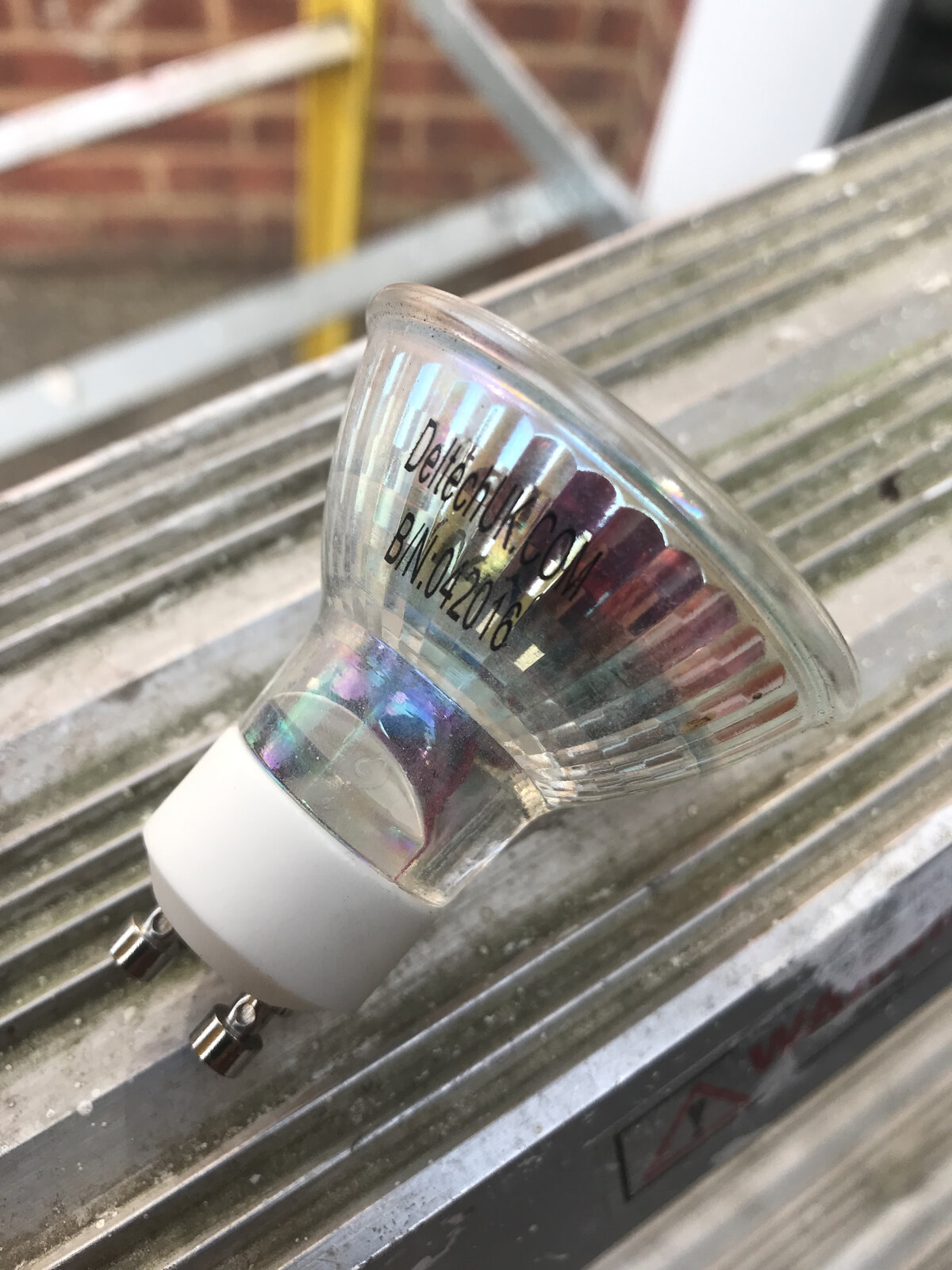

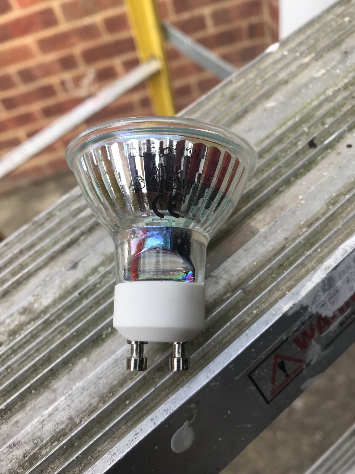

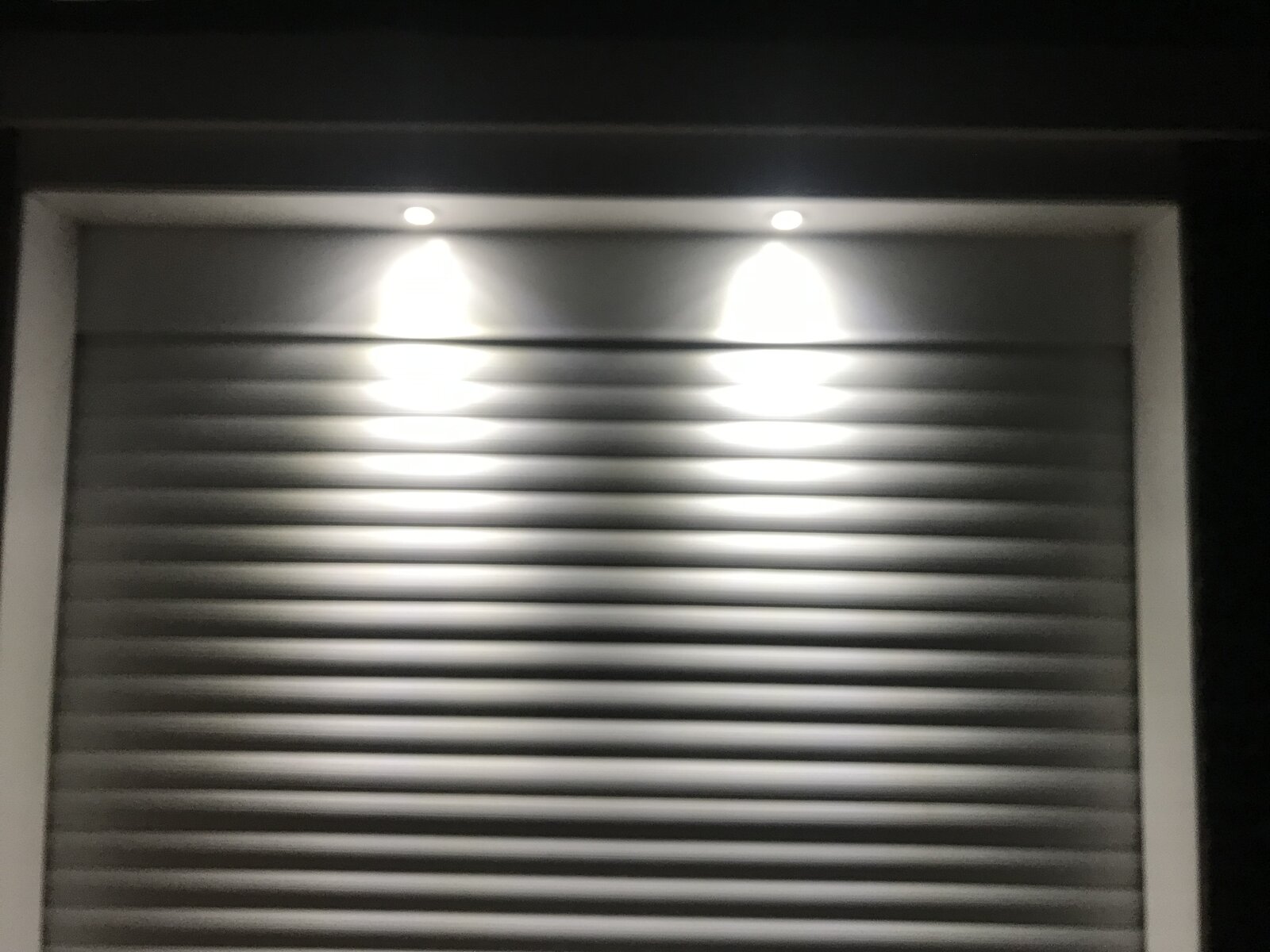

UPDATE - I replaced both bulbs with a new led bulb today. As soon as I did this, I can see that both bulbs are equally lit now.
Presumably, this confirms that I just had a dodgy bulb and the wiring is fine.
Thanks for your help and this turned out easier than I first anticipated. It’s been bugging me for weeks!
I’ve included pictures of the old bulb too.
