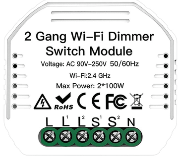

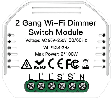

Not necessary, no standard lightswitch dimmers require a neutral and never have.
Wonder what the 'N' stands for? I would agree British made dimming switches did not need neutrals, but not all switches don't required them.
To be frank I don't like the concept of forcing the installer to use one line supply, I know my 4 gang switch has two independent circuits, so the line feeds can't be combined it would cause a borrowed neutral. But the Moes switches are cheap, so are fitted by many DIY'er.

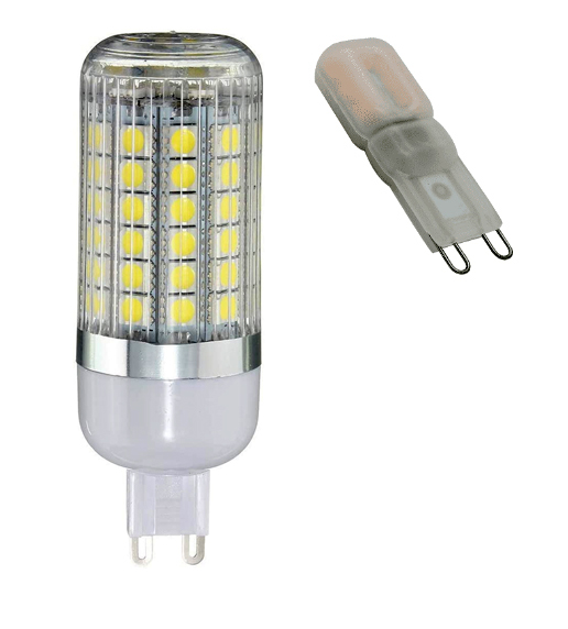

So no longer are they designed not to need a neutral, unless aimed at the British market, and also the bulbs are not always designed to allow current through them to power the dimmer, bulbs need to state if not dimmable, but not if dimmable using a neutral less dimming switch, in fact any electronic switch, so we have as I found to my cost bulbs which simply don't pass through enough current to work the electronics in the switch. Little one G9-comp.jpg would not work without a shimmer or flashing the large one would, but technically the large one is not permitted in the UK as not marked as to watts or lumen output. Except for really small bulbs like G9 and when controlling many bulbs the best option seems to be the smart bulb, that way you also get some ambiance as the colour can also change.
I do not understand exactly why some bulb/switch combinations work or don't work, 4 of the little bulb shown and one quartz tungsten and the electronic switch worked OK, but even with the load capacitor to stop flashing when switched off, using 5 of the small LED bulbs caused the combination of electronic switch and bulb to shimmer when switched on, even swap one of the small LED's for one large LED and shimmer stopped.
So hard to blame the problem on either switch or bulb, it is the combination that causes the problem. But the suck it and see method of selecting is clearly a problem.
