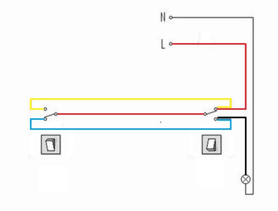

Firstly, you have been looking at American sites. They call the switches 3-way because they have three terminals.
We call them 2-way because they have two switching positions. This is what you have.
Anyway, to do what you want you need 2-way dimmers.
Perhaps you have but have wired it incorrectly.
Post a picture of your dimmer connections and wiring.
This is what you have and you have put the dimmer at the left switch.

Assuming the information provided so far is correct, the only possible fault is that the single switch is busted.
Any loose wires or wrong connections would result in the dimmer not working properly.
There are a number of ways to wire dimmer switches, one method is to use three core and earth to switch and either use ceiling rose as junction box or fit a junction box. But however it is done non electronic switches need three connections on both switches. Your only listing two wires to second switch this can't work.
EFLImpudence has shown how normally wired.
The red centre wire with standard switches goes to Com and with electronic to S you need a master and slave to use S can't use a standard switch.
There are some specials with electronic switches which will work with two wires, so with electronic you must read the instructions, they are not all the same.
Thank-you all for your help but I have managed to figure it out. The two red wires in the dimmer were cross connected. I swapped them over and all now works fine.
