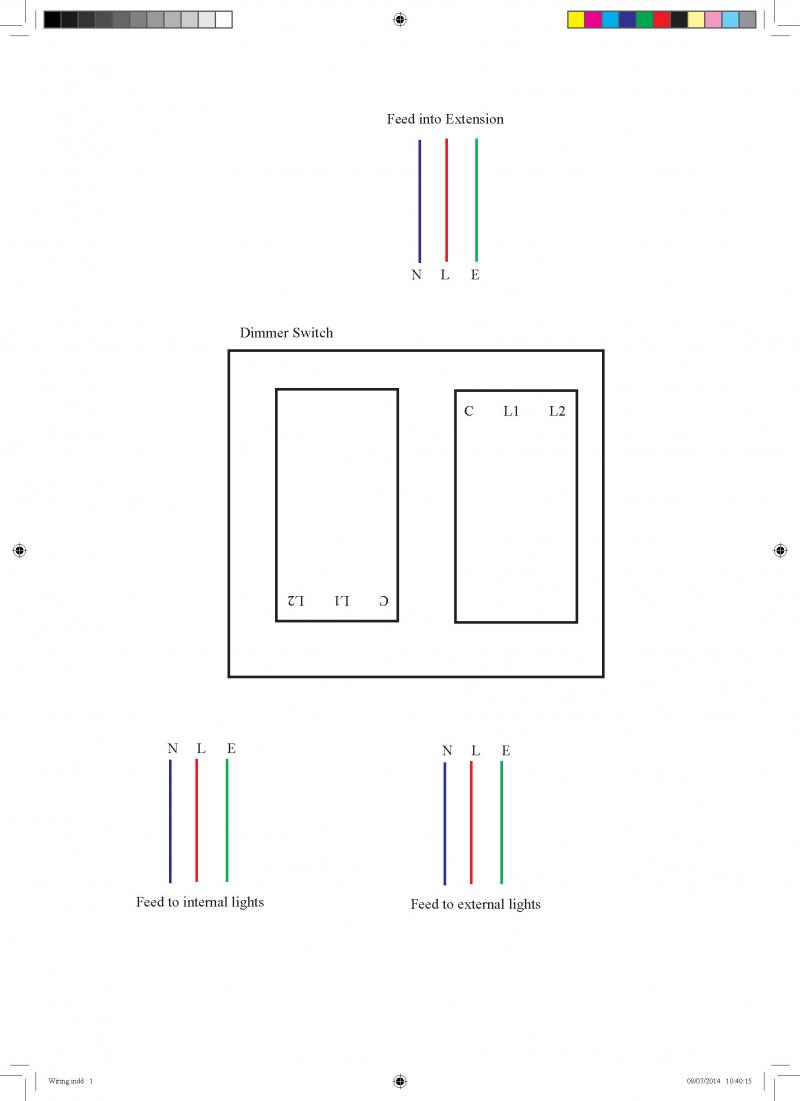

Hi,
I'm in the process of finishing my extension and need some advice of the wiring of a double dimmer switch. I've got a twin and earth feed coming in from a fused spur, to wire the internal and external lights - see digram, can you tell me what where the neutral and live coming in should go in relation to the C, L1 and L2?
Well you don't switch the neutrals on lights, so the 3 neutrals are joined together and push back into the back box.
The earths are all joined together. There is a terminal in the metal back box for this. If the front is metal this should be earthed too.
The incomming live goes to COM (common) and a link wire across to the other COM for the other switch.
The live out for one light is connected to L1
The live out for the other light is connected to L1

Andy,
Thanks, great help - and yep with missus went with an old school type external light, which takes a standard bulb.
