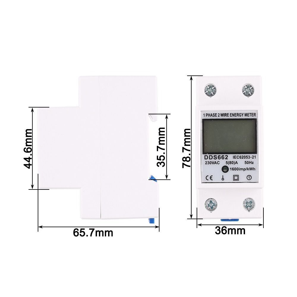

I have read, with interest, some previous posts on this subject. This prompts me to ask if anyone could give me a brief description of how these units work? Does the current being drawn have to go through the unit or does it sense the quantity indirectly (maybe strength of field generated)? In either case how would the unit be wired into a standard consumer box. It would be interesting to see what the recorded value is compared to the supplier's main meter!
Although my interest is focused on measuring the power consumed through a consumer box in my barn. This controls power to workshop tools, floods, and external camper vans.
Any information would be appreciated.
regards. Chas

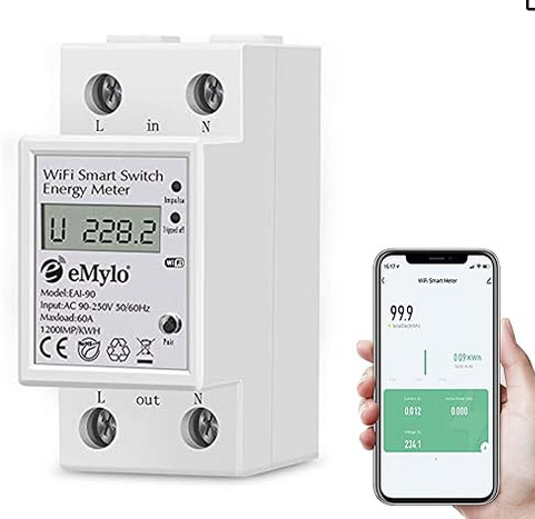

These 1696280403488.png can be used, this one rated 5 mA to 32 A there are also smart versions, 1696280856547.png but it is not how they work, but if permitted in the consumer unit you have. This 1696281174318.png Wylex one has a £324 price ticket, and still states

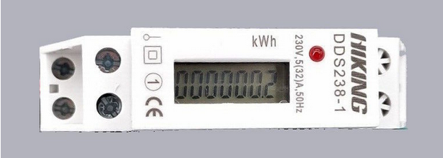

Your diagram is of a "2-module-wide" one, which many of them are, but there are all plenty of "single module" ones (17.5-18mm wide) available.
Kind Regards, John
It is, do the single module now fit in a cu, they didn't used to.
I assumed that they did (fit in a CU). Indeed, I have always assumed that they did in the past, since I thought that was 'the whole point' of most of them - but perhaps I was wrong!
In what sense/manner did they "not fit". Many current ones look very similar (shape/size-wise) to MCBs, and some not as tall as an RCBO.

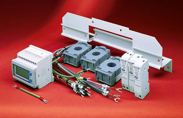

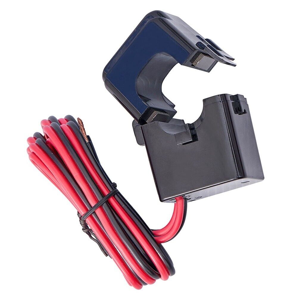

It Depends. ericmark linked to one that uses current transformers [split cores that clamp around the conductors], other ones are "invasive":
... Does the current being drawn have to go through the unit or does it sense the quantity indirectly (maybe strength of field generated)? ...
Generally these units up to a fairly minimal current (say 5-16A continuous but don't take that as a quote) will go through the meter, anything over that will have a current transformer added around the current carrying wire, as an example a 20:1 will make a 5A meter into a 100A.
Different arrangements exist (such as current to voltage) but that is the basic principle of current transformers.
Devices designed to mounted in a panel/enclosure such as these as an example:
Seem to standardise on 5A continuous (again gon't quote me) and will require current transformers to read anything higher, This one is 200/5A:

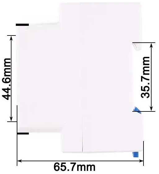

I haven't handled a narrow unit for a number of years but they tended to not have the 45mm limit to fit the standard slot, excuse my crude buchery as explanation:
Any disply screen tended to be mounted sideways and extend beyond the 45mm whereas the 35mm wide didn't have the issue. I dare say there will now be a plethoral of 'what about this one?'
And of course not all MBC manufacturers lined up the din rail and the 45mm slot the same although I haven't encountered that issue recently.
