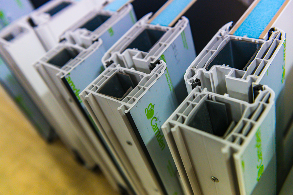

Here's a photo from the manufacturer's website. There's no guarantee it matches my product, but what does everyone think of the design?

the Camden group say:
A rated performance as standard.
90% argon gas fill
warm edge spacer
the test results for their 70mm casement windows is 1.3 u value, glass u value is 1.219 and g value = 0.71
air leakage = negligable

They make grand claims, they do. Their reviews are not so nice. Can a spacer really be a warm edge spacer if it's alu?
