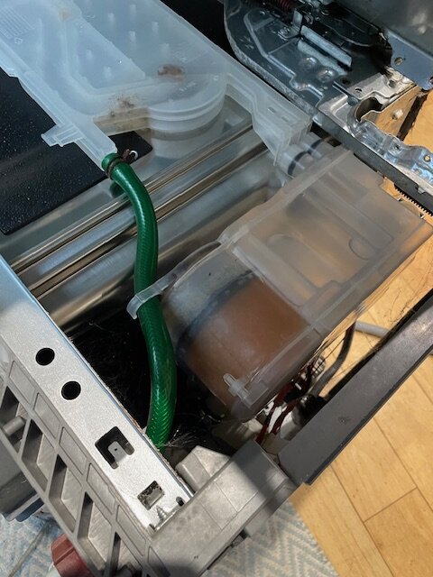

Dear all my dishwasher stopped heating water and trying to find the reason I came across this plastic container which looks like it is clogged but I am not sure how to clean it. The containers looks sealed. Is there a way to clean it without having to disassemble it?

If you are referring to what looks like baked beans, then no. Mine has one of those too [not sure what the proper name is] and it's to do with where the salt goes. It has a kind of spongy structure that lets water pass.

First check, assuming it is taking in water first, should be the heater element - check the resistance of the element.
