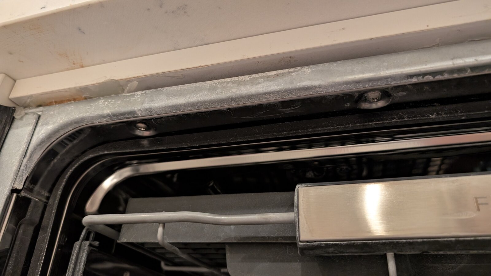

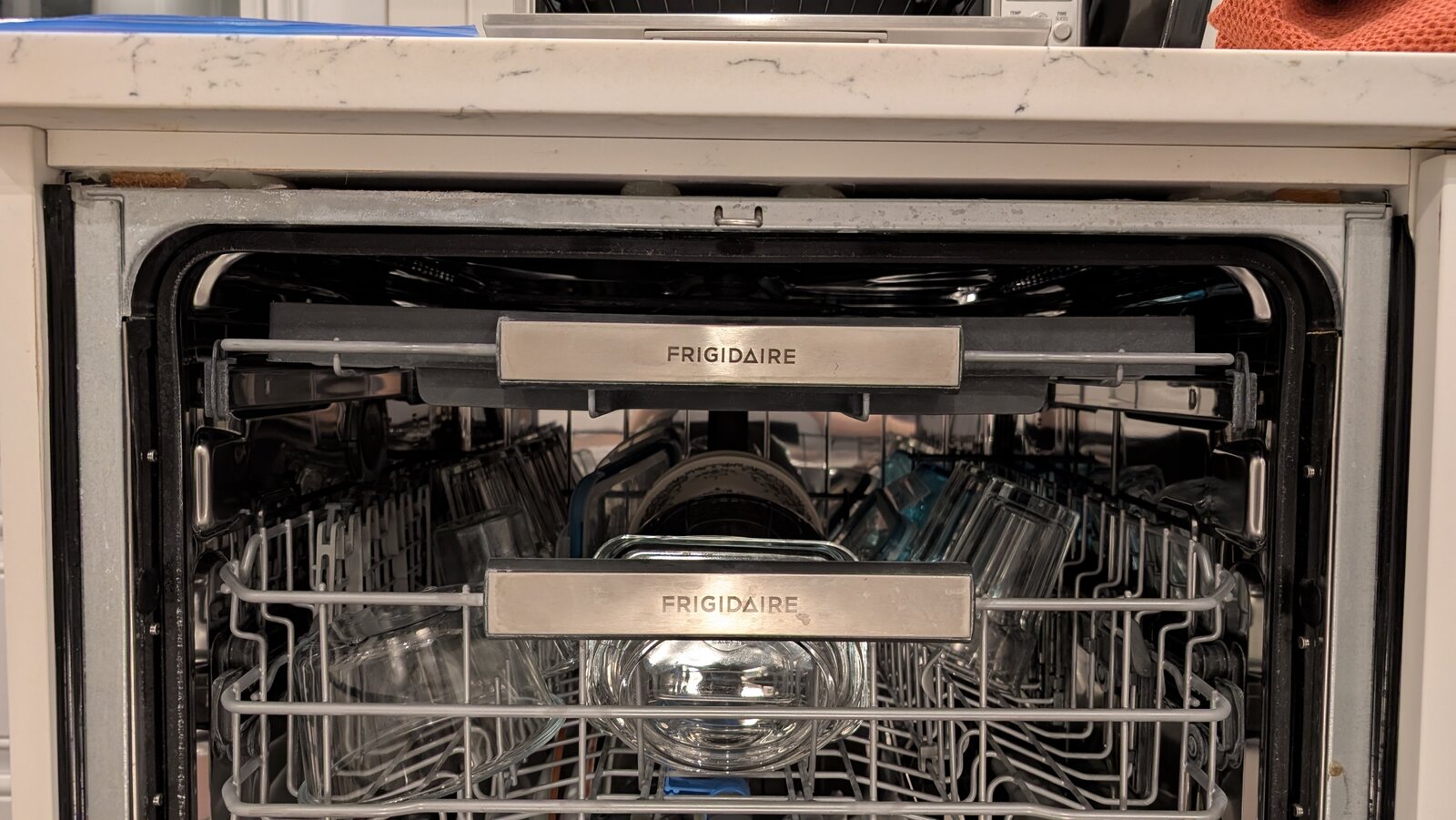

Clearly whoever installed this thing just jammed it full of epoxy and called it a day.
But it's tilting now, naturally. Is there any way to secure this better? The counter top is quartz. And that white bit below that is mdf or something like that. There doesn't seem to be enough room for a bracket.
Any thoughts?
Tilting which way? Adjust the feet so it's sits how you want. The back feet may have some adjuster that is moved via something on the front (eg a screw head that turns a long shaft, that works the back foot adjuster)

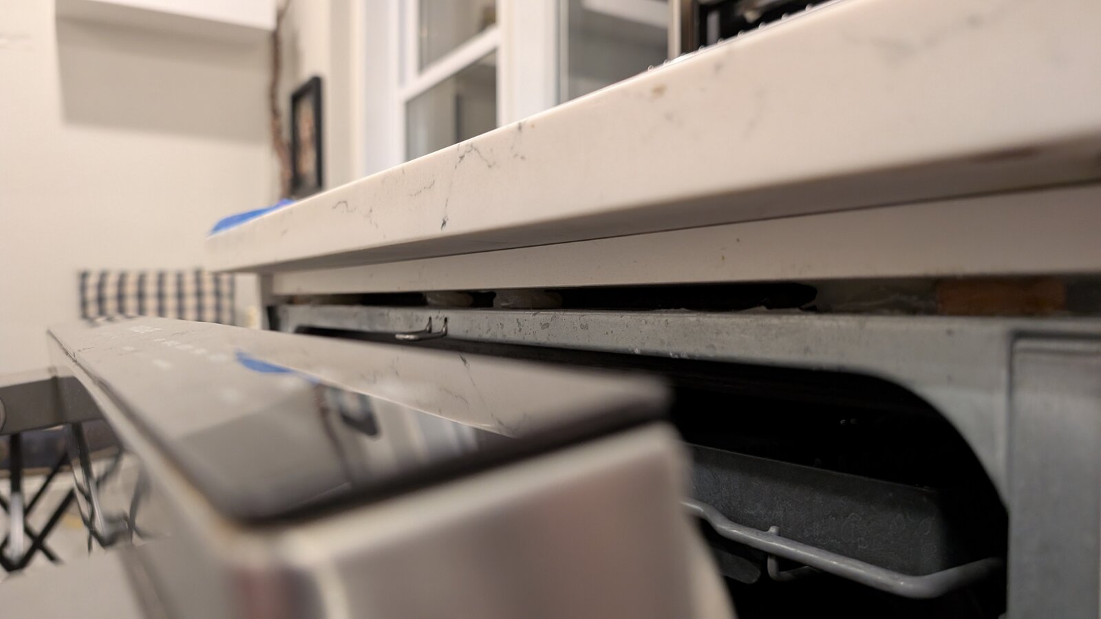

Tilting forward when the bottom rack is too heavy and pulled out.

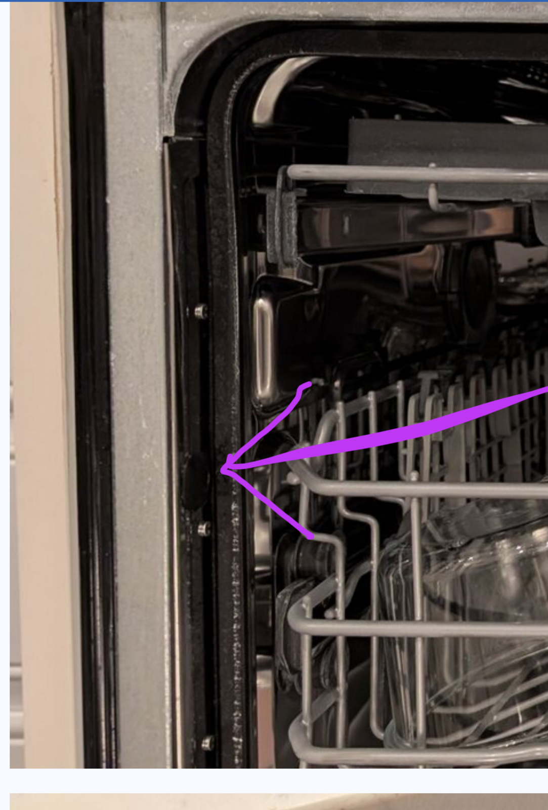

Can you see a screw head at the bottom of this lug:
The original picture isn't the best for highlighting it but around the door entrance somewhere near the top on both sides there is typically a deep plastic hole. You put a short screw down it and wind it into the cabinetry on either side of the dishwasher. Do not use a screw so long it pokes all the way through the wood panel next to the dishwasher
These stop it tipping forward when the door is opened and lower basket rolled out

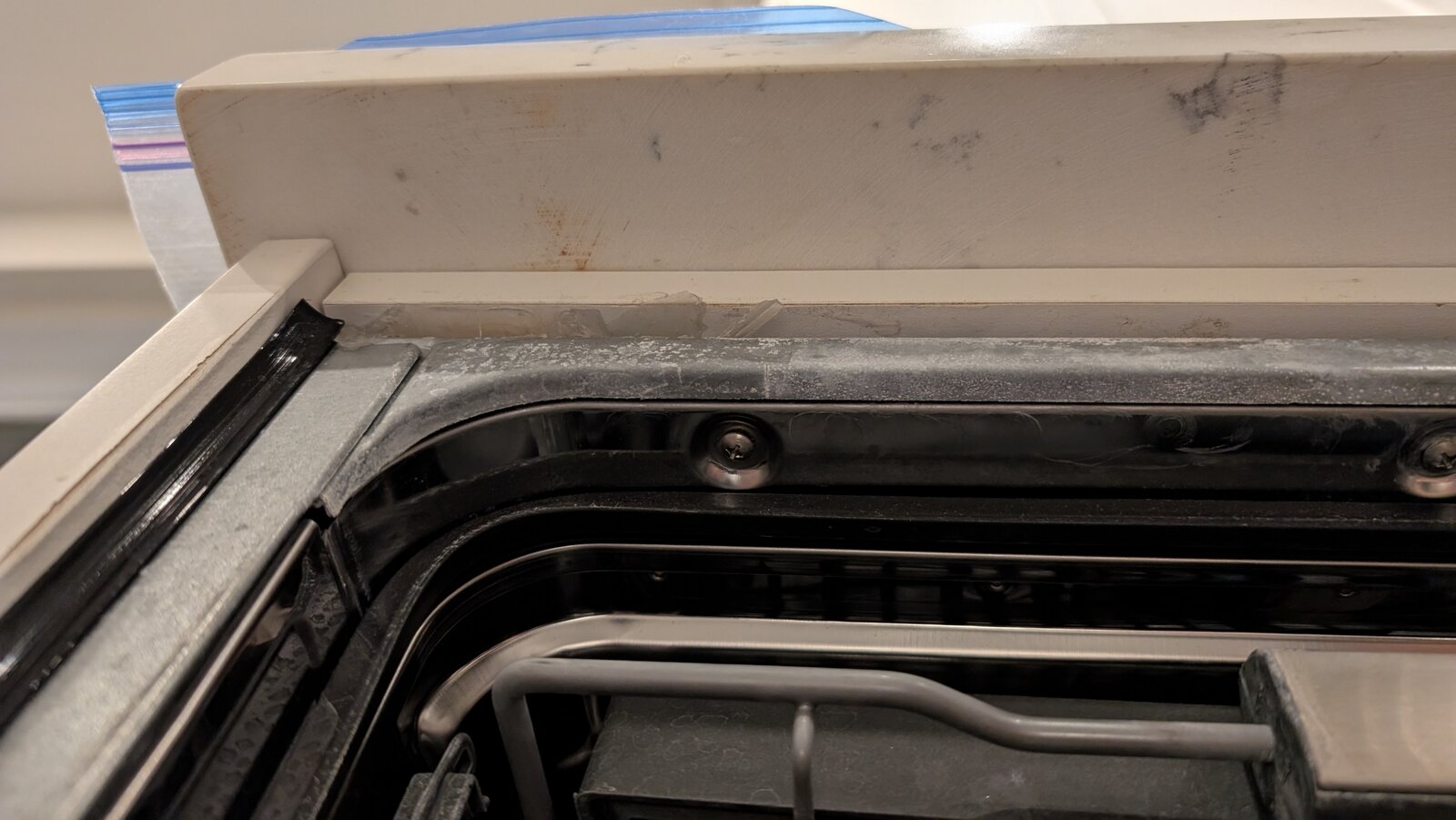

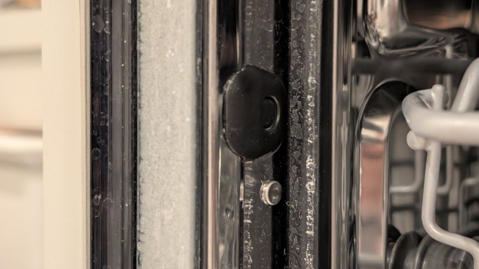

It's not got a screw head, it's just flat plastic. But here's a direct photo...

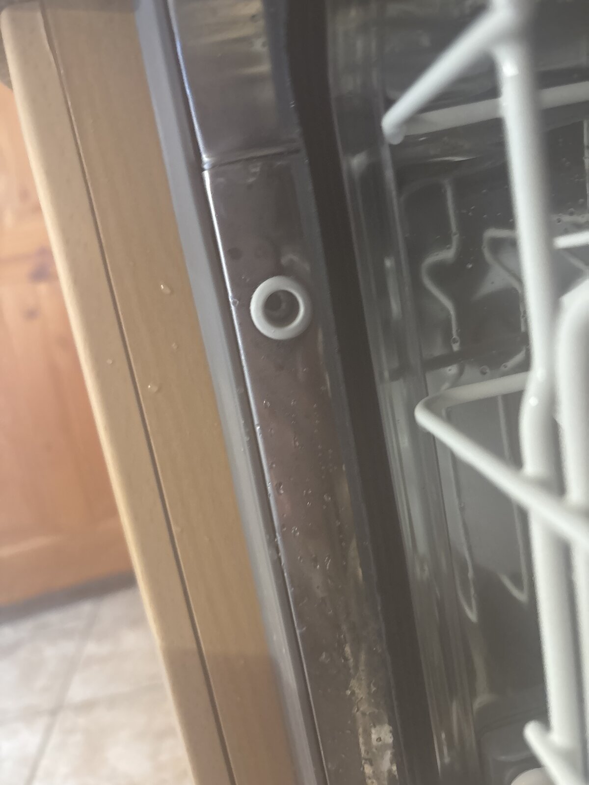

Is it a cover you can lever off? For example here's mine; anything else around the edge that looks like this?:
Shim the gap at the top, use a couple of wooden or plastic wedges held in with a bit of silicone.
I think that's what the person who installed before we bought this place already tried. It's come loose. I think something more solid is necessary.
It scares me a bit because it feels loose, but I don't know if it's pull it out loose, or if it's the kind of loose where if you take it out you'll never get it back in again.
There aren't many "won't stick back in with a bit of Sticks Like even if you do accidentally pry off the plastic retaining clip" types of loose ;)
Black tabs maybe bump/sliders to help locate the door when it's closed

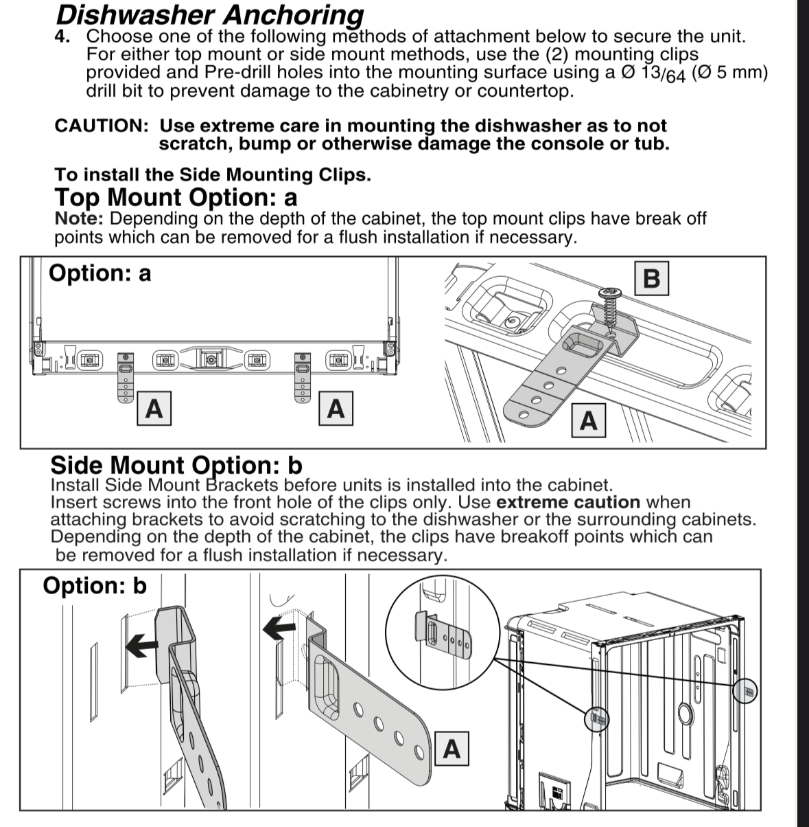

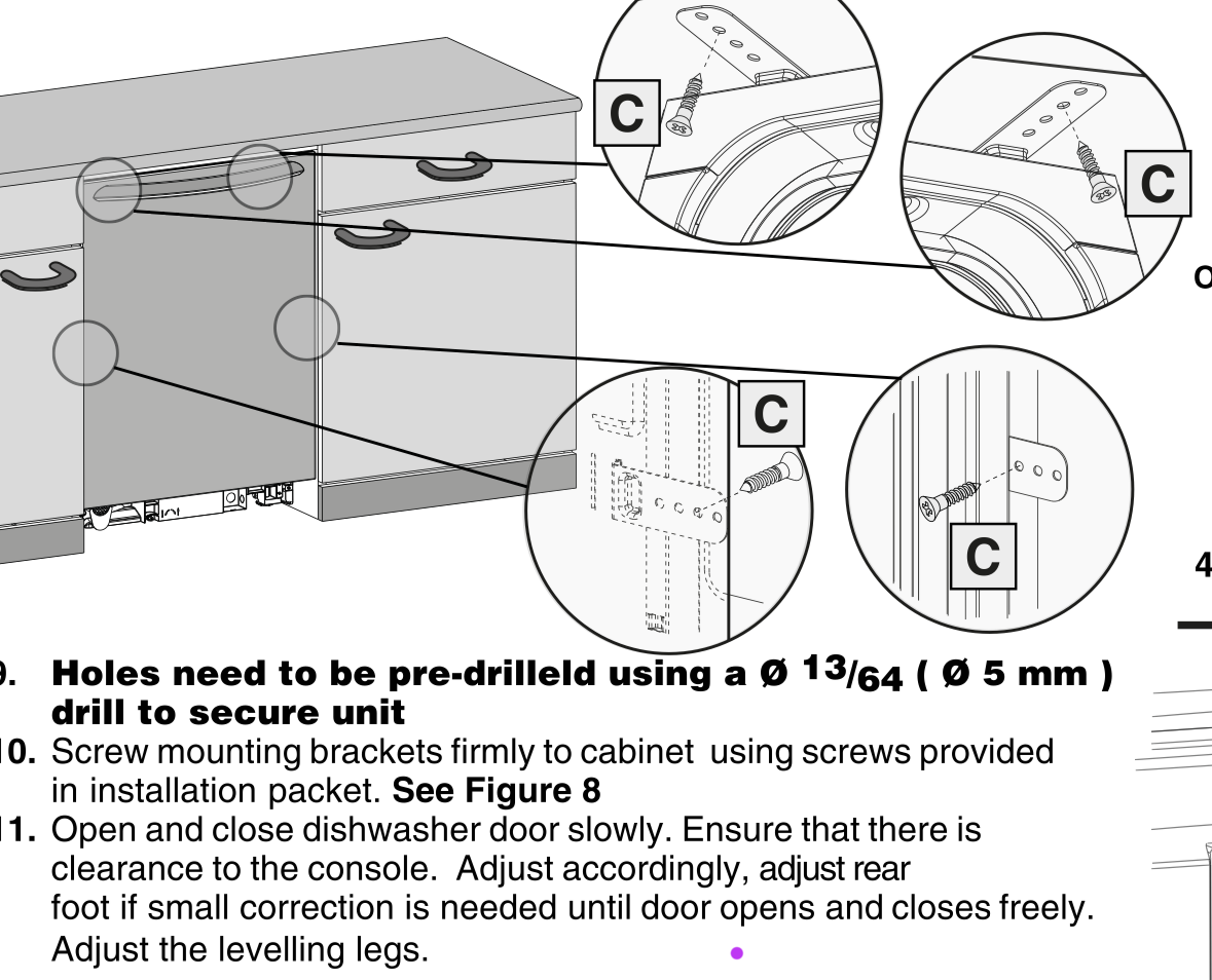

Do you have anything that looks like the flappy P shaped brackets mentioned here:
Or here

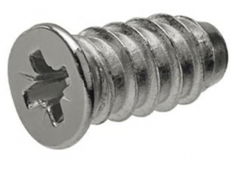

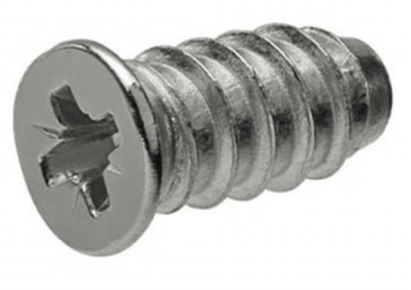

Note the instructions say to drill 5mm holes but I'd caution you only to do so if you're using the fat stubby screws (aka Euro screws or system hinge screws) normally used for mounting things like kitchen door hinges:
Note, if you don't have the brackets I dare say it would work equivalently if you make some using builder's band and rivet/screw it to the washer. You may also be able to drill through the side of the dishwasher, outboard of the rubber seal that goes round the door opening to recreate a mounting hole similar to other washers but I'd advise you carefully drill a hole in just one skin first, and check there aren't any wires running inside the perimeter of the washer opening before drilling all the way through

I don't have those brackets. It seems to be the one thing the previous owner didn't keep. It probably means they were thrown out.
I was just gonna come in here to say I'm starting to give up. I have no idea what to do. I don't have enough cabinet anywhere because of these ridiculous streamlined invisible join cabinet work designs. I can't attach brackets, nor is there enough wood anywhere to attach them to even if I could. I'm really lost.
