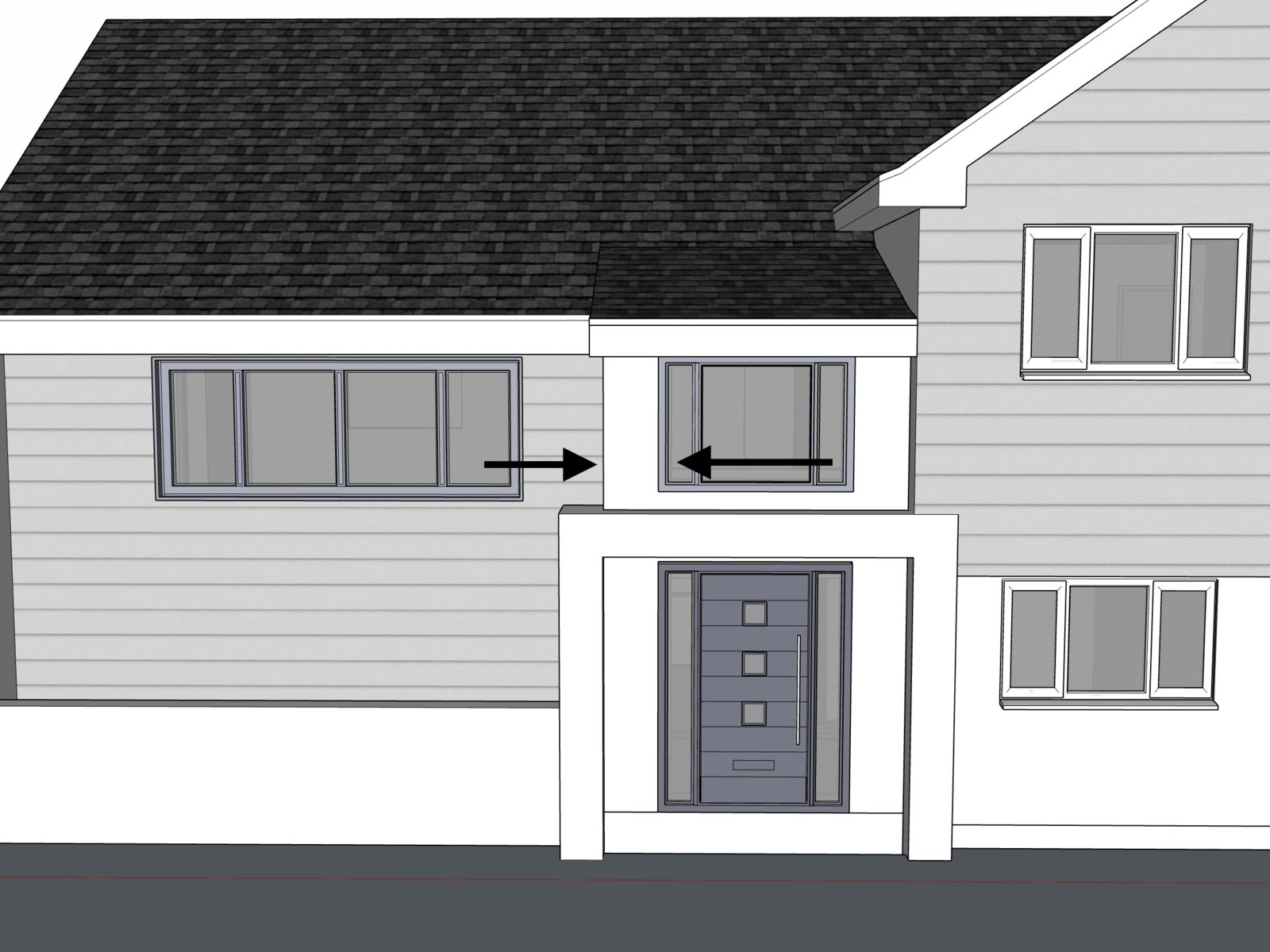

    I’m planning to construct the small front extension (the white rendered part) out of thin joint aircrete blocks. In the picture I’ve arrowed the wall which breaks this rule:
    OPENINGS AND RETURNS
    An opening or recess greater than 0.1m2 shall be at least 550mm from the supported wall (measured internally).
    The external measurement is only 450mm i.e. one block. Is there a way round this?
    Thanks.

    As it's only a small window opening, it doesn't matter if the return is only 450 on the outside; if it was a door opening, it would be a different matter.
    The 550 measurement you quote is from Approved Doc A, which gives "deemed to satisfy" provisions for masonry walls. All this means is that if you keep to the measurements shown, the Building Inspector can't pull you up. But if you go outside those limits, it doesn't mean that what you have done is non-compliant; all it would need would be either to prove with figures that the reduced return would be sound, or be fortunate enough to have a building inspector who had common sense (there are a few around).
    Do it in 7N block and it will be fine.
    BTW, why do it in thin-joint work? It is generally only used for large-scale developments and will be expensive for a small extension. Most brickies are not familiar with the method.

    Thanks for the reply Tony.
    Why thin joint? It’s only a small extension, I’m doing most of it myself and I just fancy giving it a go! From what I’ve read it’s more common outside of the UK.
    I’ve read this :
    https://www.hhcelcon.co.uk/sites/de...ts/Designing-and-Building-with-Aircrete_0.pdf
    and was planning on 7N aircrete all over due to the diagram on Page 4.
    Should I just remove that line about the 550mm from my Building Regs application when I submit it and wait and see?
    Many thanks.
