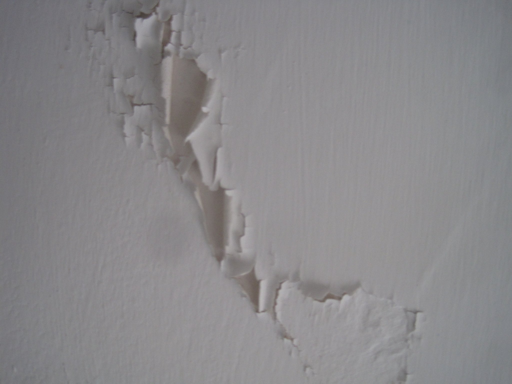

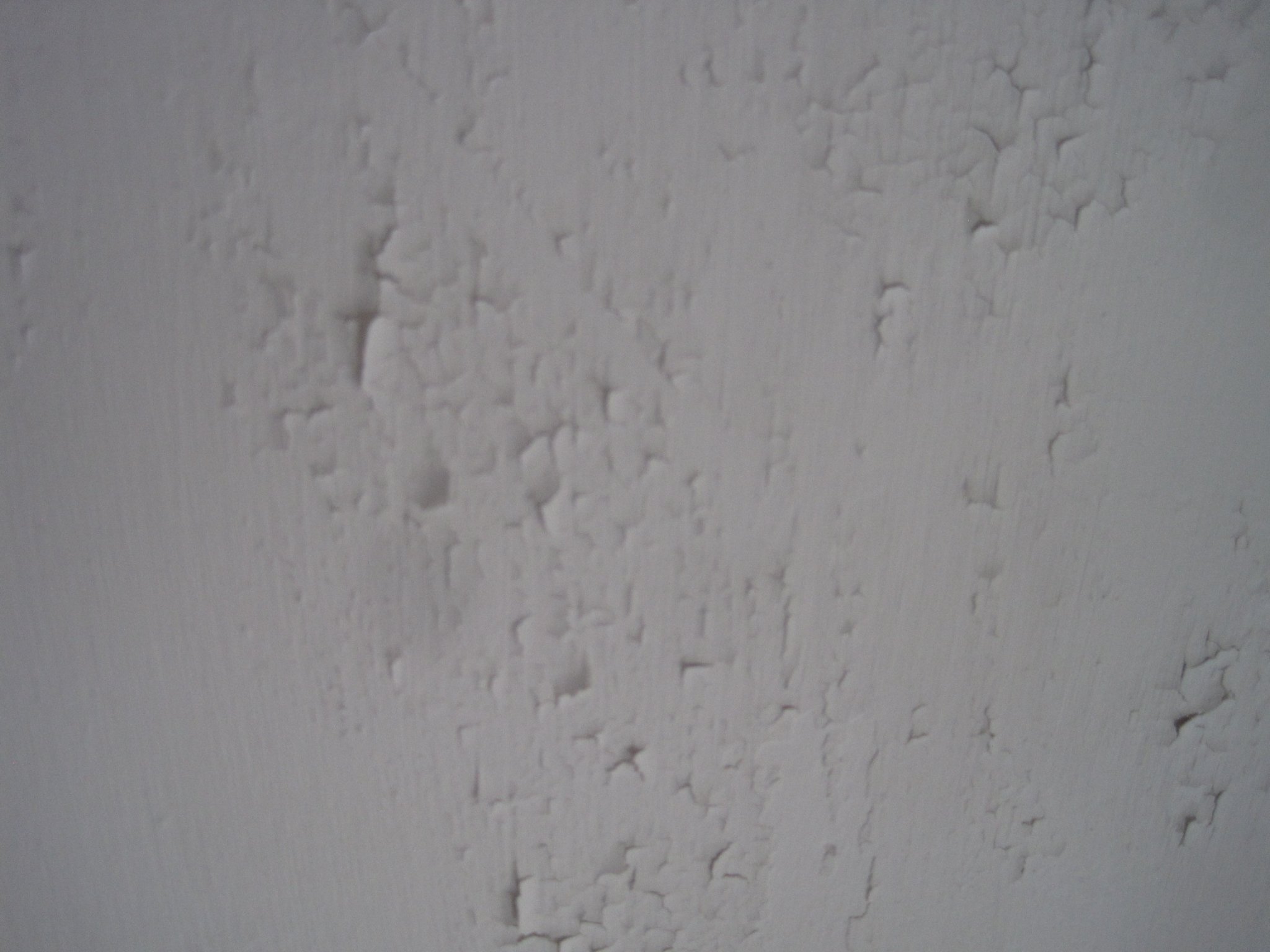

I had part of a wall replastered with lime plaster at the start of January and have now being trying to repaint the whole wall. The rest of the wall (non-replastered section) must have been painted by the previous owners, I assume with a matt emulsion.
The paint I chose was an oil-bound distemper. I'd wanted something permeable and this was one of the few that said it could be used over both lime and over emulsion.
Today I tried painting the wall, following instructions e.g. thinning the first coat with water. The result: parts of the paint are peeling off in swathes, within an hour of painting. The areas affected seem to be perhaps around the join between lime plaster/old emulsioned areas.
For context, I don't have loads of cash to throw at this and I am also a complete novice at DIY, I may have made a very basic mistake. I'm not big/strong enough to do much more than simple "paint a wall" jobs but I was hoping this one was something I could manage...but now that I'm in this mess I'm wondering what the way out is.

Sand off dispenser is easiest.
Bodge a cheap DIY orbital sander on a vacuum with 120 grade disc.
Other way is to wash it off but a horrible job.
Worst thing is to try and paint over it as that's a problem now.
You need to scrape off paint and remove the distemper
Thanks so much. So was I wrong to use an oil-bound distemper in the first place? I thought it would be ok on lime plaster.
No.
It won't stick.
You needed to wash off the old distemper.
Look up the oil-bound distemper data sheet.
Whats the advice on that?
It's not lime your painting over. It's distemper.
Lime plaster is fine you have the correct paint.
Not the distemper though
Perhaps I wasn't clear. The wall I was painting over was (1) lime plaster - a patch repair done in January, unpainted, and (2) emulsion, from previous owners.
The new paint - the paint I used - is distemper.
The interesting thing it has peeled mostly along a kind of wavy line about an inch or so wide- I'm wondering if it is something to do with the combination of new lime plaster/old paint or where they meet. Parts of the paint over old paint/over lime look fine (so far).
