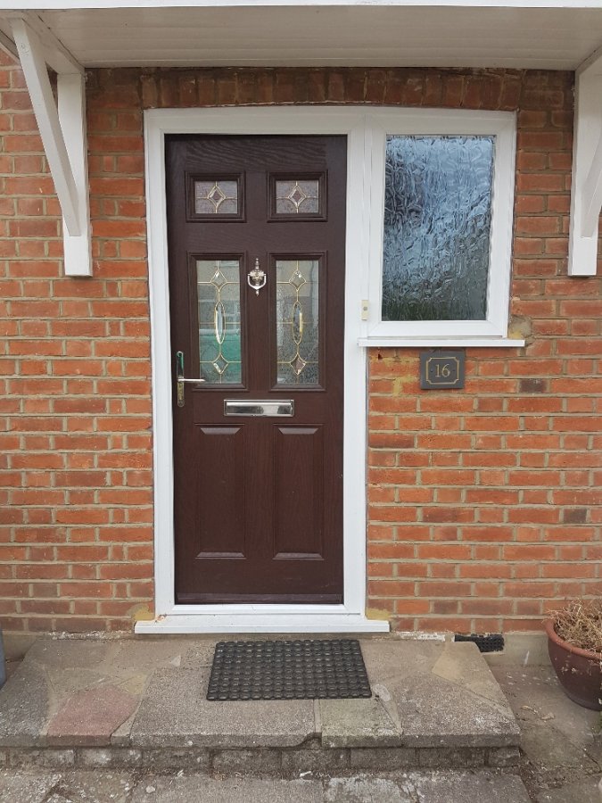

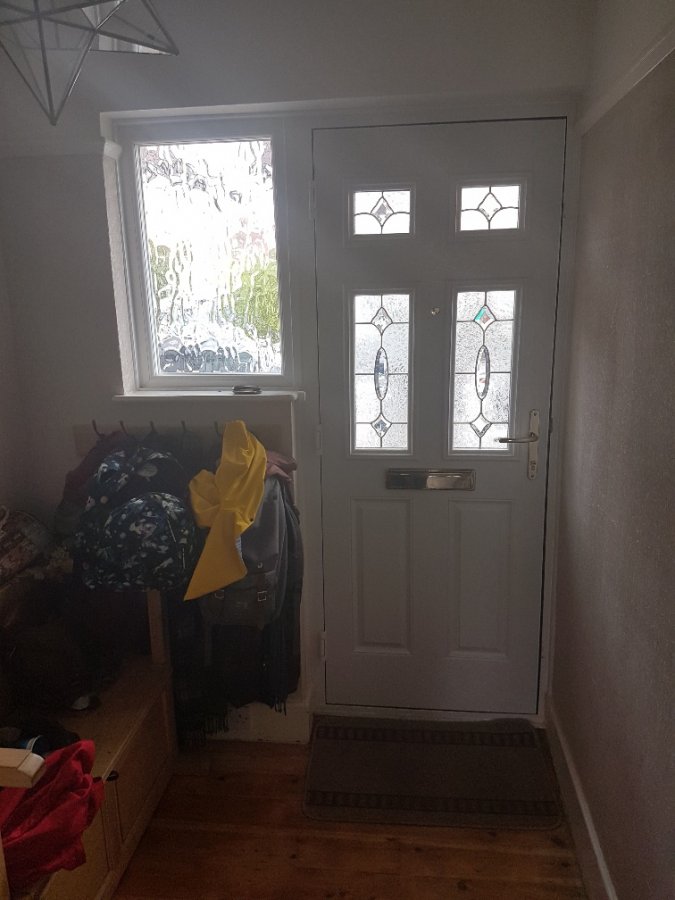

Hi all,
In a long story cut short, I was scammed out of the £1500 I had set aside to replace my uPVC front door by a sophisticated invoice hacker scam. Anger has turned to a miserable acceptance.
To get over it, I am going to replace the front door and side window myself with the help of my father-in-law, who is a handy amateur joiner and very good DIYer, and i would say I am an assured DIYer. I have built and hung internal walls and doors before, but never tackled a front door. It doesn't seem like a huge leap forward in skills. Have attached pics of door at the moment. Have bought and had stripped a reclaimed 1930s door that I am having reglazed with stained glass and have commissioned a stained glass side window so that both match the original features on display in other 1930 houses in my street. My questions are:
1) Am I crazy doing this myself?
2) Am I likely to fall foul of building regs?
3) Before deep research, I am assuming I build a complete frame for window and door first, then insert the window, install and hang door. Is this a good back-of-napkin workflow?
4) I have never fitted a window before. Could someone point me towards some good advice or guides for this?
Any other tips, advise or warnings (even if it is - don't do it!) would be hugely appreciated. Determined to claw back this £1500 through my own hard work and learn some new skills along the way.

Hi Tom,
So, are you removing the white frame seen in the photo's? And you also want to make your own new frame? If I understand this correctly then I would go about making my frames first (one for the window and one for the door), then I would hang the door in the frame in your garage or workshop. Once you're confident it fits and you've got all the ironmongery fitted I would proceed with replacing the old one. I don't know much about the regulations, but I'm sure you can do some research and maybe call the governing body for building regs regarding doors, gaskets, sealants and glass. If you can afford it, make the entire frame from hardwood, sapele is fine, if you can't afford that then just make the sill's out of hardwood. Your glazier should have allowed for enough room in the frame for packing, if you ask, he might even have some window packers. Pack the window all around but not so tight that the glass breaks, pin your window beads on and depending on whether its internally or externally beaded you will want to seal the outside with silicone. Double sided security glazing tape is also a good idea, you stick it to the inside of the rebate and the glass sticks to it. But be careful, once the glass has stuck to it, you will not get it off!!! For specific things like 'how to make an external door frame', you can better search for a video online.
Hope this helps,
