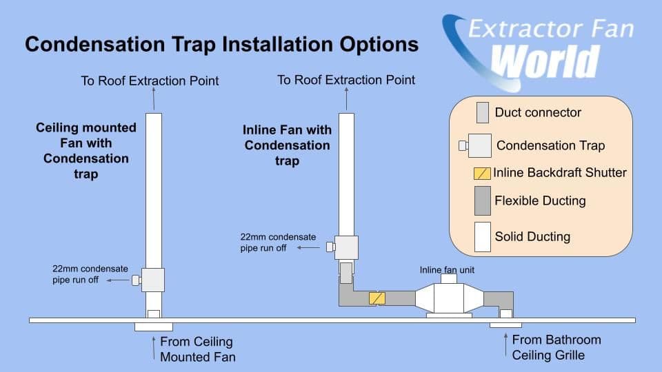

If the vent is going straight upwards through the roof, look at 'vent pipe condensation traps'...
Where does the condensate trap run off to? Does it need venting off?
Insulate the rigid pipe or the flex? Would rigid ducting be any good for inline fan?

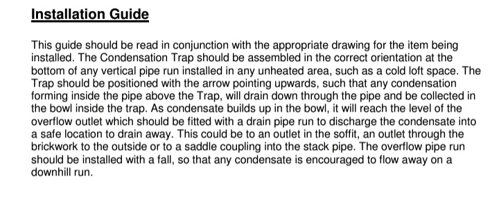

Ideally, it would run to a drain. However, as the condensate should be minimal, and harmless (unlike the acidic condensate from a gas boiler), the outlet pipe could be run out of the wall, or soffits - try and make the pipe stick out far enough, to avoid drips falling against the wall.
Here's a snippet from an installation guide...
