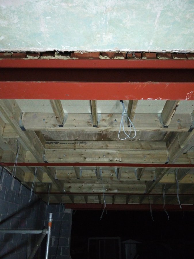

Here's the pics:

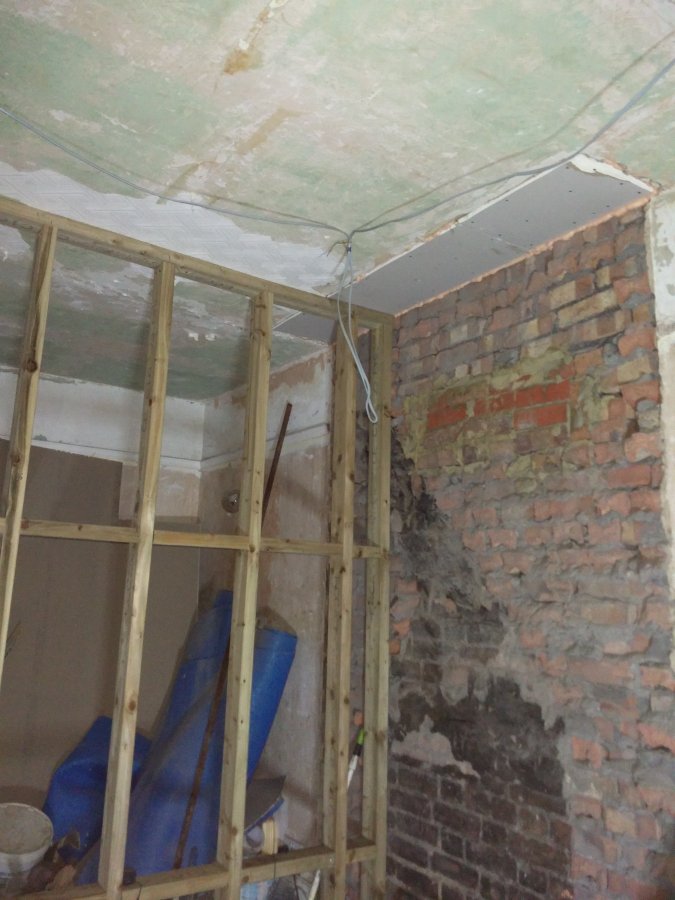

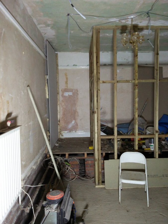

842 is the view of the utility room
643 is the corner of the utility room where most of the other electroncs will be sited (patch panel, alarm etc)

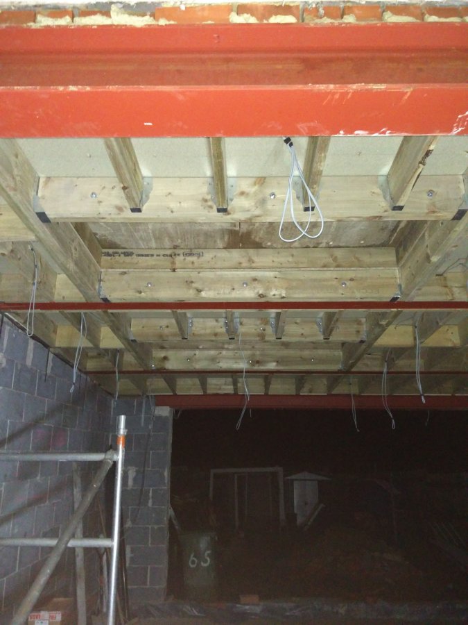

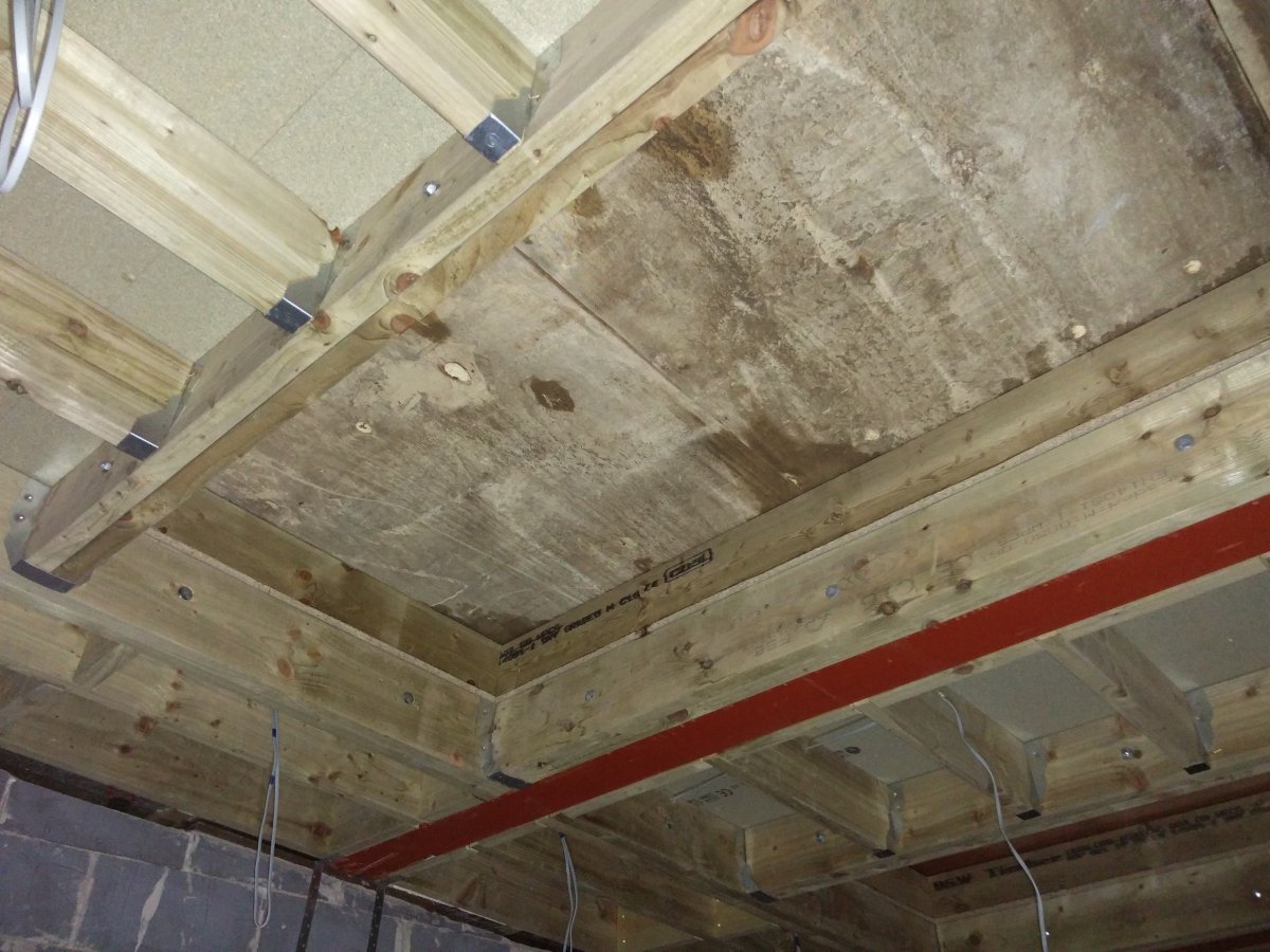

627 is the view of both skylights from the existing room (living room on plan)
315 is both walls against utility
552 is a closer pic of the skylight.
Its a cold roof, so insulation will be going in under.

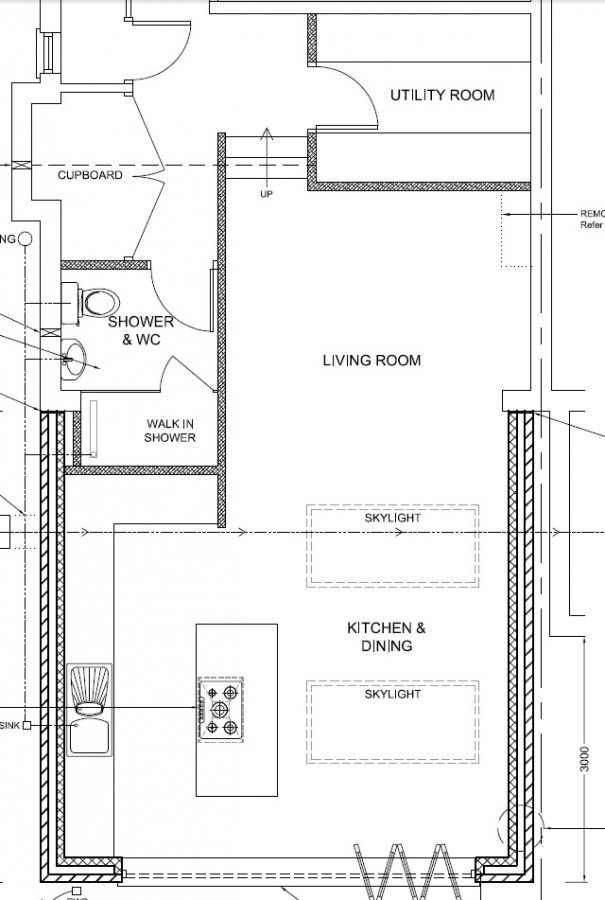

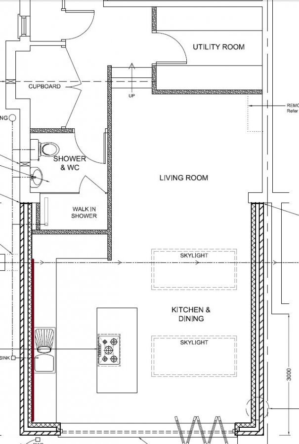

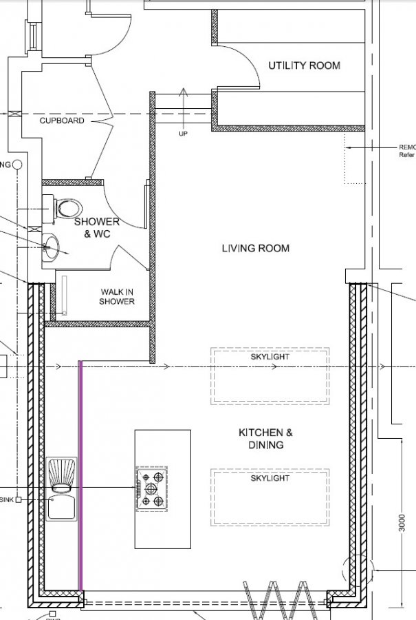

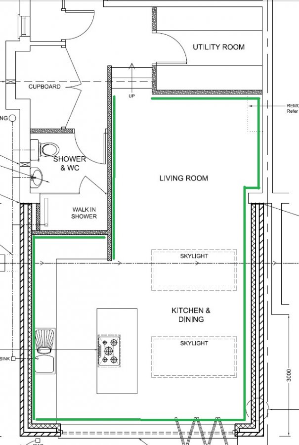

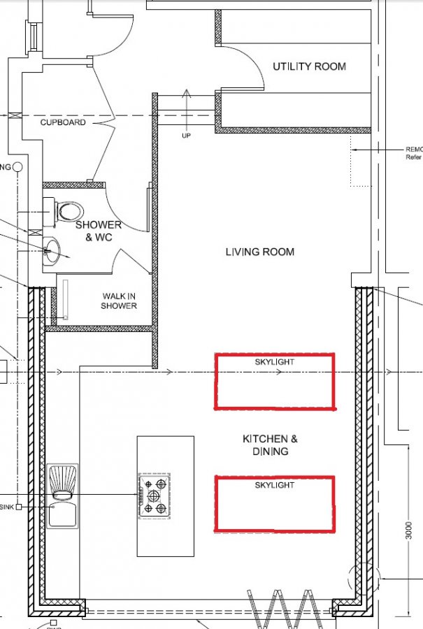

and the plans.

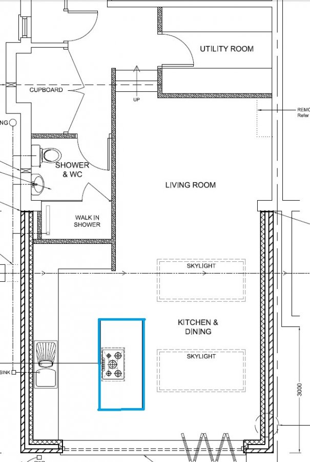

So the island one - (blue lines), the splashback (maroon) and kitchen (purple) should be powered easily from within the units, with one large, or multiple psu's at 1m, 1.5m,2m etc...
The perimiter for some parts should be ok - above the kitchen, the wall against utility room, and possibly the wall shared with bathroom. The rest of that one - ie the long plain wall, and across the doors will be problematic. Doors there is a possibility of servicing from outsite - though then although covered, there will be the possibility that the electronics side will be in a possible damp area...
Distance between the skylight closest to the living room is approx 1m away from a steal beam holding up the old house wall, so possible to push cabling through to floor void in the upstairs room for that one, but not for the other...

The kitchen bit is a flat roof extension yes? Control gear on the roof would be a possible but it'll look a bit rubbish from the (presumed) window looking out from upstairs into the garden and of course it would involve penetrations through the roof covering which might or might not be a goer.
You could put boxes on the outside walls but again it'll look a bit industrial (and that assumes the outside walls aren't party walls)
Everything north of the steel (which I've assumed sits on that nib on the west on your pics) plus 2000 down the east wall and the northern skylight can be powered from gear trays under the floor of the room above.
The problem areas are the southern skylight, the southern 3 metres of the eastern wall and the eastern 2 metres above your folding doors.
2 choices;
1) Bite the bullet on chunky power cables and drive them from boxes above the kitchen cupboards. You can push 4 amps for 5 metres down 2.5mm T & E so you'd need a lump of 2.5 from your PSU to each pair of strips. Going to be messy..... actually it isn't that bad, you just end up with 6 x 2.5 running from above the southern kitchen units- 3 to the southern skylight (6 strips), 1 to the eastern 2 metres above your door and 2 to the southern 3 metres of the east wall. And if you fuse appropriately on top of the kitchen cupboards (5A for each leg) you'll get good fault discrimination as well. In fact you could run the northern skylight with the same scheme (from above the cupboards) if it was easier- another 3 x 2.5.
2) Hide some gear up in the ceiling with an access hatch
Data-wise remember you can't spur off the daisy chain (well you can but you'll end up with duplicate addresses which will be a bore). I'm assuming that the drivers on those strips can drive across 5 metres or so, might be worth checking with manufacturer/supplier. As long as they will do that trick then you'll need 2 bits of CAT5 from each skylight either to the eastern wall (to insert them in that chain) or back to the top of the kitchen cupboards (to insert in the chain there). Not sure if the Pi can generate multiple streams- if it can then you only need 1 bit of CAT5 from each skylight back to the Pi (as well as the CAT5 feeding the main chain of course). You are having wall units above the sink aren't you?- if not then oops.
One other possible cable saver would be to run the power in at 12v and then hang DC-DC converters off the 12v lines at every 2 strips or so. Advantage- removes any potential volt-drop problems (you will get some drop even at relatively low current at 5v). Disadvantage- cost and another thing to go wrong.
