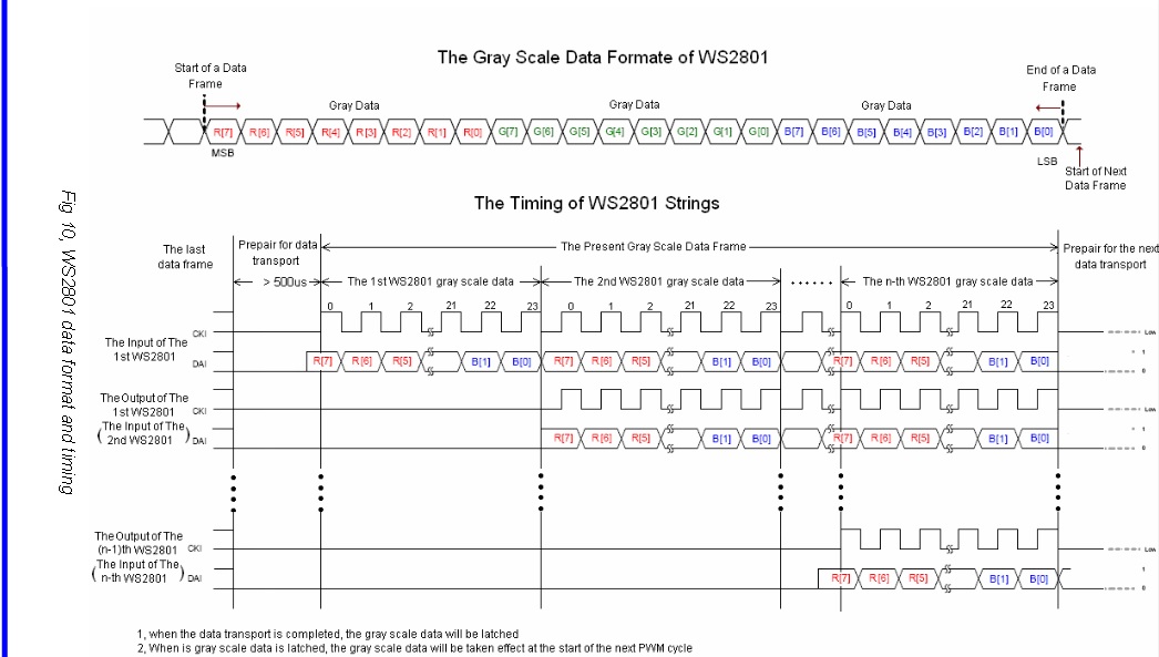

If i use ws2801 leds (individually addressable) and use a receiver which translates as needed to the ws2801 string, how many led's can i control individually? I'm seeing a floating number of 170, ie a third of 512 less a few for other parts of the protocol but is that for RGB leds rather then the ws2801 protocols for individually addressable?
2) if the max number of LED's i can have per receiver is 170, i'd need something around 18 controllers for different areas/same areas but extending the string. Am i right in thinking that these will be different universes?

WS2801 LEDs have an SPI interface. They can be driven directly from the Raspberrypi, or more likely via a simple voltage buffer.
No need for USB, converting to DMX or whatever else.

The description of the WS2801 is misleading. The individual chips are not addressable and cannot be selectively written to unless each has it's own output from the controller.
The data packet required to set the colour of a single pixel ( one WS2801 chip and three LEDs ) is 24 bits of data. To control a string of 100 pixels would require 2400 bits of data sent in a sequence. Even to change just one pixel in a string the entire string has to be re-written.
To control a panel of 100 by 100 pixels would require 240,000 bits of data to update the panel. Best achieved as 100 strings of 100 pixels and not as 1 string of 10,000 pixels if the time to update the panel is to be reasonably short.

The serial data and clock for each string could be cariied over CAT 5 cable, one pair for data and one pair for the clock with converter chips ( SN75176 ) to convert the differential signals to single ended. ( wasting half the 75176, othe chips are available ).

I would suggest you start with Pi or similar with a single strip of a few pixels ( WS2801 and 3 LEDs ) and experiment to find out all that is involved in changing the colours of the pixels. For one thing you will have to compensate for the differnt brightness levels of the red green and blue LED elements. In theory one would think putting the same value to each of the three LEDs would give white light ( all three same brightness ). In practise doesn't work like that.
Only by experimenting can you learn enough to be able to create a design for your own hardware for the system you want to create.
