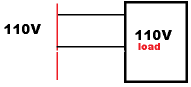

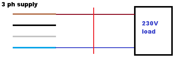

Yes I agree too. And on that basis I'm sure you'll agree this is a single phase load: ... Despite the fact the socket it's plugged into (represented by the red line)is this:
Yes, your right in being sure that I would agree with you.
Asa I've said, if a load has only two 'terminals', hence only sees the pd between two supply conductors, then, from the POV of the load, there is no meaning to the concept of 'phase' - so there can't be more than one of them!
Kind Regards, John
Effectively, so far as a a load is concerned it will not care whether it is two phases, or one phase and neutral - ignoring the voltage. However, try sticking a 'scope across it.
Assuming the 3 following examples are of similar device, something like a resistive heating element or incandescent light bulb for example the only difference to be seen on a scope will be the voltage or current value, they will all be a sine wave.
As I said, if it is a '2-terminal load', then the concept of phases/phase differences is meaningless.
If you connected it just across the two terminals, you would see just a sine wave. Nothing to compare it with, so no question of anything to do with 'phases'.
However, if you used your (2 channel) scope to look at the pd between each of those two terminals and some external reference (e.g. 'earth' or some sort of neutral) then, with some of the sort of situations SUNRAY has been considering, you would see two voltages which were 'out-of-phase' (with respect to the reference) - but that woulkd still be meaningless in terms of what was across the load.

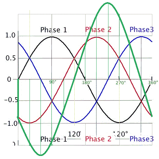

You could use a couple of step down transformers and connect the scope leads to the ELV secondaries.
If you used this approach and had 4 traces & transformers this is roughly what would be seen
Excuse the American wiring colours.
The green trace is the PD across black and red phases.
