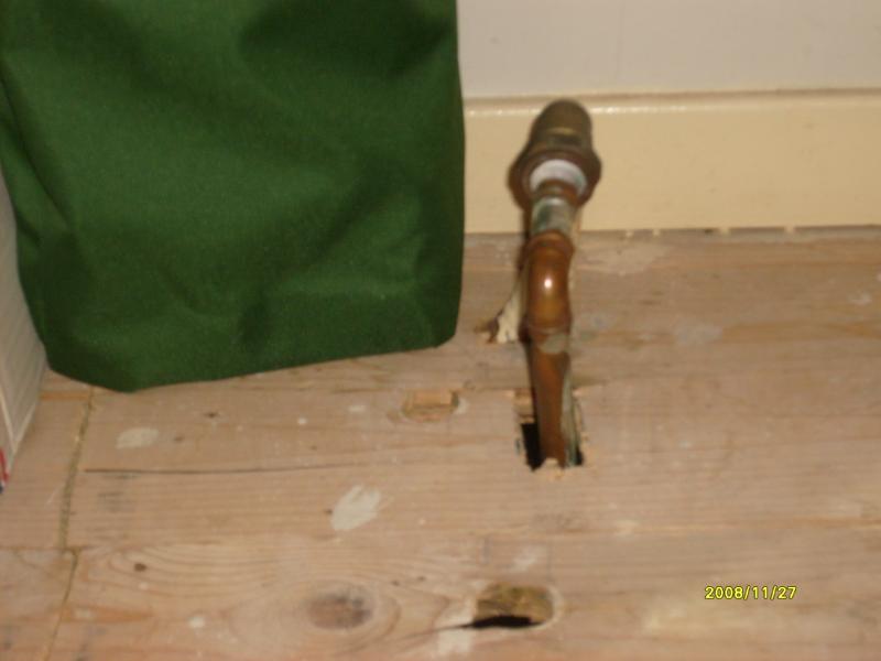

For several reasons I don't have much confidence in the people who installed my central heating (for example in the bathroom they put a towel rail in upside down :shock: )
In my airing cupboard they joined the hot water supply pipe (15mm I think) from the boiler to the old supply pipe (22mmm) from the hot water tank. They joined them above the floor boards ..the loop formed annoys me - it stops me using the floor space for efficient storage and also I'm worried as it keep getting knocked it will start leaking.
I always thought they were just being lazy and am thinking about cutting the pipes off and joining them (using compression fittings) under the floor boards. I'm just checking that the loop doesn't serve some purpose that I don't know about...
It is definitely the hot water pipe - it is cold and then I run the hot water and it gets hot...

Compression fittings can go under floors. They are bulky and sometime impede the floorboards. Only use quality fittings - not cheapo Screwfix. Many don't like them under floors because if there is a problem, they are difficult to get at. A soldered joint is rather more permanent - although I have known some to fail after a few years.
The pipe with the two 15mm elbows. This should have been two sockets and an offset. Only use elbows when there is no other option, otherwise use bends and offsets.

There is no regulation stopping you putting compression heating water fittings under floorboards, though there is for gas. This is because they are more likely to start leaking. Best avoided, because hot water pipes move a lot more.
Heating pipes can have many elbows with no effect whatsoever, except to outrage the sensibilities of a simpleton.
Having two elbows instead of a bent pipe would only be a problem if there were issues with a long pipe run and problems with flow rate through it. One advantage of the two elbow setup is that if anyone needs to work on this section of pipework in the future, it is easier to manipulate the pipes into new fittings if there are right angles involved, as copper pipe installations usually have more movement perpendicular to the lay of the pipe (you can bend but not stretch!)
...and irrespective of any regs, it is better to avoid using compression fittings under the floor as they are more likely to leak later on in life, especially if any movement of the pipe occurs. Properly fitted plastic plastic pipe and push fit fittings are a good alternative to consider, as long as they are not too near the boiler, (1,5m, I think).

Only cowboys do not adhere to that. If a DIYer can't bend, then 45 degree elbows are available. 90 degree elbows should be avoided. Too many elbows clustered gives water noises.
The above job was a cowboy job. It should have had a 45 degree elbow and 45 degree bend.
