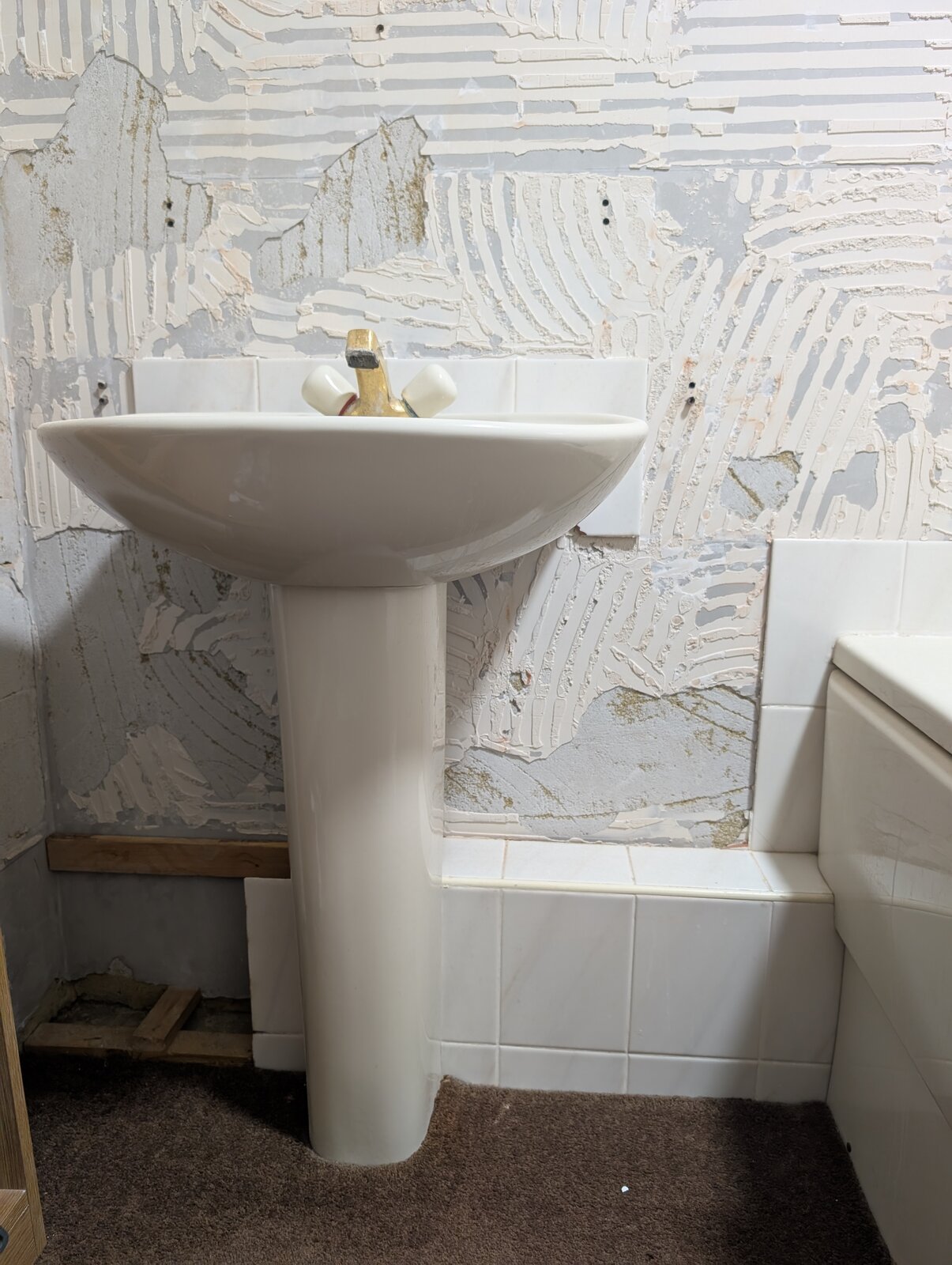

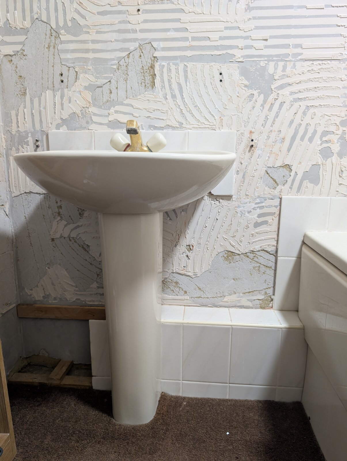

The pipes, supply and waste, utilise the small boxing in below the current sink. I would like to build up the boxing in to form a sheriff above the sink and then fit a wall hung vanity unit and sink.
In trying to find the answer through Google and you tube I can find mounting frames (like the ones you get for wall hung toilets) for wall hung sinks on their own but not for vanities.
Do I need to find a specific frame for a vanity, or would the stud work fit the boxing in be sufficient to hold the vanity and sink?

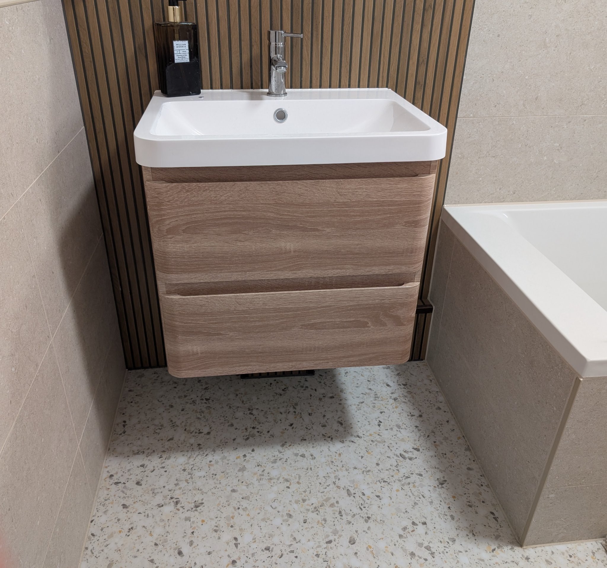

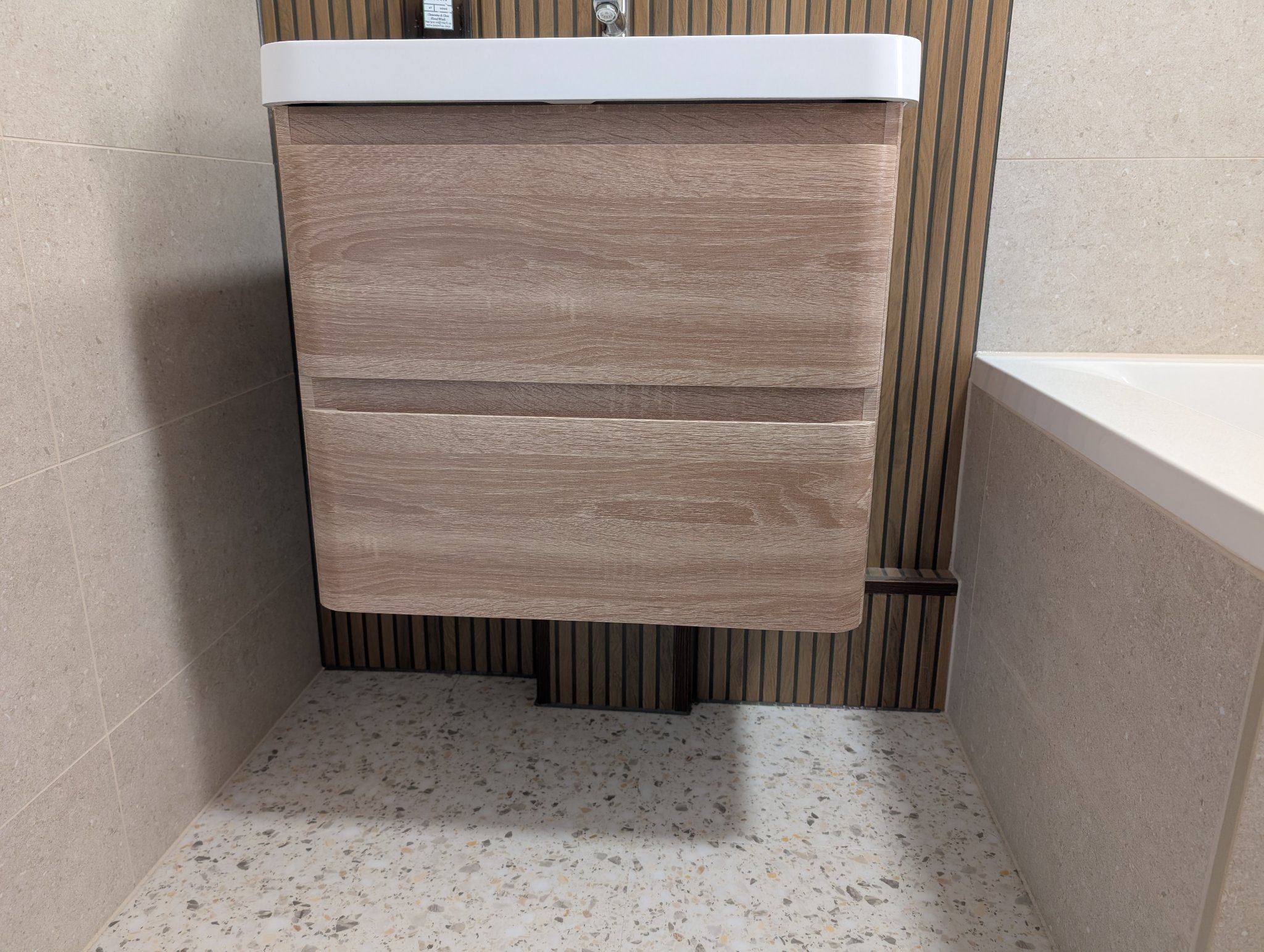

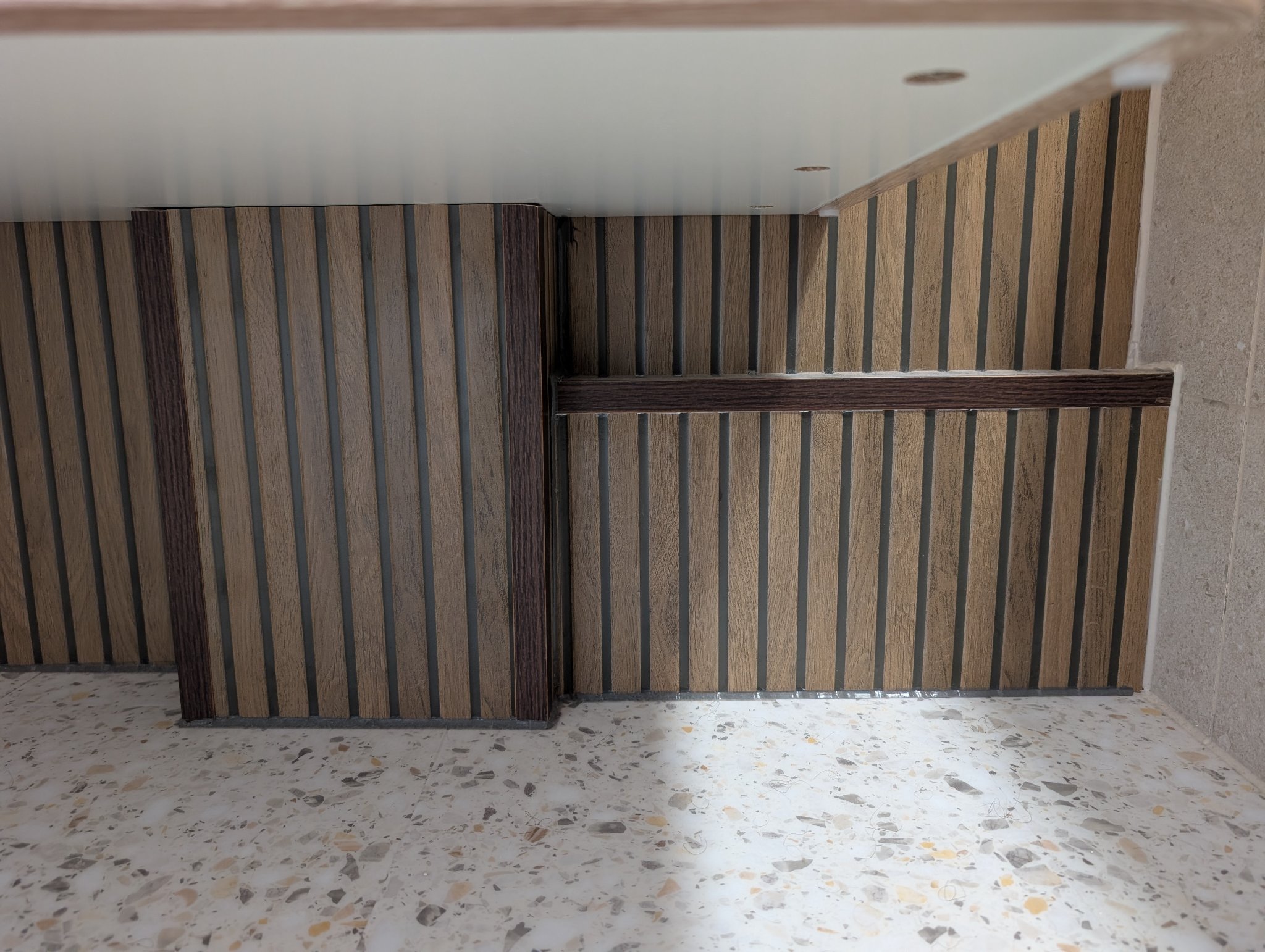

Hey, I didn't use a vanity frame, I ended up bolting the vanity to the wall.
The boxing in underneath was created using small bits of wood to frame it out, cladded with tile backer board (wedi board) and then tiled over. Hope this is helpful.
