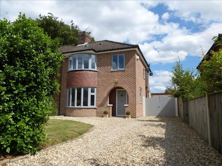

I would like to get opinions on if I need an architect, or an architectural technician for my proposed extension.
The house is a 1930's detached very typical of many houses built in the interwar period between 1920 and 1938.
This picture is not the actual house but you get the general idea. Bays front and back, hipped roof, chimneys etc.
I want to extend the rear of the house to enlarge the kitchen and make improvements to the lean to down the side of the house. I plan to extend 4 meters from the back of the kitchen (maybe 5 metres with neighbour consultation). The roof could be flat with a lantern or maybe pitched. It is a "box" on the back of the house that will not be visible from the front. The look should fit with the existing property and I am not really looking for any particular flare or grand design.
