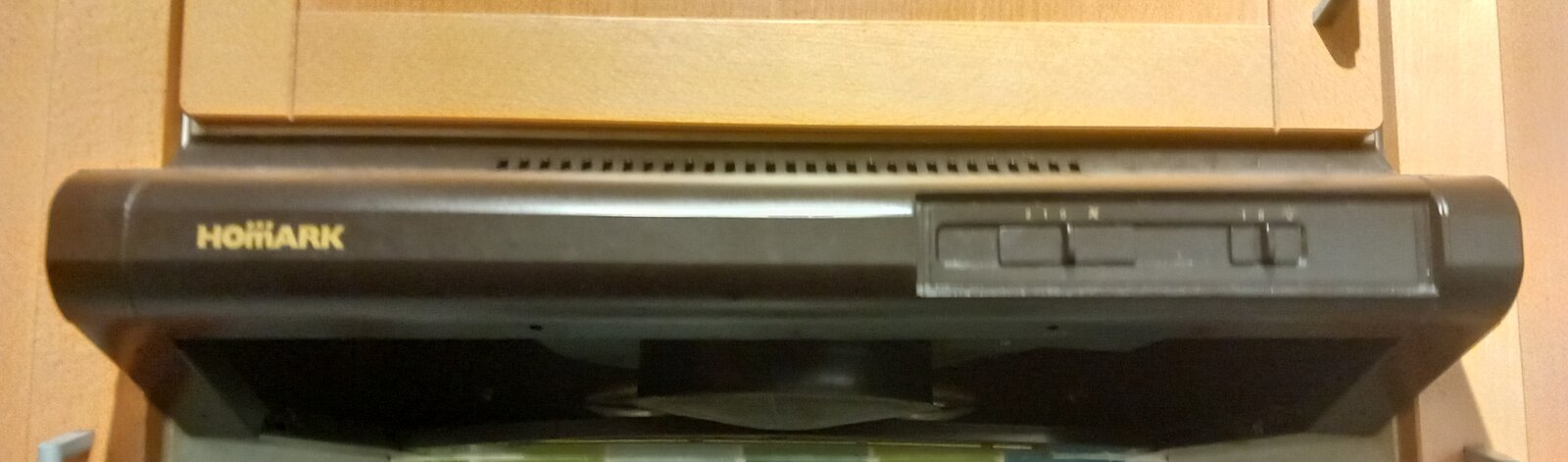

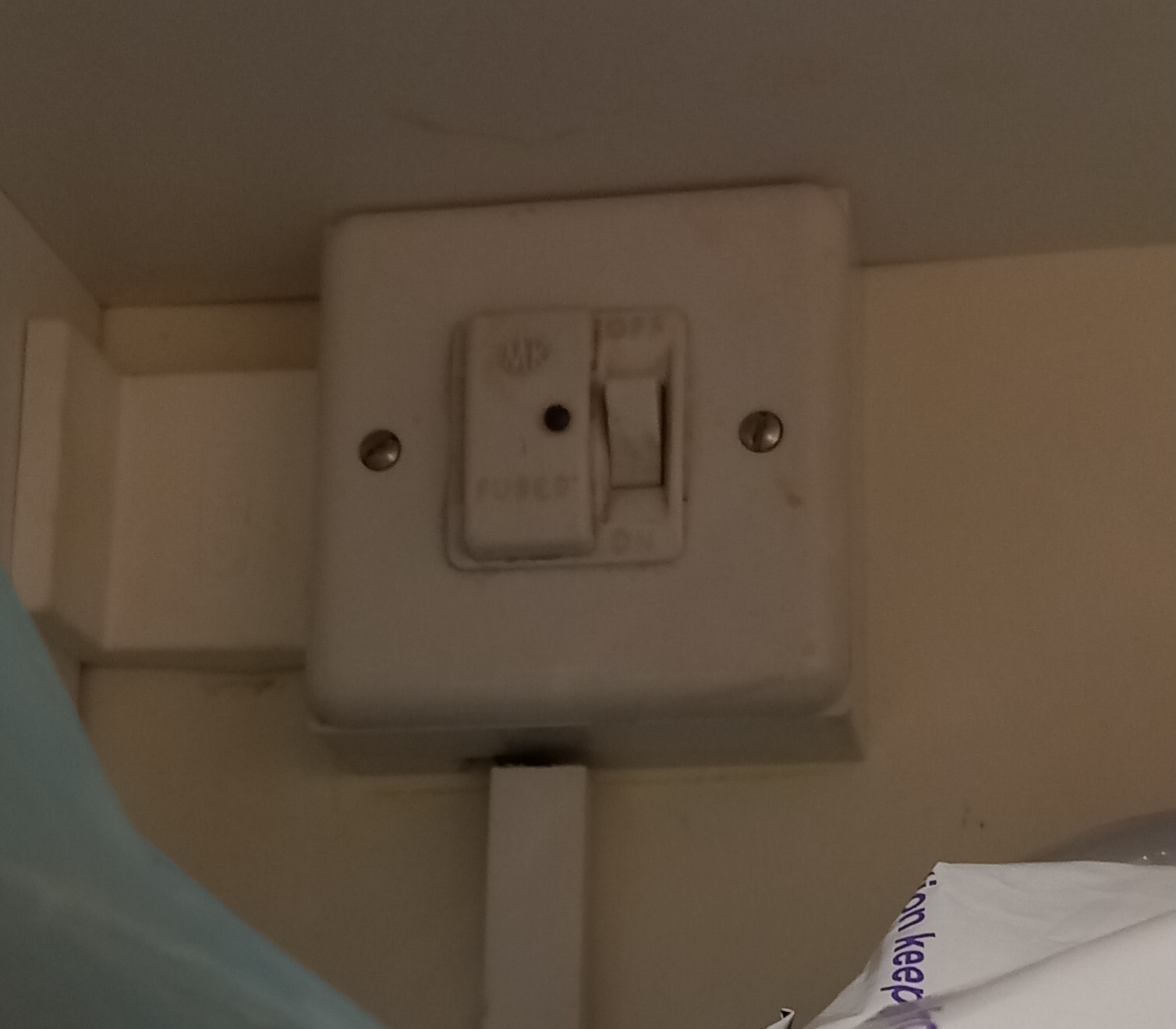

Do I need planning permission or any kind of local council permission to remove a very old (non-functioning) cooker hood and the isolator switch associated with it? Isolator switch is currently in kitchen cupboard above non-functioning hood and I want to remove the cupboard and put shelving instead, so would like to remove/cover up the isolator switch and wires to old cooker hood.
Also, when I hire an electrician to do this, do they need to have specific qualifications etc?
Any advice would be appreciated.

Any registered electrician will be able to do it.
Where is the FCU supplied from?
You can just remove the hood and replace the FCU with a blanking plate.

Thanks for your reply. I'm just a layperson so don't know what it is. The cooker hood just connects to a wall (not outside). So, I don't need any kind of planning permission as asking google gives lots of different responses.
Then it is nothing to do with the council, planning, or etc., but it is not a good idea to simply remove it, without replacing it with another.

A couple of thoughts. If it is not on an outside wall does that mean it is not vented to the outside. If that is so it means it is probably a recirculating one which most people consider useless and a waste of time. Is the cooker gas or electric, if gas and it is by an opening window it is probably not complying with regulations covering the instalation. If electric be careful there are no curtains or window coverings that could be blown into a dangerous position. As Jurassicspark says either disconnect and insulate the cables to the FCU and fit a faceplate or have it removed completely. It would not be a good idea to just cover it up as it may cause confusion in the event of future fault finding or testing of any electrical problem.
The FCU seems to be in a pattress box, so unless there‘s a back box behind it you might as well keep the FCU (fused switch in the cupboard). Removing the cable that feeds the FCU could be tricky in a flat.
As long as the owner says OK, no problem. FCU is a fused connection unit 1740485005825.png can also have a switch and/or light.
