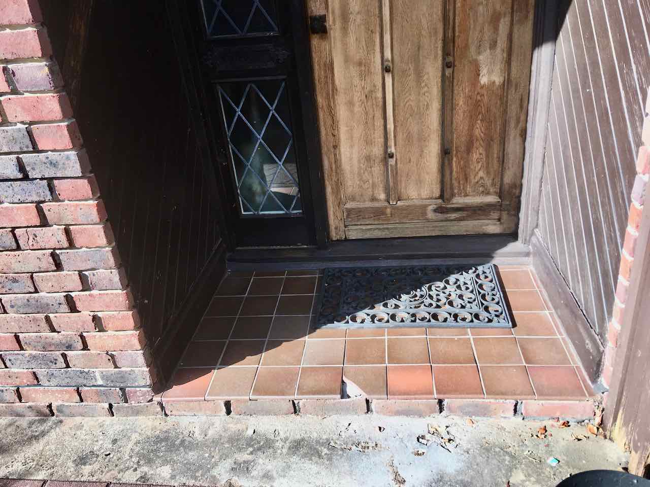

I'm renovating an exposed porch area
Just removed the old T&G which was all sealed and very heavy painted.
I plan to replace with two sheets of plywood and a framing effect
None of it is structural just cladding

The costs are getting quite high saving >50%
Porch is exposed and open to elements , so gets a lot of wind and salty rain, as we are 0.5km from the coast
We will be painting all the board with probably a cuprinol garden colours
Also i will seal all the joints with CT1
We are getting on a bit, and so looking for minimum ongoing maintenance

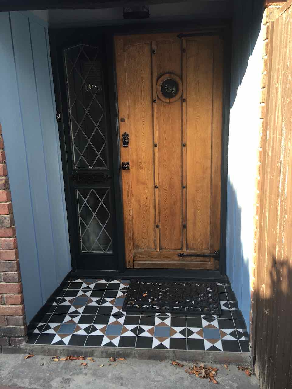

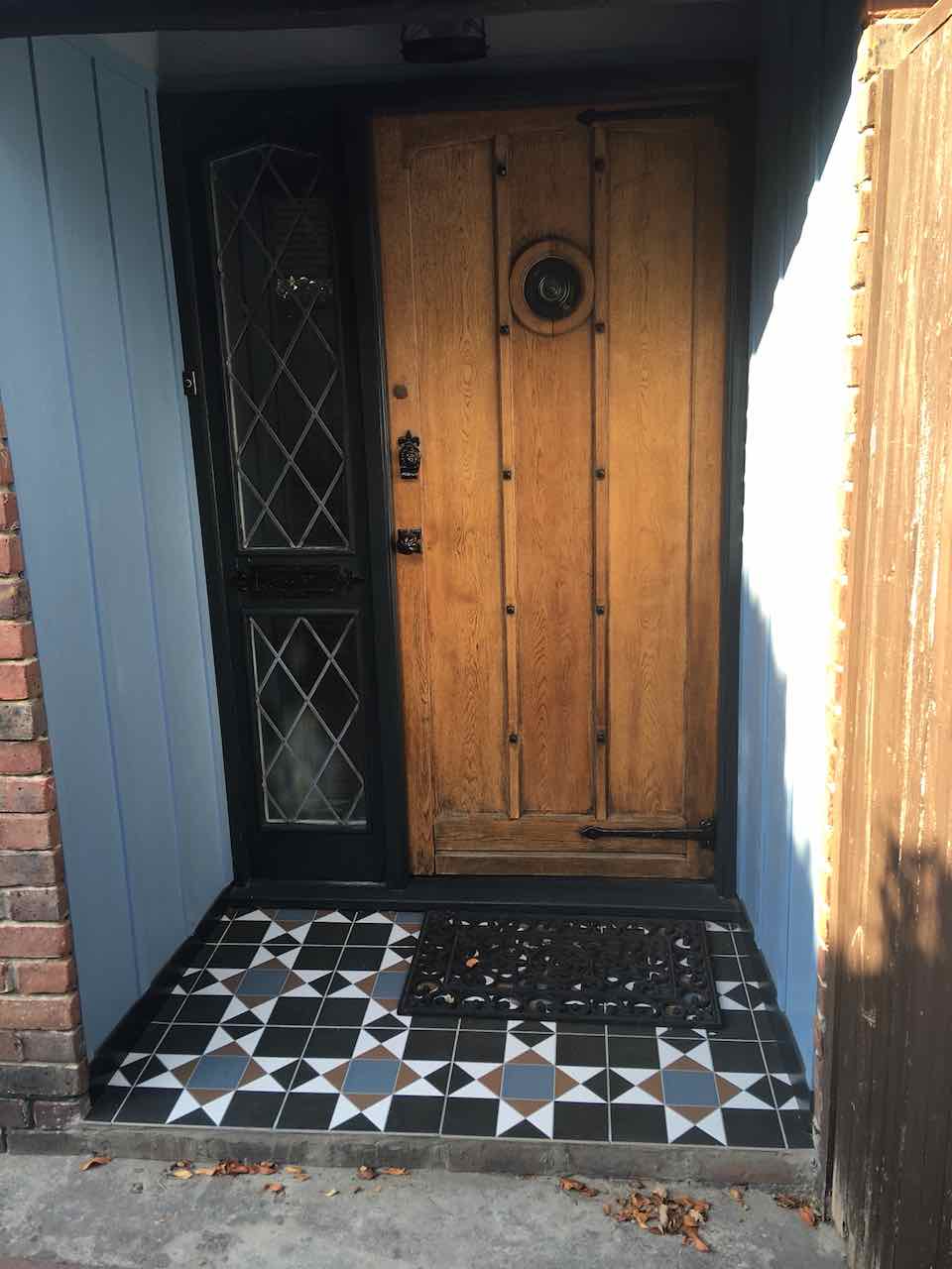

Just thought i should update, I went for MArine Ply in the end, had a few quotes for plastic cladding and prices ended up much to high.
I also had trouble finding WBP.
A few companies for the colour wife wanted would only provide a pallet > £1000
Thought I would add an image
Again thanks for all the help and advice
