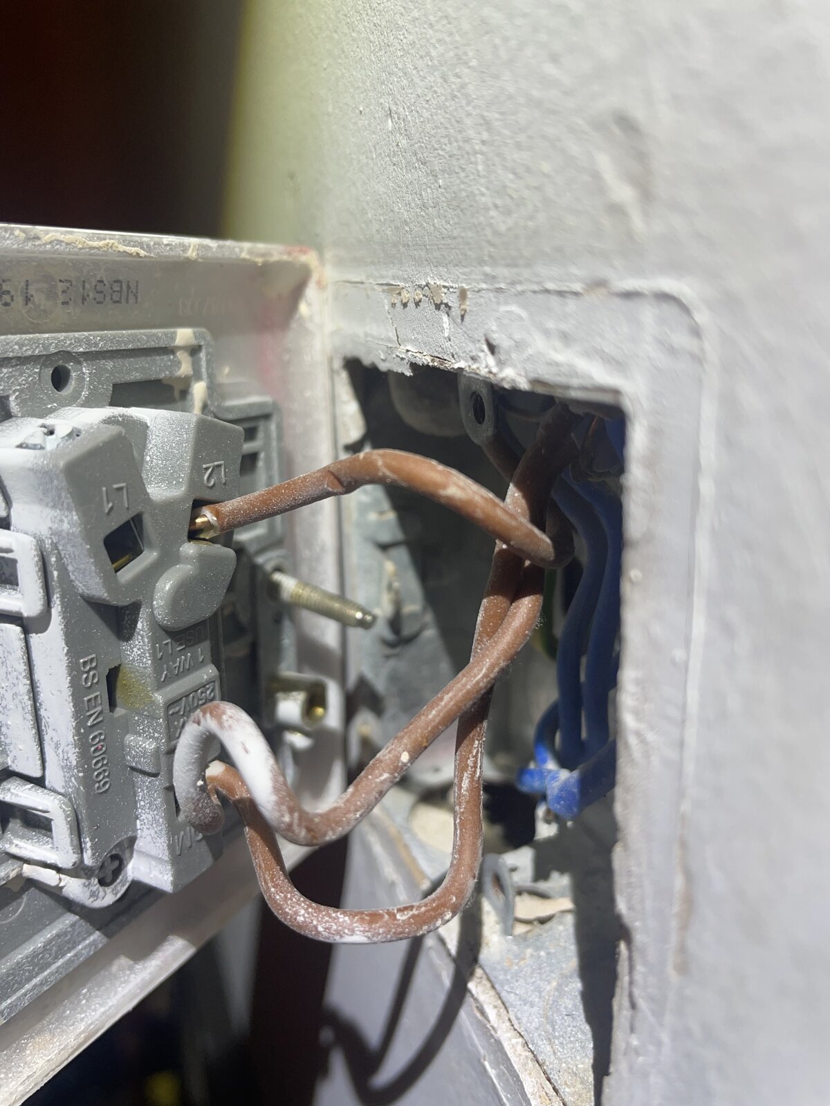

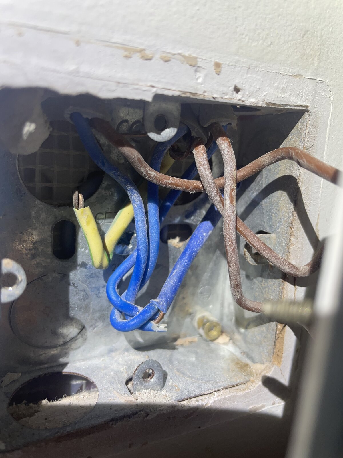

Do my metal faceplates need earthing?
28 Apr 2021
318
4
I’ve got metal faceplates on all my light switches and after taking a few off to decorate, it looks like none of them are earthed even though there is a place to attach a wire. There are some earth wires in the back boxes. Some back boxes are plastic, and some are metal. I don’t think the metal back boxes are earthed either.
Do all these back boxes and face plates need connecting to earth? Why would they not be earthed (by 2 different contractors)?
Yes all metal face plates need earthing, some say its earthed via the 3.5mm pin but to me that's lazy, take a fly lead (1mm or 1.5mm green and yellow) from the back box earth terminal to the face plate.
Looks like some of the blue insulation is missing and bare copper conductor exposed.
Yes they need to be earthed.
On a second look your screw is missing from the back box.
You can pinch one from a spare box also the neutral is badly connected (copper on show) that's a nuisance trip waiting to happen.
Its not acceptable to rely on plate screws to provide earth continuity to the metal front plate from an earthed backbox, Its often acceptable (although lazy) to rely on plate screws to provide earth to a recessed metal backbox from an earthed front plate
Yeah that's the one, either way I wouldn't do it for the sake of a bit of wire.
Is the back box even earthed though?
Are all your switches like this then?
You've just been unlucky is all I could say, 2 stupid electricians maybe.
Yes they are. Should i get an electrician to sort this out? With the bare wires twisted together too it seems like the whole thing is a dangerous mess, and I am new to this
I think the metal faceplates have plastic backs if that makes any difference
Yes the twisted neutrals need a suitable connector/wago fitting.
If theres an earth terminal it must need to be earthed regardless of the plastic backer.
