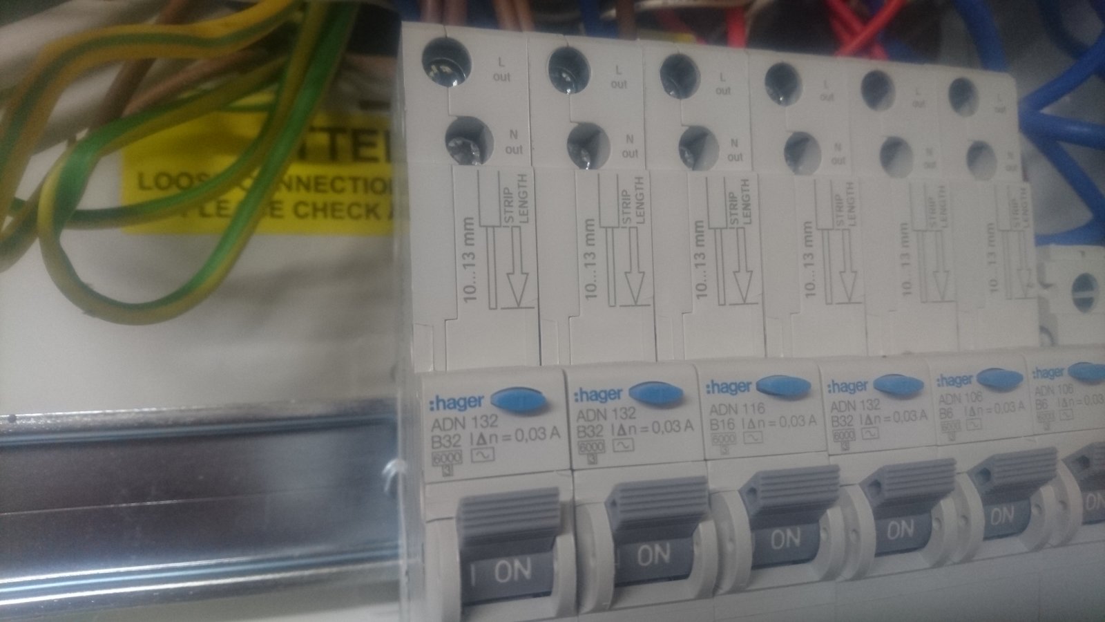

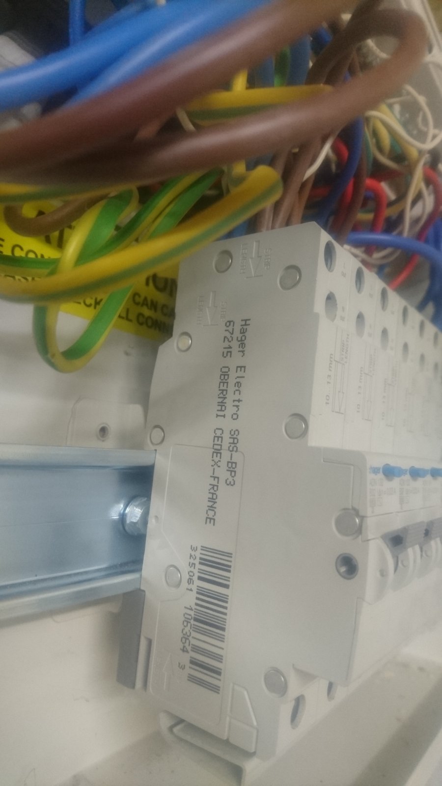

Pictures of the modules that are inside the current consumer unit.
The ADN Range is now obsolete, and I need two additional ones (One 6A and one 32A)
So my question is...
Will an ADAxxxU RCBO be OK to use in a consumer unit where ADNxxx were originally installed?
