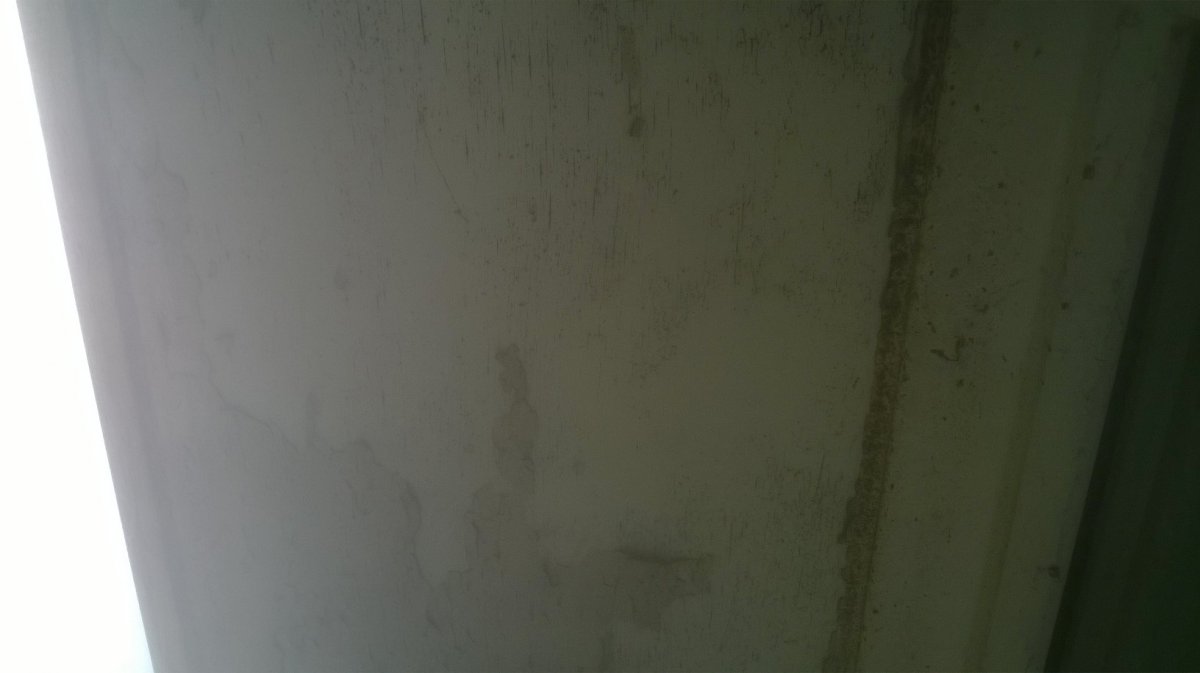

We've got quotes from a few firms for work on the roofline, including overcapping the soffits. No one but one guy two days ago thinks the soffits contain asbestos. My wife is convinced he is just after more money (it is a family firm, the son had previously looked at them not mentioning any asbestos, but for proper measuring up the dad came along, who is "100% sure" it is asbestos). All other firms thought the soffits are not asbestos (one bigger firm had concerns from the street but when looking closer up they thought it was fine).
I know it's difficult to tell from the picture I attach, but do you have any thoughts? There is a lot of flaky paint and a texture to the soffit boards which I thought might be wood grain, though that "dad" maintains it's asbestos). There is no obvious rot so maybe it's not wood, but I am surprised that everyone else would have thought it's asbestos free. When we bought the house a few month ago, the surveyor didn't mention any concerns either (but the survey was rather sloppy, to say the least....)
I believe the soffits were installed in 1981 when the house was extended.
And if the soffits had some asbestos, would that have implications for overcapping? Would it be dangerous to do so, or should they fix the UPVC in a different way?
Thanks a lot.

My house had asbestos cement sofits and drain pipes
I capped the low level sofits and a glazing company did the gutters/facial and soffits ( which were wood) with no bother. This was over 10 years ago.
I recently replaced some other drainpipes and took care to wrap in double layer builders polythene and the council tip took them by appointment.
Afaik so long as you don't smash it up, it is safe to remove but wear masks.
The rules may have changed but get a second opinion
I'd be wary 1981 build should be fibre/cement. Can't tell anything from the pic.
You can over clad them no problem.
The onus is on the firm doing the work to protect their empoyees, so they devise a safe way of working or of removal. But for you as the customer, you want all this quoted for at the start, as you don't want to award the job and they start on site and then say, oh its now going to cost you three times more.
Thanks all. As long as it is not a problem to overcap, i.e. it shouldn't cause too many fibres to be released, I am happy with it. That is all I wanted to hear!
