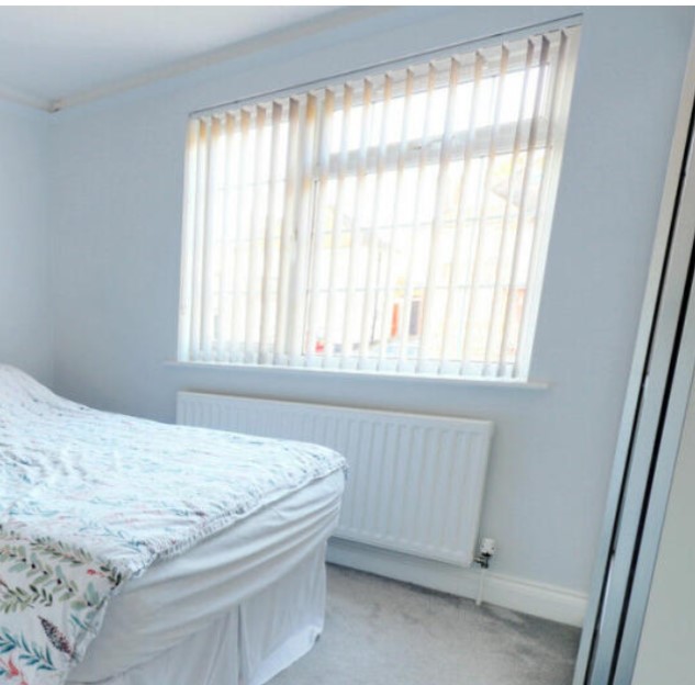

Do you think this wall has a cavity?
Has anyone ever built a solid wall that's 11.5" thick? Other than on a castle.
A castle wall, would be feet thick, at least. 11.5" thick could suggest lots of things, other than a cavity, and without more photos, I would not be ordering CWI based on a limited, quick photo, and a single measurement.
Tap your knuckles on the internal wall - on the interior, not the window reveal. Solid = cavity, hollow = something else, possibly solid with drylining or insulation.
I haven't made a mistake... solid = hollow sounding, cavity = solid sounding!
A photo from outdoors, showing the general construction, plus more indoors, similar to the one you posted, giving a wider view of the area.

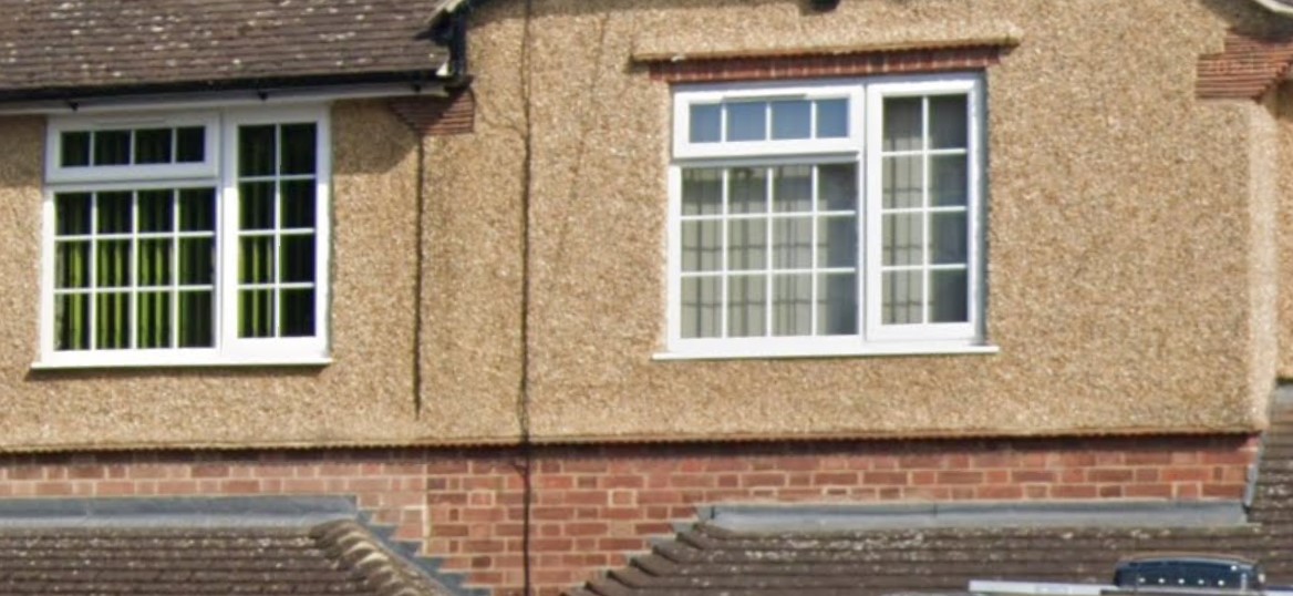

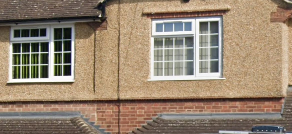

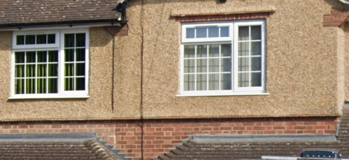

Below is the picture of the front of the house and our neighbours (directly attached) house is similar, however, house next door is different with a smooth render.

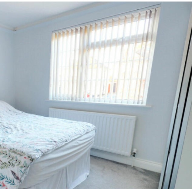

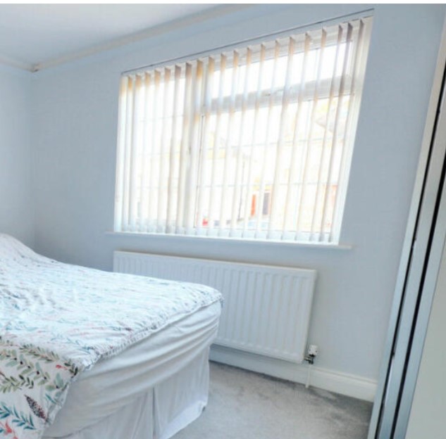

Also attached picture of the room from inside.
Agreed, against my initial guess, it appears to be a solid (not-cavity) wall, presumably with a very thick render/pebbledash on the upstairs.

The brick pattern, in that bottom photo, appears to suggest there is no cavity.
