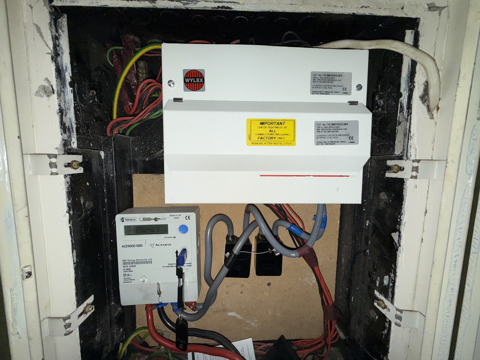

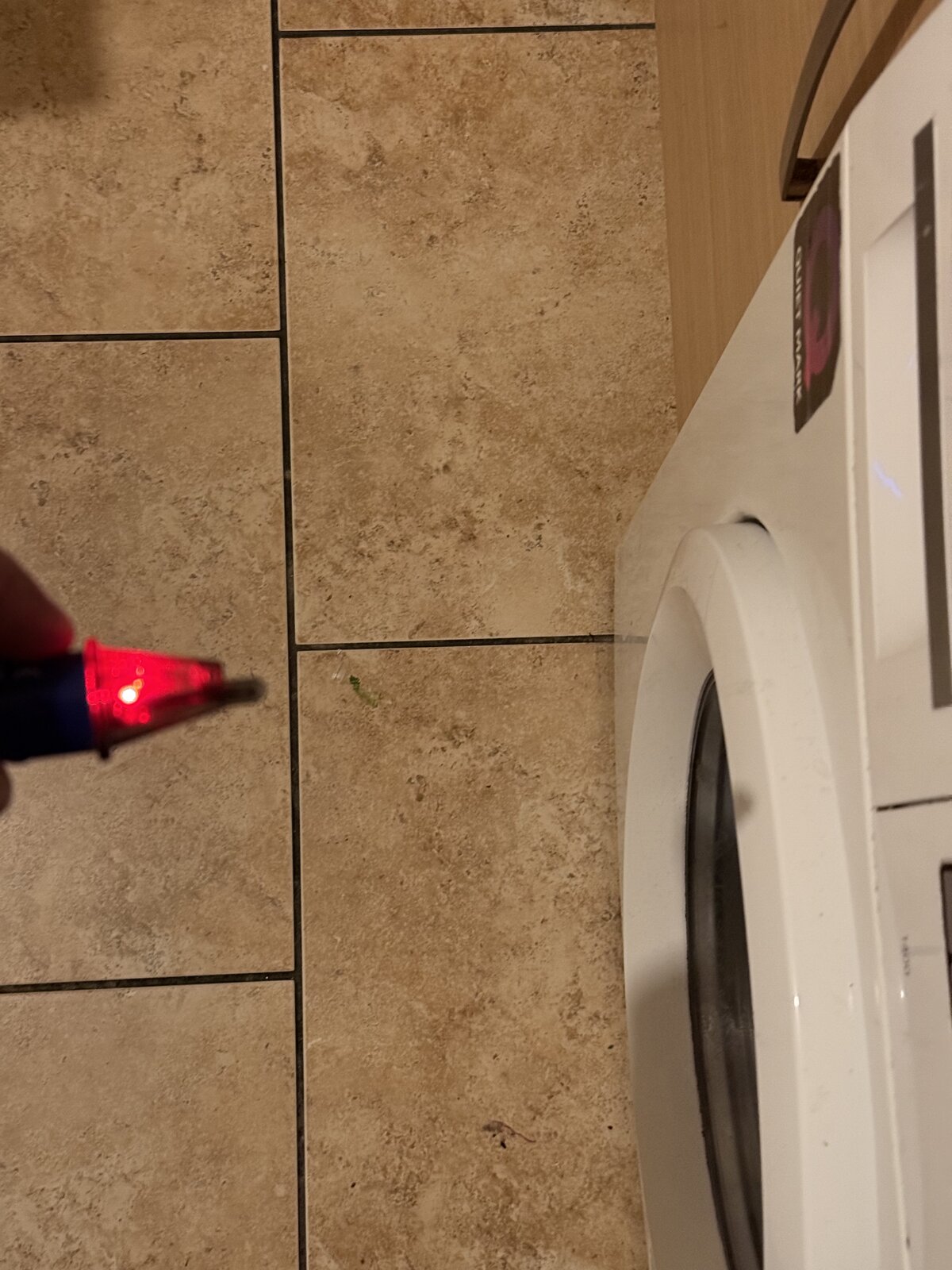

Ok so my daughter lives in a flat in London , she told me some of her friends have been getting ‘minor shocks’ from the washing machine and microwave. I told her not to use the them and I’d take a look ( thinking it was a few volts floating and a bad earth on a spur).
I turned up with a voltage detector pen and it goes off within a foot of the washing machine and the microwave casing. Checked the consumer unit and there’s just red and blacks out of their sleeve and not an earth wire in sight. The rcd does throw when pressed but with no fault return path at all this can’t be safe at all .
I know there are countries in Europe that don’t earth and just rely on rcds but is there a case in the uk where this is legal ? The whole thing looks like something that I would die if I had had any part of. There’s an inspection sticker in the CU from 21 I just can’t take it seriously

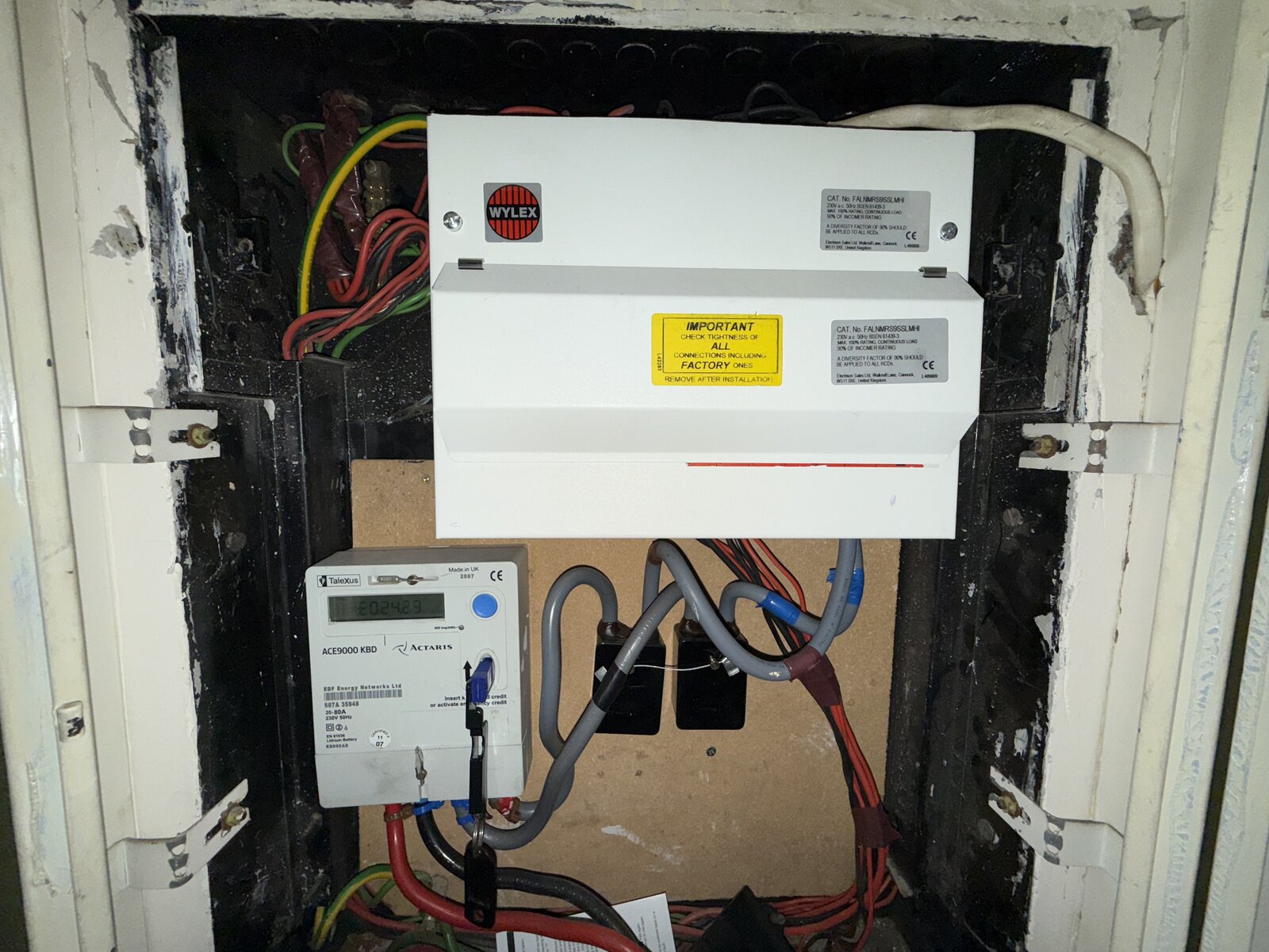

Here’s a picture of the box ( I can see live conductor showing thru the brown e tape and the tenants are in and I it of there constantly to top up the meter
Any words of advice on the legality of this ?

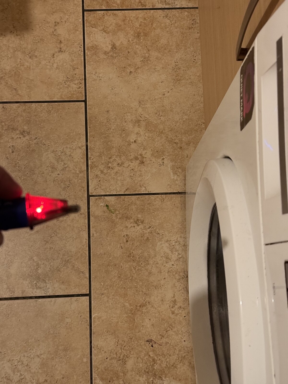

And there’s a picture of how far away the pen squawks from the chassis of the washing machine. I didn’t bring a voltage detector pen meter or any other test stuff so I don’t know any more

The first picture looks like a mess.
Could you send a picture of the incoming main fuse?

I can't see the DNO head, so no idea where earth wires go.

If I stand on a floor at 200 volts and use a non-contact voltage detector, then anything earthed would cause it to light. My step one would be plugged in my tester ELI-on meter.jpg and press the button, the problem is these testers even the cheapest cost around £75. The non-contact voltage tester will show there is a fault. But no more, it will not show where the fault is. So before having my own loop tester, the way forward is to find someone who has one, likely means employing a scheme member electrician to test the house.
With what you have said, it could be under floor heating at fault, and clearly the fault needs correcting fast.
Those non contact voltage indicators are not an accurate way of detecting much. To put another way, I had one light up on a wooden door frame, which I took back. The other decent ones I have have also lit up boiler casings, but they’re not “live”. Needless to say, the appliances need checking as does the main earth terminal - which I think is the top left of the photo, behind the dodgy taped up cables.

Very shiny consumer unit, looks brand new. strange that a professional would forget to remove the check tightness warning sticker, wonder if they bothered?

Thanks everyone. It’s a rental - it looks so wrong I thought there must be some version of code that I didn’t know about that exempts old properties from needing earths??? The washing machine is in a spur that goes back to a part of the ring at a double socket. I only came equipped with a screwdriver and the detector thinking there would be an earth off or some bit of crap floating loose in the socket… Whoever put the spur in wired it correctly in that it’s connected to the earth of the double socket that it splits off. … Only thing is there’s no earth coming from either direction on the ring. Nothing at all. Which I guess is why the detector lights up like a Christmas tree when I get within a foot of any part of it. The whole thing is floating ! Sorry about the pictures I’ll try and get better ones.

I’m very competent at house electrics as I work as a touring sound engineer ( deal with all sorts of crazy situations with 3ph , generator and delta power, ). I just wanted to check I wasn’t talking **** before I go in on the landlord’s sparky. The washing machine and microwave are run off a double socket with a spur off it. No incoming earth from either side of the ring. Metal back box , unearthed , and the girls that live there including my daughter complained of ‘funny tingling’ when they cleaned the sideboard and touched the microwave and washing machine. I’m guessing one of them was leaky and had no drain path.
Either way I’ve told them not to use anything from either of those sockets.

Crazy …. Looks like it was put in by a complete chancer tbh. I never trust a CU has no grommets at all in any of the knock outs … this thing has none: a 10mm earth going in but only one earth coming out. All the t&e cables are stripped of the sheathing back to the red and black. ( outside the CU ).
